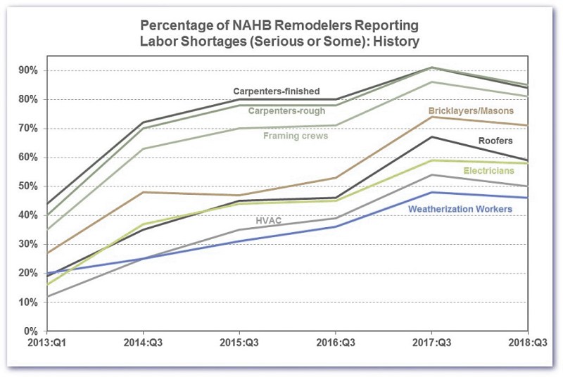

The NAHB/Wells-Fargo Housing Index surveyed builders, reporting that 83% of builders are hindered by shortages of framing crews and rough carpenters, 78% by a lack of finish carpenters, and 70% to 73% by shortages of bricklayers, masons, and concrete workers. Nearly every trade is listed in the report—including all mechanical trades, interior finishing trades, even landscapers, excavators, and weatherization workers—with more than half of builders feeling hindered by not being able to fill these key positions.

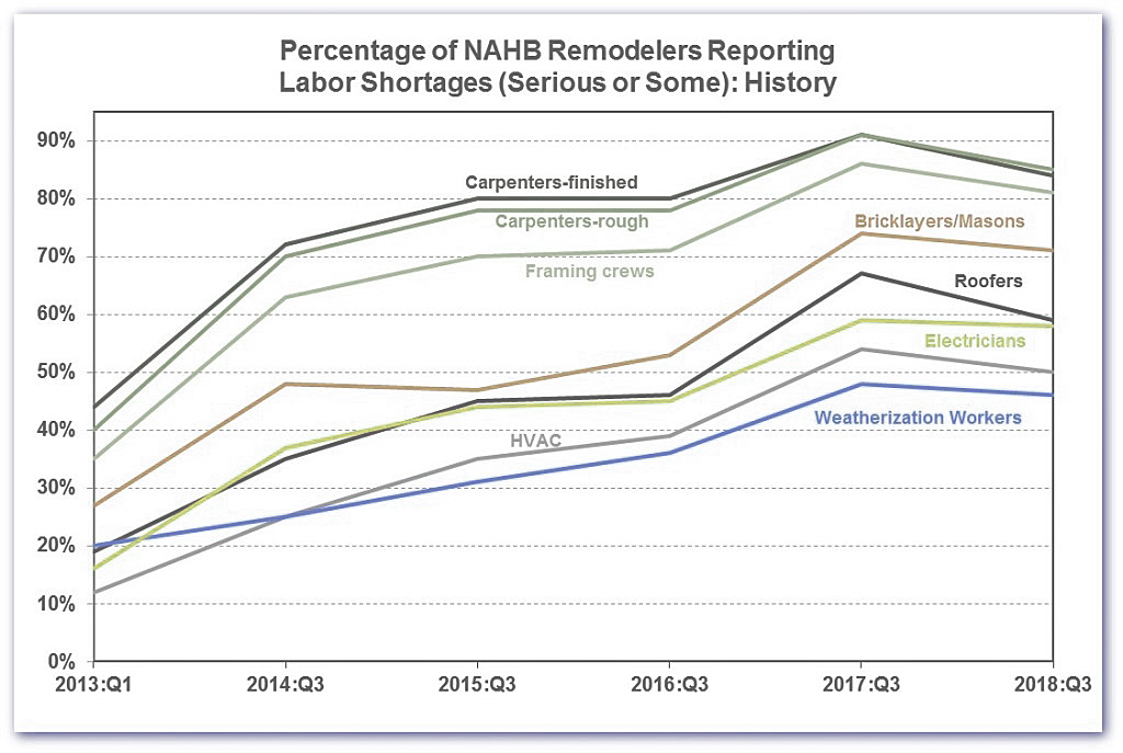

NAHB Remodeling Market Index
Similar numbers are posted in the remodeling sector: The NAHB Remodeling Market Index reported that roughly 85% of remodelers reported shortages of workers available to perform finished or rough carpentry, and nearly half (48%) classified the shortage of finish carpenters as “serious.”

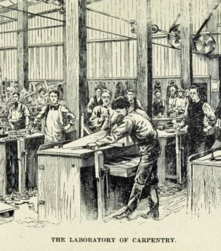

The history of public education for the U.S. building trades traces its roots to a few key sources that I’ll touch on here. However much we have progressed as an industry, our legacy continues to define who we are, and not only has a bearing on how we got here, but also suggests steps in a path forward.
As with much of U.S. history, we have a historical ethos established in pre-Revolutionary America that has had a powerful, lingering effect on trade knowledge. History also delivered the Smith-Hughes Act—a Federal law passed in 1917 that forged our national outlook but doomed the performance of vocational education in America. Both deserve attention.
The ethos of home building is epitomized by the Carpenters’ Company, the oldest trade guild in the U.S.—founded circa 1724 with ties to similar European guilds. Mark Luzio presented a lucid description of the business climate for general contractors in the early period in America (see “The Carpenters’ Company,” Jan/17).

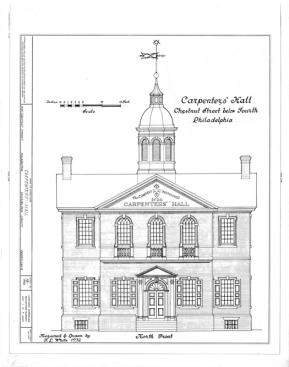

Designed by Robert Smith, Carpenters' Hall (shown above) was originally built as a meeting place for carpenters, and served as the site of the first Continental Congress, and the First and Second Banks of the United States. The members of the Carpenters' Company who erected it also designed and built Independence Hall. Both buildings provide evidence for the preeminent status of carpenters in the social fabric of our fledgling nation—a status with symbolic value for today's carpenters to revive and celebrate.  (Elevation drawing: Historic American Buildings Survey)

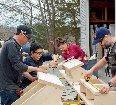

Carpenter Aaron Butt (@aaronthomasaquinas) leads a stair-building workshop at Grand Banks Building Products in Gloucester, Mass.—one example of the new Chautauqua that, with the help of social media, is attracting young carpenters. (Photo: Monica Banks)
