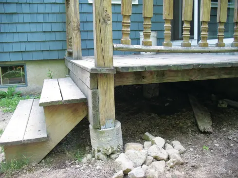

On my last two deck rebuilds, the concrete supporting the existing framing was inadequate, and the decks had suffered for it. The footings were too small and too shallow and the piers were too misshapen, which led to settling and frost heaving that weakened the ledger connections (a safety issue) and to sagging beams that left the deck surfaces wavy. Unfortunately, this situation isn't unusual, as many deck builders rely on rules-of-thumb to size their footings and piers, then hand off the digging, forming, and pouring tasks to the least skilled laborer on the crew. But a solid foundation is critical for the stability and long-term durability of a deck, so I take the time to make sure my footings and piers are sized and installed properly.
Poured concrete piers aren't the only foundation option for decks, of course. Other choices include pinned piers, helical piles, or even precast concrete pier blocks with built-in brackets, for those lucky enough to live in areas without frost (see "Footings From New England to California," Professional Deck Builder, May/June 2007). And even in cold climates like mine, many builders just use PT posts set on (or embedded in) concrete footings at the bottom of the hole. But to prevent decay and problems with anchoring the post to the footing, I prefer to support a deck with continuous columns of concrete that extend from the bottom of the hole to above grade.

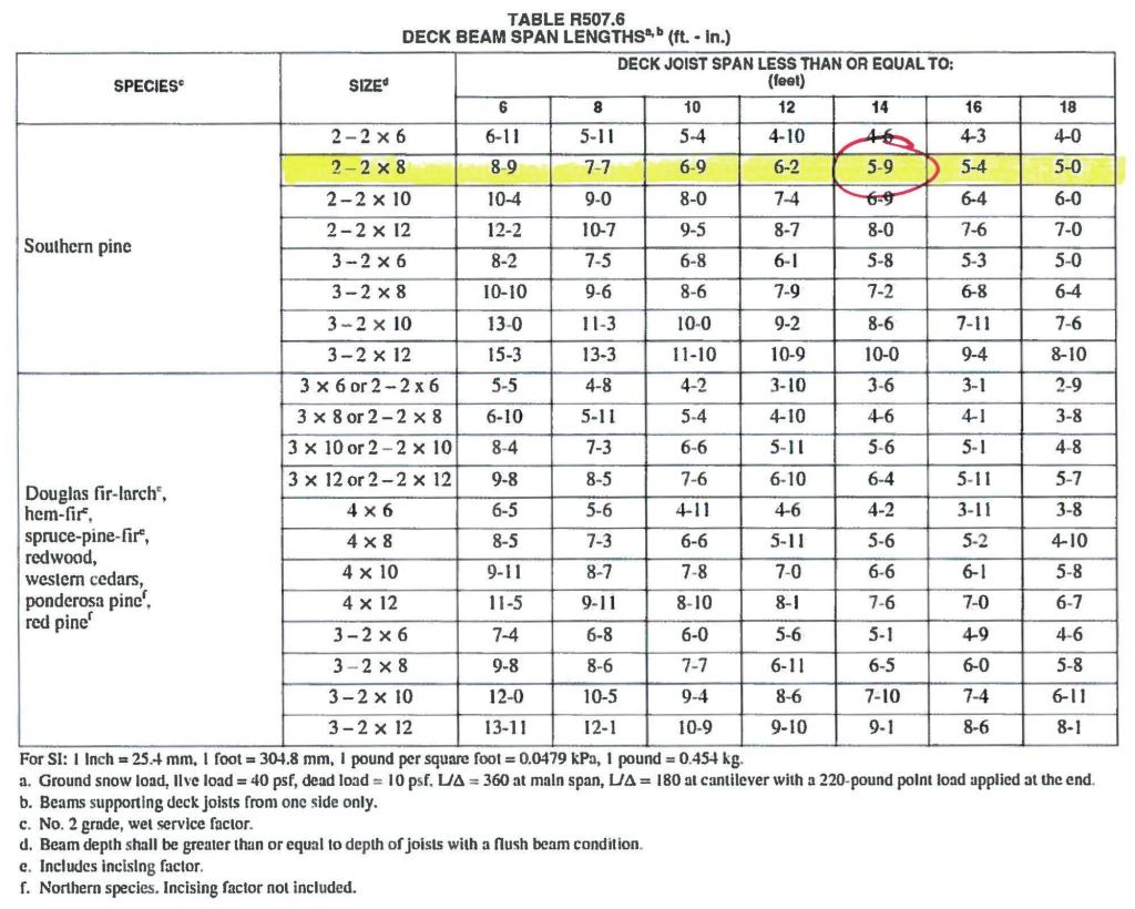

Footing locations are determined by the size of the deck beam and its permitted span. As shown above, the maximum span for a double 2x8 beam supporting 14-foot joists is 5 feet 9 inches.
International Code Council Footing locations are determined by the size of the deck beam and its permitted span. As shown above, the maximum span for a double 2x8 beam supporting 14-foot joists is 5 feet 9 inches.
Guess, Calculate, or Use a Table?
The number of footings needed to support a deck beam is dictated by the beam's size. Unless the deck requires engineering, I refer to a beam span table as I design the framing. There's one in DCA6, the American Wood Council's Wood Deck Construction Guide (awc.org), though I've found that the 2015 IRC's new span table is a bit more generous. Once I've determined exactly how many footings I'll need, I can determine how large each one needs to be.

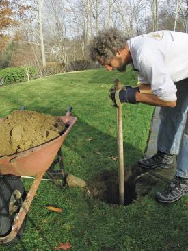

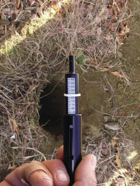

I actually measure soil density using a simple penetrometer, which is much more accurate than basing the soil's bearing capacity on its type. Often I find that the soil is stronger than the soil type would indicate, and that footing sizes can be reduced significantly. More importantly, I've found in some cases that the soil's bearing capacity was less than what would be expected based on local soil maps or soil types.
There are a variety of penetrometers on the market, from simple pocket versions (like the one I use) that cost as little as $60 to engineering-grade models—called cone penetrometers—with digital readouts, which can cost more than $1,500. To take a reading I dig a footing hole down to virgin soil below frost level, carefully removing loose soil from the bottom of the hole. Without tamping or otherwise disturbing the soil, I press the penetrometer into the earth in five to 10 spots, trying to avoid stones. I record each reading, reject the anomalous ones, and average the similar ones together. Because the scale on the model I have reads in tons, a quick conversion to pounds is needed.
Always check with your local building official before using a penetrometer. He may or may not take your word for the readings you take. I've been lucky that most of the officials in communities where I work know my work and trust my readings.
