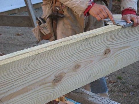

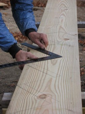

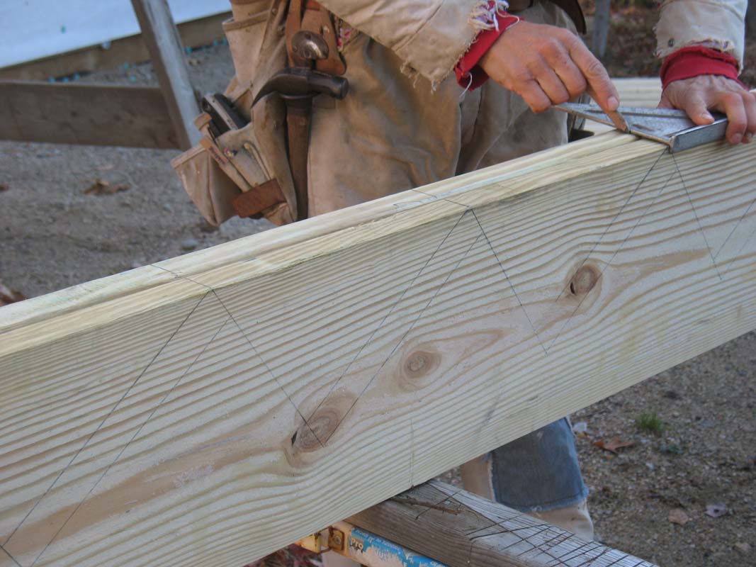

I don’t see many deck stairways built with bracketed stringers, but they’re a good alternative to notched stairs in certain situations. The design is similar to housed stringers–where dadoes are routed into the framing to provide shoulders for the treads and riser boards to rest in–but is simpler to build. And bracketed stairs are stronger than stairs with notched stringers, because the 2×12 stringers aren’t weakened by notches that effectively leave only 2x6s to support the loads on the stairs.
I like to use solid stringers and brackets whenever a design calls for wide stairs or long spans. Notched stair stringers have a limited unsupported run of 6 feet, according to the AWC’s Prescriptive Residential Wood Deck Construction Guide, or DCA6-12. Compare that with solid stringers, which can span more than twice that distance–13 feet 3 inches–without intermediate supports. And while DCA6 limits tread width to 36 inches, that can be increased substantially by installing structural risers. Adding those also satisfies the building code requirement to block openings that are greater than 4 inches–including underneath the treads–when the stair is more than 30 inches above grade.

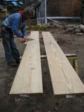

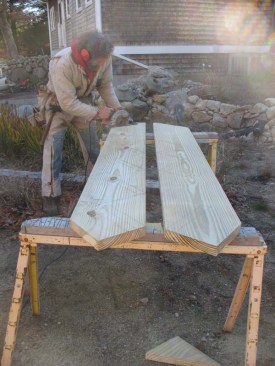

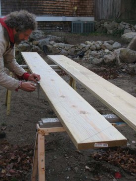

On this project, the stairs access a landing for a storage building, so I built them using ordinary pressure-treated lumber rated for ground contact (AWPA UC4A). For a more finished look, the stringers, treads, and risers could be made from any finish-grade naturally decay-resistant lumber, such as cedar or a suitable tropical hardwood. The treads are 2x12s that I ripped down to 10 1/4 inches. Because the risers are structural to help support the 4-foot span of the treads, I used 2x10s for them.

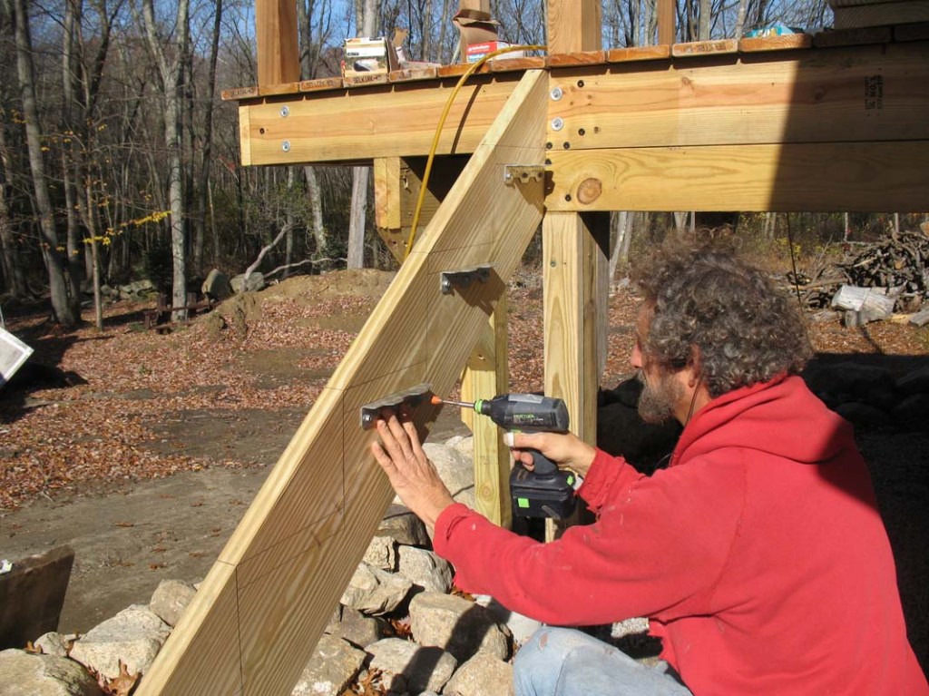

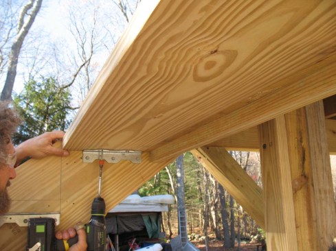

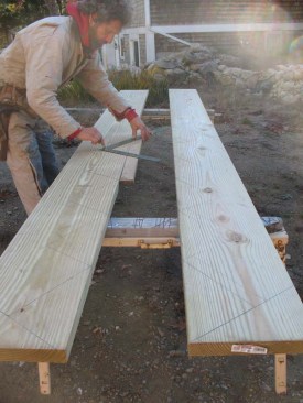

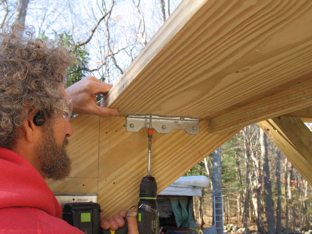

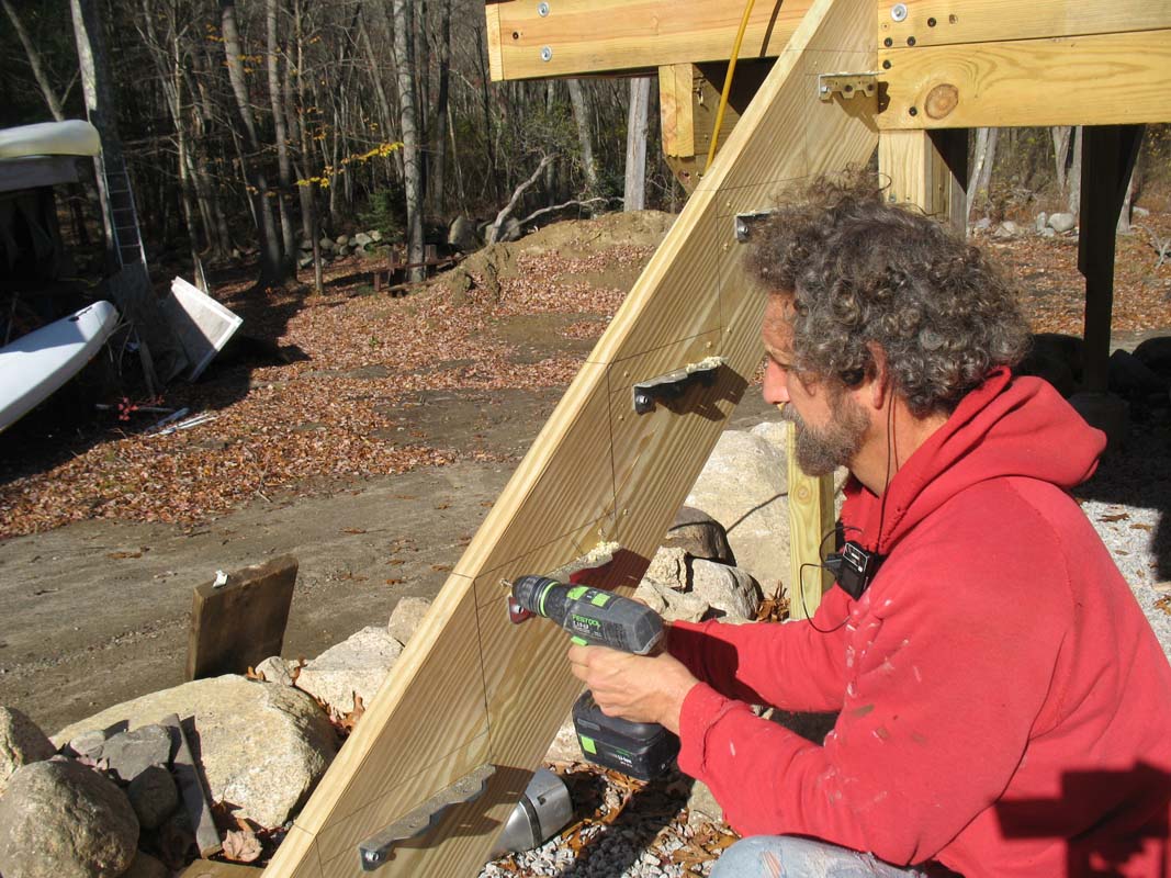

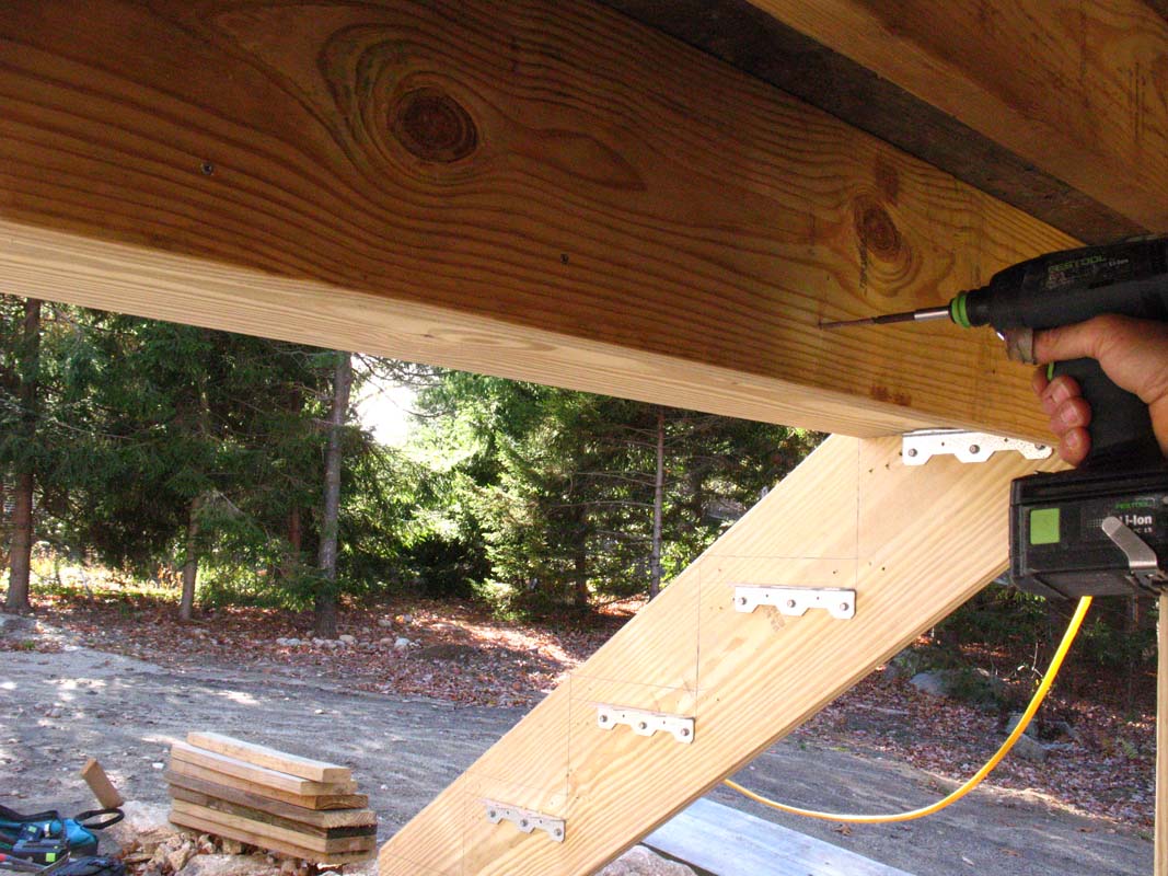

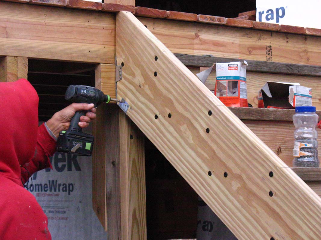

DCA6 provides a tread-support detail that features 2×4 PT cleats fastened to the solid stringers, but on this project I used stair angles. While stair angles look like ordinary angle brackets, they are made of much- thicker-gauge steel and are stronger. Stair angles are made by both Simpson Strong-Tie (TA9Z & TA10Z) and MiTek/USP (SCA9-TZ & SCA10-TZ) and are weight-rated depending on how many structural screws or lag screws are used to mount them to the stringers.
Another option is to use EZ Stairs metal support brackets, which have a right-angle design that supports both the treads and the risers. According to the manufacturer, its system can be used with a single pair of stringers to build exterior deck stairs that are as wide as 7 feet.

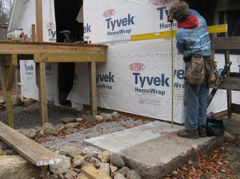

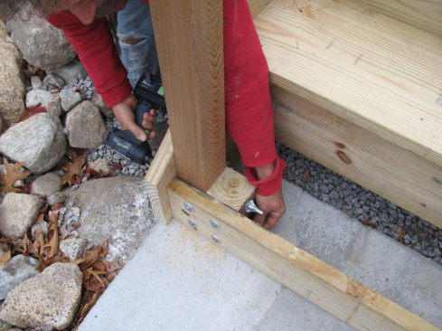

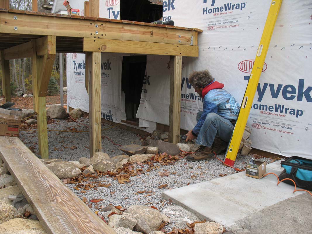

To avoid overloading an end joist or a rim joist, I prefer to support the head of the stair independently of the deck frame. On this project, I screwed a 2×6 to the 4×4 posts; the 2×6 is also supported by a pair of 2×4 jacks that are fastened to the posts and that bear on the footings that support the posts. The 2×6 is in plane with and provides additional support to the end joist of the deck (see slide show).

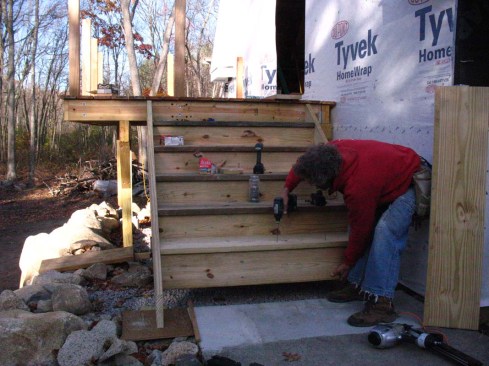

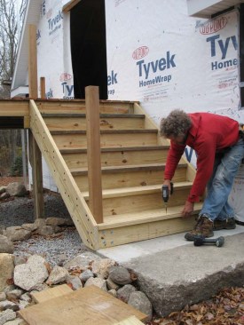

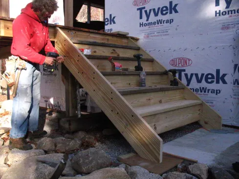

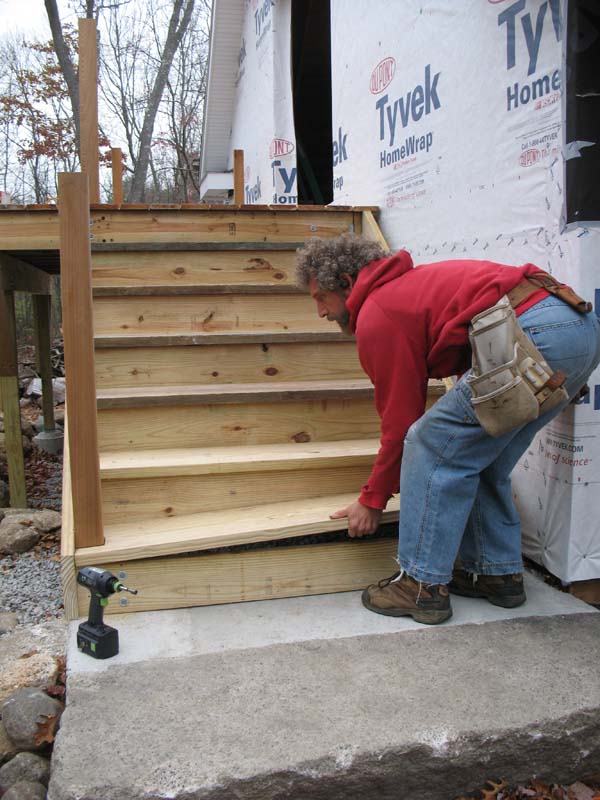

Even though the tread brackets are screwed to the inside face of the stringers, I also like to drive 5-inch structural screws through the outside face of the stringers and into the treads and risers to tighten up the stair assembly. Here, the stairs run next to a wall, so I assembled the staircase about a foot away from its final position, then slid it into place after it was completed.
This technique leaves a lot of screw heads exposed, which was not a problem on a set of utility stairs like this. I used black HeadLOK flat head structural screws, which probably stand out more than would Simpson Strong-Tie’s SDWS screws, which have tan heads. Another option might be to trim the stringers with separate skirtboards that conceal the fasteners (though this would present other trimming challenges).
