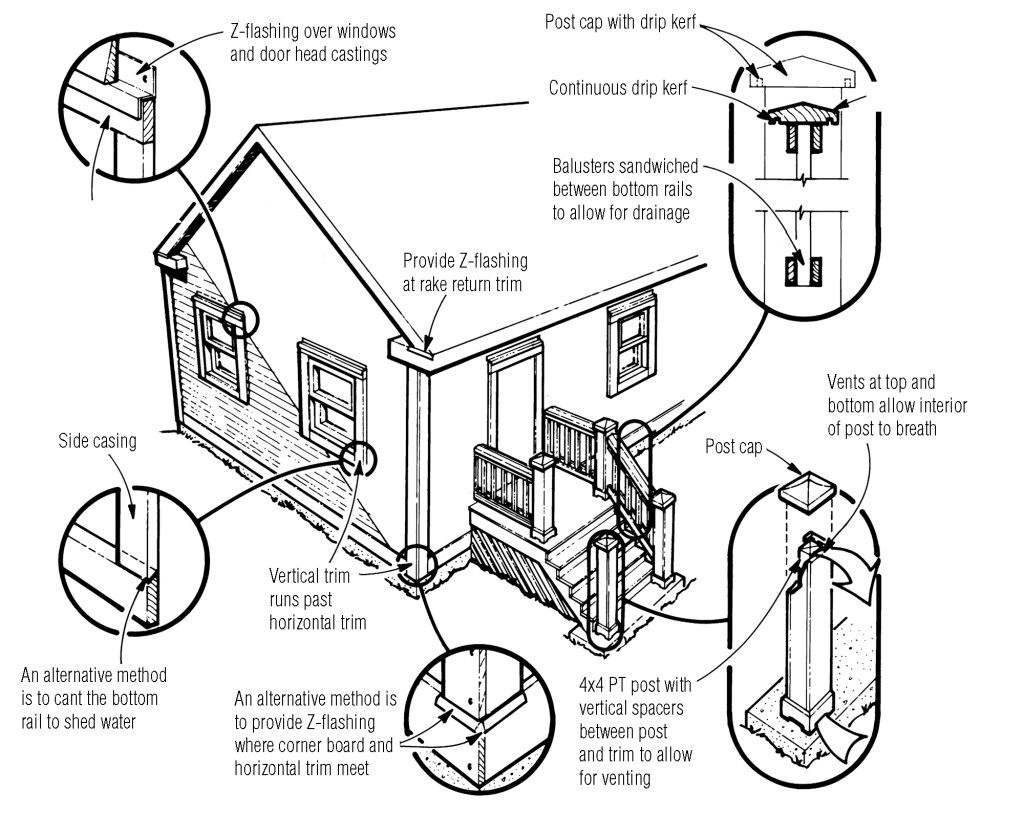

Design Principles for Durable Exterior Trim
Exterior joints should be designed to shed water (see Durable Exterior Trim, below). Trapped water will cause excessive wood movement and splitting, and eventually will invite rot, bugs, and fungal infestations.

Seal and Flash Edges
To keep joints dry, first make them as tight as possible:
  • Make sure that adjoining surfaces meet uniformly at all points; no amount of glue or fasteners can compensate for a sloppy joint.
  • Seal all joints that are likely to absorb water. Horizontal joints are the most vulnerable. Before the pieces are assembled, apply a coat of latex paint or or clear exterior finish that is compatible with final finish.
Second, use metal flashing to help water find a path away from horizontal trim pieces.
Click here for larger version
Canted Surfaces and Drip-Edges
Railings, thresholds, and other flat surfaces can be made to shed water by bowing or sloping top surfaces, and by sawing or routing a drip groove along their undersides. Around posts and columns, build ventilation channels that will allow built-up pieces to dry.
