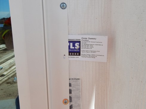

Here’s why I prefer method “B.” Sealant under the nailing flange is a critical detail for keeping water out. But with the “A” methods, this detail is covered up when the flange is flashed, and so is difficult to inspect.
The “B” methods allow for a more complete inspection by superintendents, who look for “squeeze-out” to verify that the sealant has been correctly applied.
I have worked on countless projects where window-installation failures were caused by installers doing a poor job applying sealant under the nailing flanges. In a way, it’s understandable why this happens so frequently: Installers want to work as fast as they can in order to finish as early as possible and to make as much money as possible, especially when they are hired for piecework.

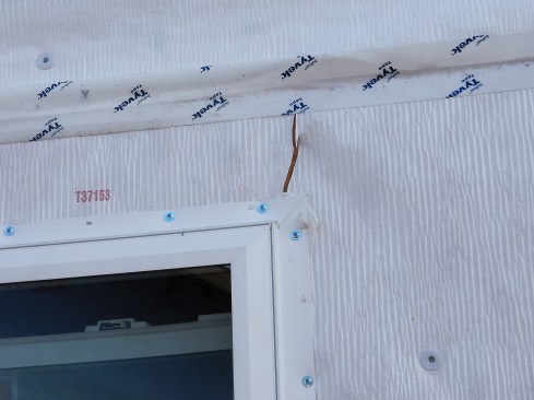

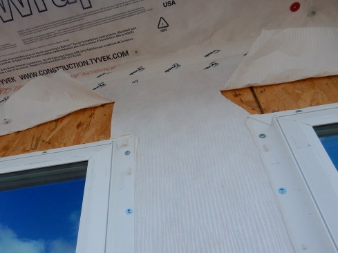

This photo shows several problems, identified with arrows: The top arrow shows where a nail is used to hold the head flap up, creating two unnecessary holes in the WRB. The head flap should be temporarily held in place with tape. The middle arrow shows sealant squeeze-out left to harden like a worm. Any SAF applied over this will not perform well. The lowest arrow shows where a cap fastener is placed too close to the nail fin. As a rule of thumb, fasteners should be no closer than “three fingers” from the rough opening; Tyvek says 6 inches.

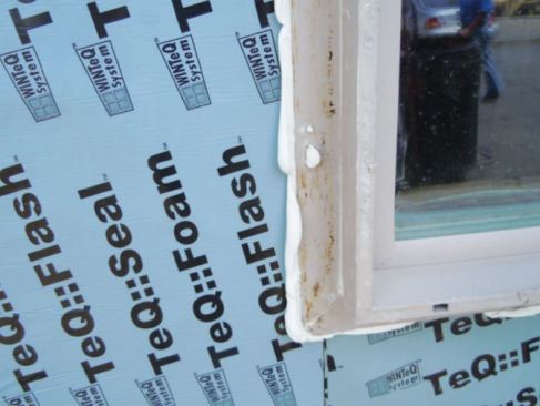

Not enough caulk. Here, there is no sealant squeeze-out at the flange edge or through the pre-punched holes. Also, window nailing flanges are typically not straight and flush; they are dimpled everywhere there’s a fastener. For wavy nailing flanges, sealant is critical. Butter your sealant excess squeeze-out over the fasteners to reduce the dimpling effect. Fasteners should be placed 8 to 12 inches on-center. Use exterior-grade, self-tapping pancake screws to help reduce the problem. I believe deck screws would work just fine as long as they are drilled through the vinyl avoiding the pre-punched nail holes.

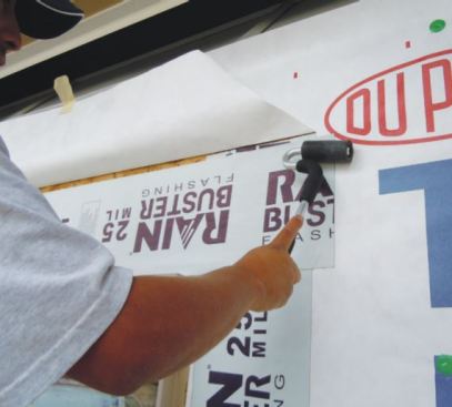

The flexible flashing shown here was not properly J-rolled and didn’t adhere to the drainable housewrap. It’s doubly important to J-roll SAF to drainable WRBs due to their wrinkled (or dimpled) surface. Also, if using a flexible flashing, ensure the product is correctly applied without creating wrinkles, and without overstretching the material. Ensure the inside corners are tight to the RO and, if need be, apply staples at the outer radius edge to avoid withdrawal of the material.

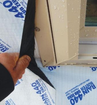

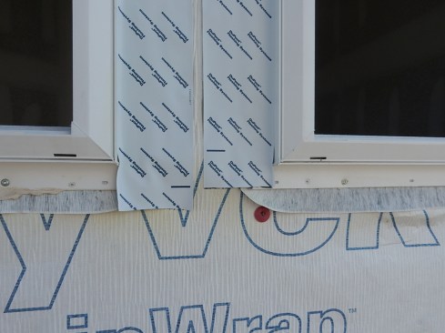

In addition to the side flashing running too short, the cap fastener is too close to the opening. If the side flashing had been extended downward to cover the flexible flashing, it would have at least partially covered the cap fastener. When water gets under the SAF for reasons previously discussed, it will use the fastener penetration to get in the wall.

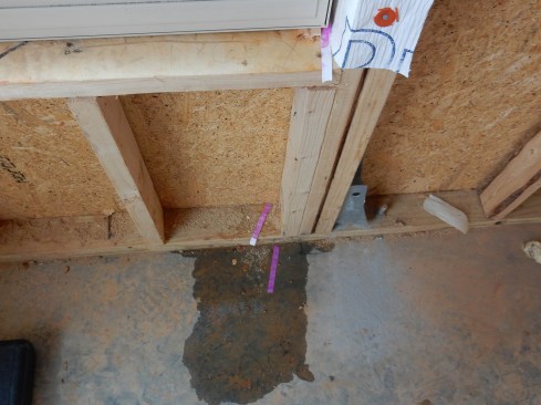

This photo is the interior view of figure 1. When there are adhesion problems after the nailing flange has been covered with the SAF, there is a strong likelihood that water will migrate to the cracks and holes, and then enter the building. I’ve seen this frequently when performing water tests. We regularly water-test windows and wall systems using ASTM E 1105 as our guidelines. We also use AAMA 502 and AAMA 511.

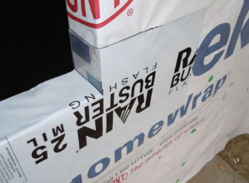

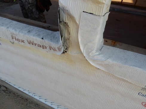

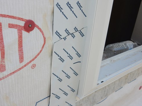

I commonly see WRB head laps sliced at different angles and lengths. Head laps should be cut at 45 degrees and to the width of the head and side flashing—no more, no less. Take the time to properly measure, mark, and cut the WRB.
In this case, the GC didn’t properly train the workers who installed the windows. The installer cut a head lap … well, you can figure out the rest. Builders need to adopt a method for installing windows and doors and own it. Taking ownership means everyone involved in the process understands every step.

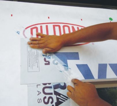

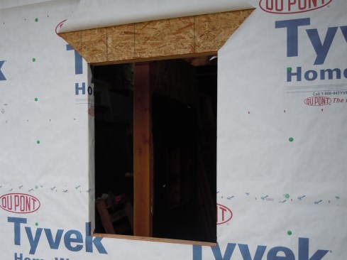

Step 1. Cutting the Housewrap/WRB. Properly measure, mark, and cut the housewrap at each rough opening. I recommend using an “I-cut” and turning the flaps into the opening. I believe it’s a more foolproof method. It’s too easy for installers—who are typically in a rush—to overcut the housewrap when cutting the sides flush to the opening. Cut a flap in the housewrap at the head at a 45-degree angle and to the width of the flashing, temporarily hold it up with tape.

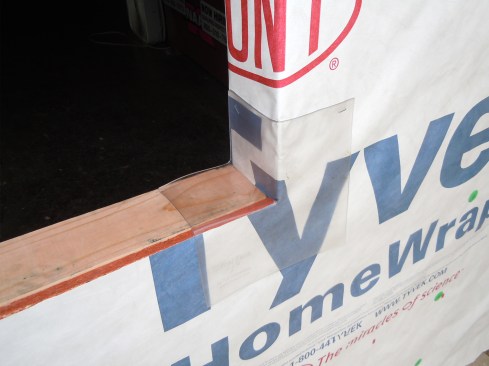

Step 2. Install Plastic Corners at Sill. Staple the flashing corners in place at both sides of sill. The rigid-plastic corners help seal the sill’s three-directional corner from pinhole openings in the membrane flashing, as well as providing protection if the window is roughly slammed into to place. It’s worth noting, I typically set the flashing corners in sealant, especially if a drainable housewrap is installed. Also, here, the housewrap has been cut along the RO’s sill. I prefer wrapping the housewrap into the opening, holding it taut with a couple of staples.

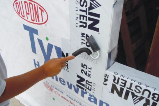

Step 3:  Install pan flashing (above) followed by the side flashing (above right), using 9-inch SAF as a minimum. Roll the material flat with a J-roller, being careful not to create wrinkles. I don’t often see installers use a J-roller, but this tool helps improve adhesion of SAF, even in cold and wet conditions.

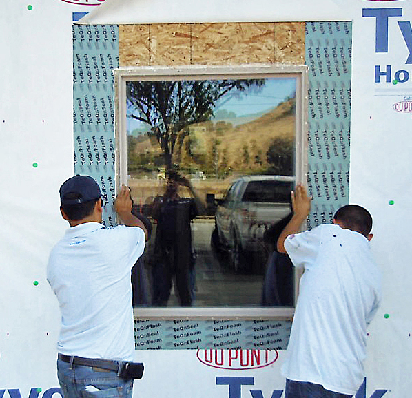

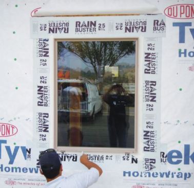

Step 5:  Apply a plumb, 3/8- to 1/2-inch bead of sealant along the edges of the window opening, then install the window level, square, and plumb. Ensure that squeeze-out exists everywhere sealant is used. Sealant is typically not recommended along the bottom, though some do apply it there, leaving gaps at the corners so any water that gets in can drain out. Either strategy is fine if it is correctly implemented.

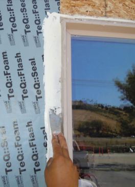

Step 6: Butter the squeeze-out flat, being sure to cover pre-punched holes and cracks in the nailing flange. If severe damage to the window is discovered, now is the time to alert field managers so they can process a replacement.
