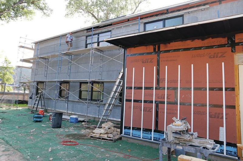

Installing the siding over a drainage mat will provide a channel that allows water to drain down and out.
The key elements in rain control are a drainage plane, a drainage space under the cladding, flashings that integrate with the drainage plane, and weep holes to allow water to escape. These principles can be applied with any cladding system and with many different drainage plane and flashing materials.
Rain screens are especially important on highly insulated walls, where the drying potential of the cladding is greatly reduced.
An alternative rainscreen can be provided with a self-draining, three-dimensional building wrap. These products include ridges that hold the siding a few millimeters away from the sheathing. They’re not as effective as a true rainscreen but provide enough of a gap to let water drain.

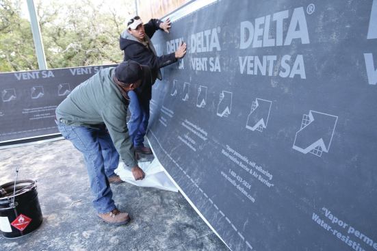

  • Fully adhered, peel-and-stick membranes resist wind damage and can serve as an air barrier, as well as a water barrier, without the use of tape. Peel-and-stick WRBs are just what the sound like: a release paper is peeled off the back of the sheet and the sheet pressed onto the wall.
Delta-Vent SA peel-and-stick membrane air-seals walls as well as protecting them from moisture. It should be used with a rainscreen.
Matt Risinger
Typically, the sheathing must be primed before installing the membrane. No fasteners are needed but the membrane must be rolled in place with a J-roller in order to make a good bond. Sharp protrusions should be ground down. Voids wider than ¼ inch should be filled with foam or sealant.

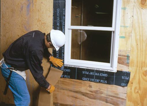

Installing Sheathing Wrap
Apply housewrap from the bottom to the top, so upper courses lap over lower courses and shed water. Always carry sheets around corners, then reinforce the corner by applying a second layer, or spline. The spline should extend at least 6 in. beyond the joint between the siding and corner boards.

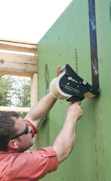

Taping Seams
The seams of a mechanically attached housewrap must be taped if it is to serve as an air barrier as well as a WRB.
Some tape can be used to repair rips (particularly tears around staples) and for securing the wrap to flashing before the siding goes on. For best results, use a polypropylene tape intended for housewrap or a flexible, peel-and-stick flashing. This is not ideal, however, as it creates a reverse lap.
A high-quality polyurethane rubber caulk may also be used to seal plastic house wrap.

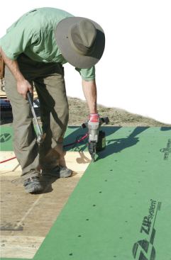

Weather-Resistive Sheathing
An alternative to installing a building wrap is a structural sheathing system that includes a water-resistant kraft-paper overlay. This material installs like ordinary OSB sheathing. After the panels are nailed off, the seams are sealed with a specially designed tape. The taped panels create a continuous air barrier at an installed cost that compares favorably to that of conventional sheathing with housewrap. The advantage is faster dry-in times and less wind damage to the weather barrier before siding and roofing gets applied.

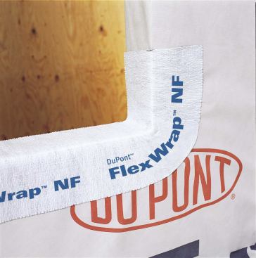

Choosing Flexible Flashing
Flexible flashing — a self-adhering tape — should be used to flash all the following: exterior door sills; deck ledgers; inside and outside corners of wall sheathing; stucco shelves and parapets; below-grade concrete cracks; and wall areas subject to splashback.
Flexible flashing for residential work is available in thicknesses from 12 to 70 mils, in widths from 3 to 36 inches, and with several types of facings. It comes in peel-and-stick and mechanically attached types.

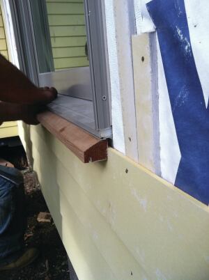

Flashing Windows and Doors
Refer to Windows and Doors for flashing flanged, unflanged, curved-top and recessed windows, as well as door thresholds.

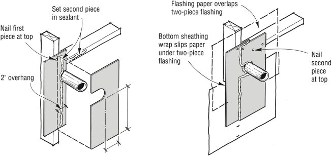

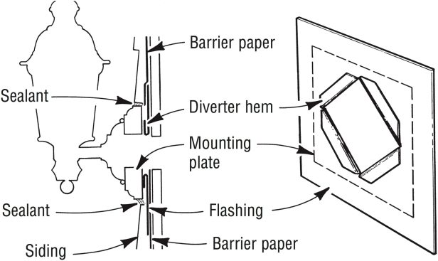

Flashing Wall Penetrations
Install electrical boxes and lighting fixtures on a hemmed metal flashing plate. Do not tape the plate over the housewrap; slit the housewrap and tuck it beneath.

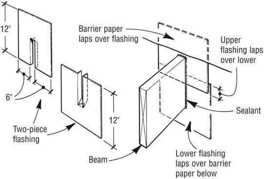

Gas line, conduit, water spigots, and other small penetrations should be flashed with a two-piece metal flashing plate. Seal the two plates with a "low modulus" urethane caulk (see Caulks and Sealants).

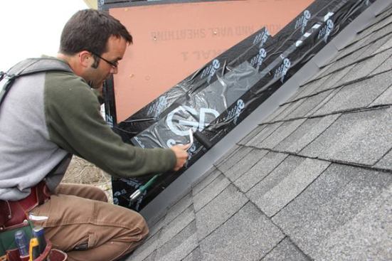

Step and Kickout Flashing
Where a roof butts into a wall. The roof should be flashed with a step flashing.
