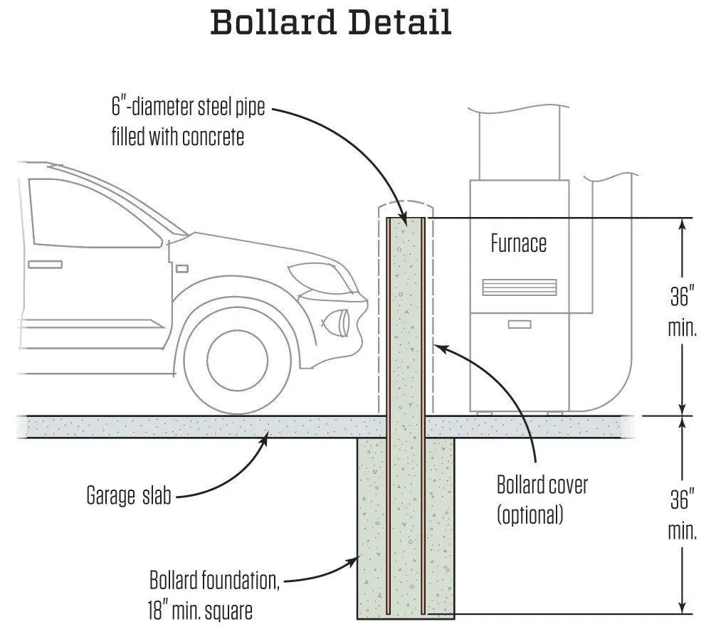

In configuring bollards, both the IBC and ASCE-7 set a design force for bollards that assumes a 6,500-pound vehicle traveling at 5 mph. Using a chart in the article (Figure 5), we can approximate an impact load of around 10,000 pounds at 5 mph. But that speed might be conservative if, for example, the driveway in front of the garage is inclined. A vehicle rolling down an incline could accelerate and reach a speed much greater than 5 mph, resulting in a much greater force that the bollard needs to stop.
The article shows a bollard made from 8-inch concrete-filled steel pipe embedded 4 feet into a concrete foundation. That may be overkill because that bollard is designed to stop a 4,500-pound car going 30 mph. On the other hand, you wouldn't want the car taking out the furnace. For the application you're asking about, I would recommend a 6-inch–diameter steel pipe filled with concrete.
According to the recommendations of the Military Field Manual, the pipe needs to be at least 3 feet high to match the bumper height of most cars. For 6-inch–diameter steel pipe, I would recommend that the bollard foundation be 3 feet deep and at least 18 inches square. That works out to a bit less than 7 cubic feet of concrete (about 1/4 yard)—not really that much, but still a fair amount to mix by hand.
Note that a concrete post by itself—even at 8 inches in diameter—has little to no bending strength. In other words, a car running into it would easily break through it. That means an effective bollard must be steel—ideally a steel pipe filled with concrete. Even though the concrete adds no strength in resisting impact, it helps the pipe itself resist collapsing at the point of impact.
If preventing scratches to a car bumper that might accidentally hit the bollard is an issue, there are some good plastic bollard covers available, including a large selection from Uline to go over pipes of different diameters. These covers come in several colors; but I would go with something highly visible, such as yellow or red, to make the bollards easy to see.
