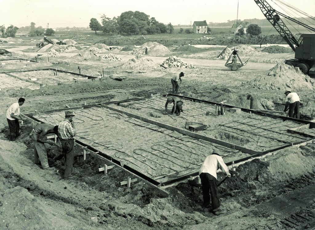

Levittown’s ‘Cellarless’ Homes
To increase production speed,  Levitt and Sons used slab-on- grade construction. At  the height of its productivity,  the company erected one  house every 16 minutes—  which became part of its  sales pitch. By 1951, 17,447  homes had been constructed.  No under-slab insulation  or vapor barriers were  installed, and the copper  piping used for the hydronic  radiant heat corroded fairly  quickly (leaks often went  unnoticed, soaking into the  ground). Many homeowners  abandoned their heating  system within 15 to 20 years.
Printed with permission from Levittown Public Library
