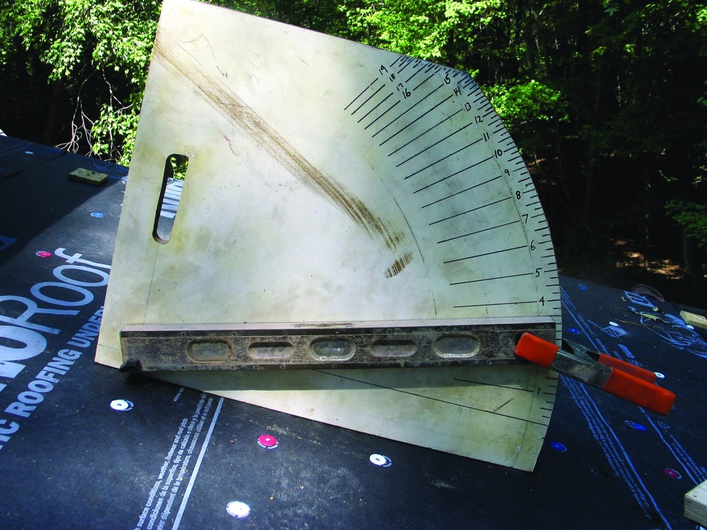

A homemade pitch-measuring tool determines the pitch of an existing shed roof.

We wanted to make the porch roof as steep as possible while keeping the peak of the roof below the wall-to-roof intersection at the top of the shed roof. After a taking some measurements and doing a bit of ciphering, we established that the steepest pitch we could use on the porch roof was 4-in-12. Using a pitch-measuring tool that I’d made, we also determined that the exact pitch of the shed roof was 3 1/2-in-12.

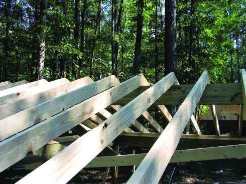

To keep the porch roof framing as simple as possible, we installed a structural ridge supported by posts at each end, with the common rafters landing on top of the ridge. After installing the rafters, we still had to extend the porch roof back over the shed roof, creating a valley on either side.
The gable roof on the porch addition was framed with a dropped structural ridge supporting the common rafters above.

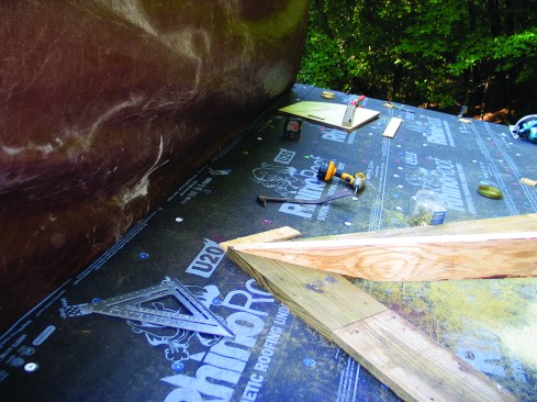

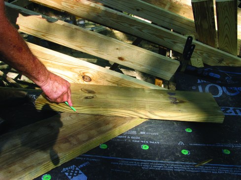

Again choosing the easy way out, we opted to build blind valleys (aka California valleys), where one intersecting roof is built on top of the other. To make the blind valleys, we attached sleepers to the shed roof, locating them by placing a 14-foot straightedge (that is usually used for screeding concrete) on top of the porch rafters to project the plane of the new porch roof over to the surface of the existing shed roof. We simply slid the straightedge over until it hit the shed roof and then positioned a 2-by under the straightedge and marked the edge of the 2-by. We did this at the top and bottom on both sides of the roof and connected the marks with a line, which gave us the placement for the blind valley sleepers.

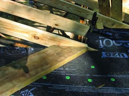

After the blind valley pieces are located, the ends are angled by scribing along a 2-by against the common rafter
The angle is then cut and the blind valley fastened into place.
To angle the lower end of the sleepers, we placed a length of stock on the valley line with one corner against the innermost common rafter, and with a scrap of 2-by on top of the stock, we traced the angle. Rather than try to cut the sleepers with perfect angles top and bottom, we intentionally kept the sleepers a foot or so short of the peak and nailed the bottom pieces into place. The sleepers were only there to provide a place for the jack rafters to be nailed, so they could be installed in pieces. We extended the lines of the sleepers up the roof until they intersected. Then it was just a matter of marking and cutting the miter for one side, and flipping the cut-off scrap over and cutting it to length for the other side. Because the level cut on the jacks would be so long, we added 2×4 sleepers inside the 2x8s for a more complete bearing surface.

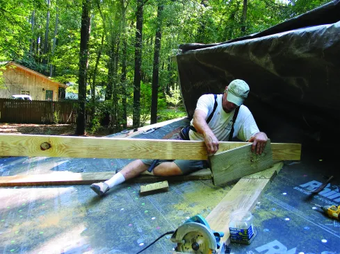

To scribe the roof angle on the ridge, a length of stock is leveled over from the common rafters and a 2-by scrap is set against the sleepers.
After the ridge is cut to the correct angle and length, it’s nailed into place.
Ridge and Jacks
Where the porch roof extended over the shed roof, we installed a 2×6 ridge that ran from the top of the dropped structural ridge to the apex of the sleepers. To scribe the angle, we placed a length of stock on top of the rafter peaks and leveled it across, using a scrap block to trace the angle. After cutting the ridge to length, it dropped perfectly into place.

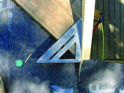

Layout for the jack rafters is pulled from the commons.
A rafter square determines the layout angle.

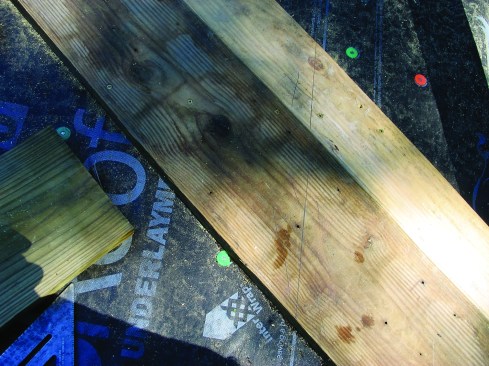

After attaching the ridge, we laid out and attached the jack rafters. We pulled the layout for the jacks by hooking a tape on the commons and marking out 16-inch increments, and made the same layout on the ridge. To draw the layout line, we first placed a rafter square on the sleeper against the last common rafter. After setting that angle at each layout mark, we drew the layout line across the sleepers.
The angle is then transferred to the sleepers at each layout mark. The same layout is done at the ridge.

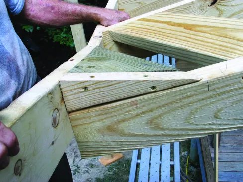

The top cut for the jack rafters was a plumb cut for a 4-in-12 pitch, the same as for the common rafters. To make the bottom cut, I laid out a level cut for a 4-in-12 pitch. To let the jacks sit plumb on top of the sleepers, we angled the level cuts to the 3 1/2-in-12 pitch of the shed roof, setting the circular saw to a 16-degree bevel (the degree equivalent of a 3 1/2-in-12 pitch). We measured from the ridge to the sleepers to get the lengths of the jacks, and then cut them and fastened them into place.

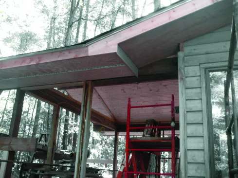

Creating a Valley at the Eaves

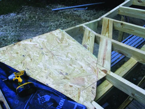

Next we worked on the valley at the lower part of the roof. The bottom of our blind valley was about 30 inches short of the bottom of the porch roof, so we extended the line of the valley down to the edge of the new roof. To do this, we had to extend the plane of the shed roof out over the porch roof, creating a small triangular extension of the existing roof.
At the low end of the valley, the subfascias of the two roofs are mitered, with a block filling in the roof framing.
Sheathing blocking is added along the valley, and the sheathing pieced in for both roof planes.
To transition the eaves, the horizontal fascia extends to the last rafter tail, and a vertical return finishes the transition.
We cut the rafters to length on the porch roof so that the subfascia would be in line with the subfascia on the new overhangs we’d added to the shed roof. We mitered the two subfascias where they met and then filled in with wedged-shaped blocking screwed to the tops of the common rafters to support the plane of the shed roof. We also added blocking along the valley on both sides to support the edges of the sheathing. The sheathing was just a matter of cutting and fitting the triangular pieces on both sides of the valley. We resolved the eaves by extending the line of the porch subfascia over to the tail of the last common rafter below the shed-roof overhang. Then we added blocking and a vertical return.
