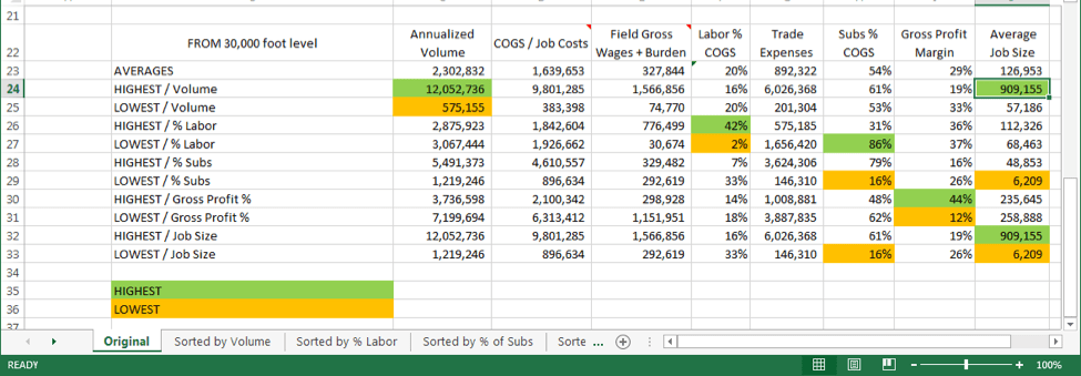

To get an answer, I reviewed year-end financial statements from between 2010 and 2015 from 127 remodeling companies, with revenues ranging from $575,155 to nearly $12.1 million and average job size ranging from $6,209 to $909,155. Here’s the result:
On average, these companies had $2.3 million in volume, of which $1.64 million went to cost of goods sold (COGS) and $663,000 was kept as gross profit, a GP percentage of 29%. Again on average, direct labor costs plus the related burdens of employment averaged $328,000, or 20% of COGS. The cost of using tradespeople averaged $892,000, or 54.4% of COGS.
Given that wide variation, I focused on remodelers with revenues around the $2.3 million average:
