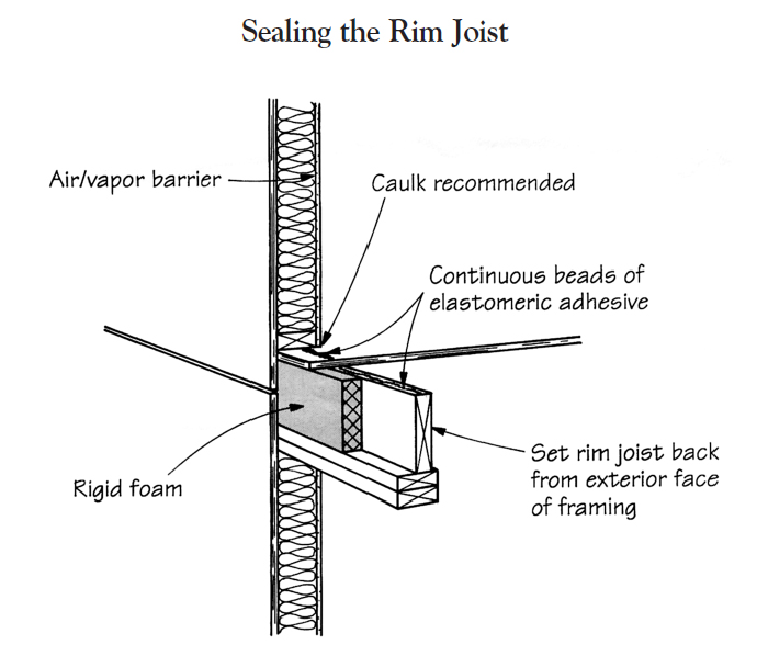

Instead of wrapping the vapor barrier around the band joist, you can insulate the band with rigid foam so that it’s not prone to condensation.

Band joists. Sealing a second-story band joist is particularly hard — because unless you wrestle with the poly while you’re framing, it’s nearly impossible to get a continuous seal. The best solution we’ve seen is to inset the second-story band joist and run a strip of rigid insulation on the outside. This keeps the band joist area warm, so that it’s not prone to condensation (see illustration below). For very cold or windy sites, you can improve upon this by adding a strip of housewrap around the band joist. Tyvek is available in 3-foot-wide rolls for this application. In colder climates, a tight band joist is critical for keeping blasts of cold air out of the floor system.
