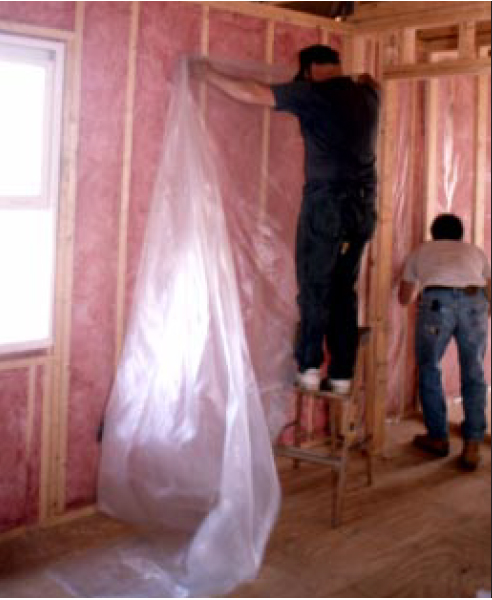

Q. Does a vapor barrier need to be installed perfectly to be effective?
A. No. At a given vapor pressure, the amount of diffusion you’ll get is directly proportional to the surface area that is exposed to the moisture. So if you have only 90% of your walls covered with poly, your vapor barrier will still be 90% effective.
This is not true of an air barrier, however, since air seeks the path of least resistance. Under pressure (air pressure, that is, not vapor pressure) a great amount of air can leak through even a small crack in a building — just as a lot of air can rush out of a small hole in a balloon.

Q. Should the vapor barrier go on the inside or the outside of a building?
A. In [climate zone 4C, 5 and above ] code requires you to put a vapor barrier on the inside. That’s because the strongest vapor flows are during cold weather from indoors out.
Vapor flows from the outside in are significant only in very hot, humid climates (CZ 1 and 2). In those areas, there is a great deal of controversy over whether you need to install the vapor barrier on the outside or leave it out altogether. Leaving it out is probably the most prudent course, provided you do a good job sealing the building against air leaks.
The bottom line: Put the vapor barrier on the inside in cold climates and leave it out in hot, humid climates.

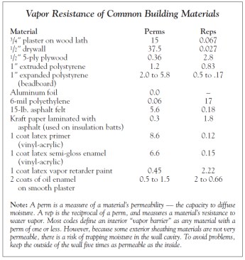

Q. Is paint a vapor barrier? How about black paper, housewrap, and plywood?
A. A material’s perm rating indicates the ability of moisture to diffuse through the material. The lower the perm rating, the better a material’s resistance to moisture diffusion. In general, codes call a material a vapor retarder if it has a perm rating of one or less.
From the table above you can see that a couple of coats of oil-based paint can act as a pretty effective vapor barrier. However, 15-pound asphalt-impregnated felt is not a vapor barrier. Kraft paper is a vapor retarder when relative humidity is low, but it absorbs moisture when the relative humidity is high, and it’s permeability increases. So Kraft-faced batts will allow a wall cavity to dry to the indoors in winter when indoor relative humidity increases. OSB, which is not listed on this table, is around 2 perms. A wall sheathed with OSB will eventually dry to the outdoors if the sheathing is not continuously wetted by condensation.
A useful rule of thumb is to keep the outside of the wall five times more permeable than the inside. To calculate the added value of two or more layered materials, you need to add the inverse of their perm ratings. This inverse figure is called a rep, and is a measure of a material’s resistance to vapor transmission.
The bottom line: Keep the outside of the building significantly more permeable to moisture than the inside and you’ll avoid trouble.
