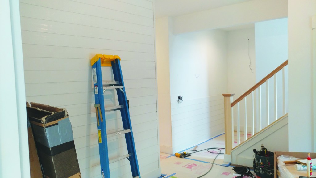

When we’re working with shiplap, the starting and stopping points—or terminations—determine how we install it and what tools we reach for to get it done. In a square room with no outside corners, the terminations are pretty basic and the main layout challenge is to avoid visible “slivers” (more on that below). Most of the houses I trim, however, have an open floor plan with few places to end runs.
For example, when there is a run of shiplap down a hallway and the termination point is an outside corner, I like to butt the shiplap into a square stop that I mill from 5/4 stock. On paint-grade trim, I sand the cut edges smooth to remove the table saw’s swirl marks. For stain-grade work, I like to use maple, alder, and even white oak, cutting a shallow rabbet in the stop to cover the shiplap ends.
A table saw makes quick work of both cuts—rabbet and square. For the rabbet, I usually run one side, flip the 5/4 stock over and adjust the blade, and run the other edge. If there’s a lot to run, it probably makes sense to set up a dado blade or even a router table with a straight-cut bit, depending on the scope of work.
For mid-wall terminations, I like to run my stops square and butt to them, though if I’m worried about expansion and contraction—say, on a beach house—I might considering rabbeting both sides of the stop to cover the ends of the shiplap. For most of the shiplap we install, however, I think the butt joint leaves a cleaner look; I don’t like the little holes the rabbet reveals where it covers the nickel gaps.

Once the termination points have been laid out and the type (dado, butt, return) determined, it’s a matter of nailing the shiplap to the wall. Almost. First, avoid slivers. You don’t want to start running the shiplap and end up with a sliver at the top, or worse, a tapered sliver. So, a little math goes a long way.
I measure the wall height in a few places, measure the shiplap’s face coverage plus the reveal, then—using a baluster-layout app called BalusterPro on my phone—divide to see how the pieces land. Depending on the width of the border piece, you can divide it in half—like tile or a suspended ceiling with even pieces on each end—or put the whole border piece on one end. Sometimes, it looks better to have the border piece at the bottom, sometimes at the top. It’s personal preference.
The author plans layout to avoid “slivers,” or narrow lengths, at the top or bottom of a horizontal run when installing shiplap within a shelving unit ...
The author plans layout to avoid “slivers,” or narrow lengths, at the top or bottom of a horizontal run when installing shiplap within a shelving unit …
... or as wainscot.
… or as wainscot.
Once I’ve figured out the starter-board dimension and ripped it to width, I use a laser to make horizontal reference marks around the room, and I find and mark the studs. Then I level the starter board, which I nail in place tongue side up with an 18-gauge brad nailer (in some cases, it’s better to run the starter parallel with the ceiling, if the ceiling is out of level).
I face-nail along the bottom, then along the top through the tongue and into the studs. With nickel-gap shiplap, the nails have to be placed high in the tongue so they aren’t visible in the gaps. On tight gap, there’s no tongue, so face-nailing is the only option.
While tight-gap siding can be installed from the top down, we usually run it from the bottom up. At the top, we install a trim piece—either crown molding or a flat stop—to close the gap.
