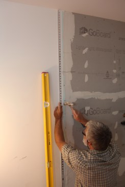

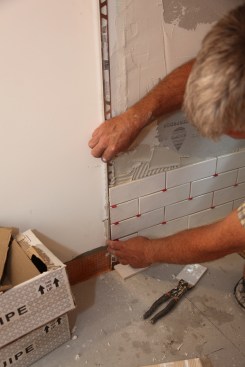

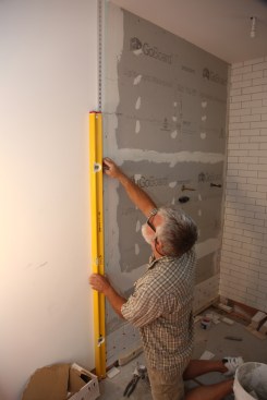

Metal edging completes the tile on this wall of the shower. After completing the four courses over to the layout line, the crew member inserts metal edging behind the tile.
He plumbs the edging up the wall marking the plumb edge.
He then secures the edging in place on the wall with galvanized roofing nails.
