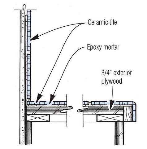

For dry, light-duty counters, 3/4-in.
exterior-grade plywood will work as a tile underlayment. Avoid pine
plywoods; the pitch may act as a bond breaker.
For dry, light-duty counters, 3/4-in. exterior-grade plywood will work as a tile underlayment. Avoid pine plywoods; the pitch may act as a bond breaker.
A light-duty countertop that won’t see much moisture can be made using a mastic- or epoxy-based mortar applied directly to 3/4-in. plywood, as shown in the illustration below. Leave a 1/8- to 1/4-in. gap between sheets and screw a 1x batten under each joint.

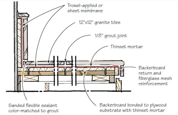

For a counter that will get heavy use in a wet location, add a trowel-applied or sheet membrane over cementitious backerboard. Extend the membrane up into the backsplash area.
The backerboard should be laid over a 3/4-inch exterior-grade plywood substrate, attached with a leveling bed of thinset mortar in between. Secure the backerboard with ceramic- or epoxy-coat hi-lo screws (such as ITW Rock-On screws) or galvanized roofing nails. Do not use drywall screws.
For countertops that will see heavy use in a wet location, install cement backerboard over the plywood base, and a trowel-applied or sheet membrane, before installing tile.
Use a natural cement-colored grout mixed with a latex additive (or use a polymer-modified grout). The width of the grout joint can vary, but narrow joints (1/8 inch or less) are easier to clean than wide joints. See Grouting Tile.
Use a heavy-duty sealer as well (not an inexpensive silicone liquid). Most important, include caulked expansion joints around sinks, cooktops, and chopping blocks and at the joint between the top and the backsplash, as shown in the illustration below.
