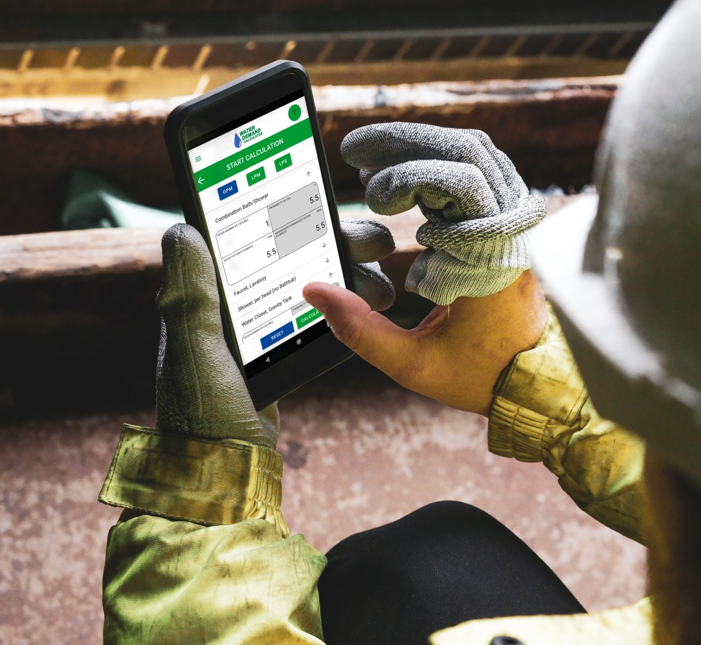

The Water Demand Calculator (WDC), available as a smart phone app, is the first statistically-based update to sizing water supply piping in almost 90 years. According to the International Association of Plumbing and Mechanical Officials (IAPMO), which developed the app, the WDC  provides as much as a 65% reduction in water demand estimates for single-family homes and multi-family units.

To bring plumbing pipe sizing into the twenty-first century, the International Association of Plumbing and Mechanical Officials (IAPMO) has developed the Water Demand Calculator, which automatically computes the peak water demand flow rate (in gpm) for the plumbing system. IAPMO has essentially done the math to help home builders build better plumbing systems for less money.

By entering the number of water-consuming fixtures and appliances - or the individual branches and risers - the IAPMO Water Demand Calculator automatically computes the peak water demand flow rate (in gpm) for the plumbing system. This calculation replaces the antiquated method that uses fixture units and Hunter’s curve to estimate peak demand.

The IAMPO Water Demand Calculator can be dowloaded as an Excel file, or is available as a free app for Android and for iPhone.
