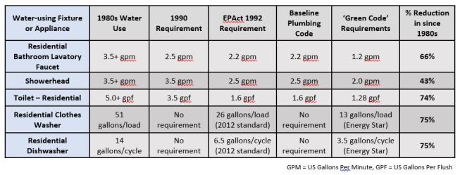

IAPMO’s Water Demand Calculator (WDC) represents the first significant update for water pipe sizing in buildings since the development of Hunter’s Curve more than 80 years ago. Of course, much has changed in the way Americans use water since 1940, when Dr. Roy Hunter developed his namesake method for determining water demand in a building. In fact, plumbing fixtures and appliances use only of fraction of the water they consumed since the mid-1980s. See Table 1 below.
Table 1: Water consumption by water-using plumbing products and appliances – 1980s to 20213
As a result, the plumbing systems in our single- and multi-family homes and buildings are oversized, which results in:
  • increased water aging and declining water quality resulting in an increased risk from biofilm development, Legionella and other opportunistic pathogens wasted energy and water;
  • unacceptably long hot water delivery times;
  • unnecessary material and labor costs during construction; and
  • unnecessarily high water meter connection fees and utility water use fees

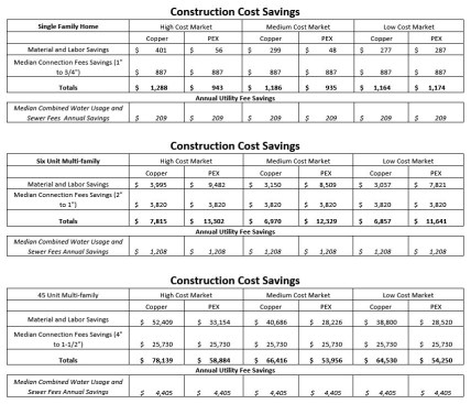

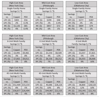

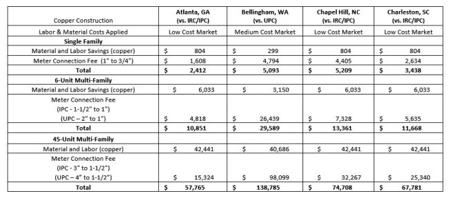

Table 2 (below) shows the total material and labor cost savings of applying the WDC based on a U.S. dollar / percentage basis as compared to applying the UPC, IPC, or IRC. These values represent the cost savings that can be expected when applying the Water Demand Calculator on one single-family home or multi-family building.
Table 2: WDC Cost Savings (US Dollars / Percent)
The Stantec report found that:
  • Due to reduced GPM requirements, the application of IAPMO’s Water Demand Calculator resulted in notable construction cost savings associated with each of the three residential prototypes. The primary cost savings are associated with reduced diameter water service entrances, interior cold water mains / branches, interior hot water mains / branches, fittings, labor, and appurtenances.
  • Utilizing the Water Demand Calculator for sizing of residential cold and hot water mains, branches and risers will result in:
-Shorter water dwell times in residential plumbing systems will improve water qualityand thus, most importantly, improve public health and safety.
-Reduced water service entrance, interior cold water mains / branches, interior hot water mains / branches, fittings, labor, and appurtenances.
– Faster hot water delivery times throughout the hot water systems, will also save energy, water, and reduce utility bills for the entire life of the plumbing system.

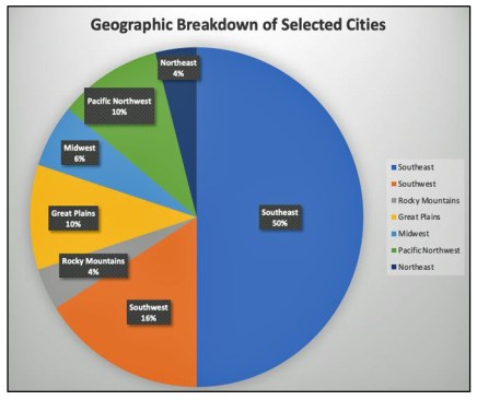

AWE collected data related to water connection fees and reoccurring water and sewer service charges by meter size for 50 of the fastest growing metro areas in the United States. Figures 1 (left) and 2 (below) show the geographic location and regional breakdown of the cities selected for the study. The purpose was to build a dataset that would provide information about the difference in connection fees and reoccurring charges by water meter size, and the potential cost savings that are available due to the emergence of an updated pipe sizing methodology, the Water Demand Calculator.
Figure 2

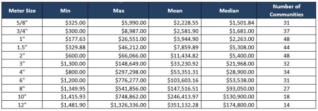

As shown in Table 3 (below), the research found extensive variability of connection fees across the country. The cost of a connection fee at a certain meter size can differ by mere tens of dollars up to hundreds of thousands of dollars. For example, the connection fee for a 4-inch meter in Spokane, WA is $9,857 while in nearby Portland, OR the connection fee for the same meter size is $85,311.4
Table 3 – Summary Statics of Connection Fee by Meter Size
Both the Mean (average) and Median values are shown in Table 3. While the Mean value includes outliers due to the wide variability of connection fees, the Median value better reflects the typical cost savings that can be expected when utilizing the WDC. Special attention should be placed on the ¾” to 2” meter size connection values, as these will typically apply to single-family homes.

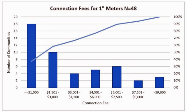

The histogram in Figure 3 (belowP shows the distribution of connection fees for 1-inch meters only. The data shows that over 60 percent of 1-inch meter connection fees exceed $1,500 and over 40 percent exceed $3,000. Thus, the majority of single-family homes will realize significant connection fees cost reductions in addition to the material and labor savings detailed in the Stantec report shown on page 3.

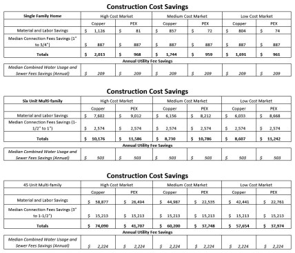

Combining the cost savings from the Stantec Report and the median value connection fee savings from AWE Report provides a conservative estimate of the cost savings potential resulting from simply applying the Water Demand Calculator as opposed to applying the outdated fixture unit based pipe sizing methods. The examples shown in Table 4A and Table 4B show the combined savings as opposed to applying the pipe savings methods found in the 2018 Uniform Plumbing Code or the International Plumbing Code (IPC).
Table 4A – Combined Construction Cost Savings, Annual Water Usage and Sewer Fee Savings (Water Demand Calculator vs. IPC / IRC)
Table 4B – Combined Construction Cost Savings and Annual Water Usage Savings (Water Demand Calculator vs. UPC)

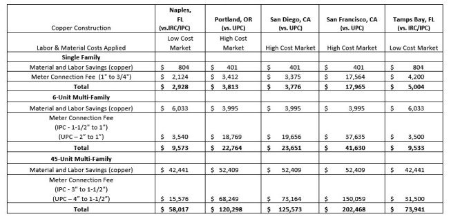

Table 5 (below) details the saving resulting from applying the WDC when constructing the model buildings in nine select fast growing metro areas.
