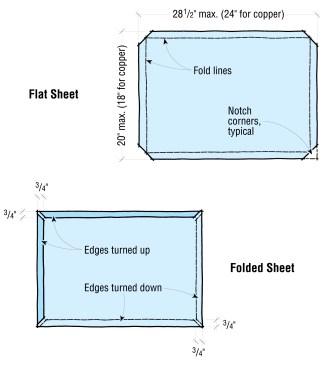

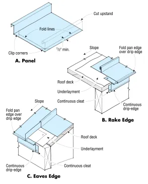

  • Form pans from 20×28-in. sheets, using a metal brake (see pattern below).
Cut flat-lock metal roof panels from 20x28-in. panels (for terneplate) or 18x24-in. (for copper), and then bend as shown.
Cut flat-lock metal roof panels from 20×28-in. panels (for terneplate) or 18×24-in. (for copper), and then bend as shown.

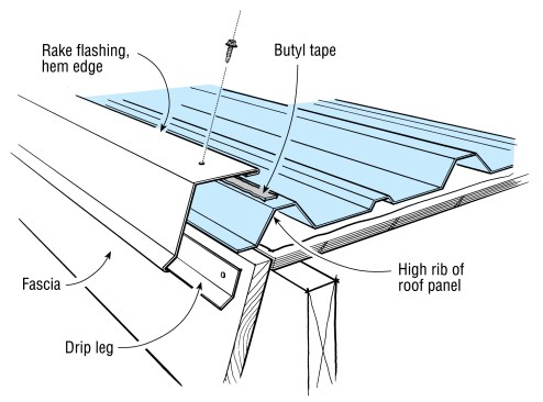

  • Panel edges along rakes and eaves lock over a drip-edge flashing (follow as shown in figure, Standing-Seam Edge Detail, below). Lock panels to L-flashing bent from flat-stock metal at vertical walls.
  • Stagger panels, and secure to roof deck, as shown in the figure below.

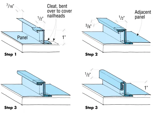

To secure a standing seam panel, a metal cleat (1) is bent over the panel stand (2), then nailed to the roof deck. The adjacent panel fits over the two pieces (3) and the entire seam is folded closed (4).

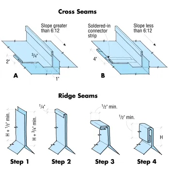

Cross seams: Use a standard cross seam (A) on roofs greater than 6:12. Roofs less than 6:12 require a more watertight cross seam (B), using a soldered-in cleat. Ridge seams: The stand at the ridge should be a minimum of 1 in. (H).
  • When figuring pan lengths, allow extra for cross-seams and ridge seams (above).
  • For shallow roofs (less than 6:12), allow a minimum 4-in. overlap, plus an additional couple of inches to form a deeper cross seam that accommodates a cross-seam connector strip (above).

Width of gable-end pans. At gable ends, cut off the upstand on the gable side of a preformed pan, and allow a 1/2-in. fold over a drip-edge. This will reduce the pan width on the roof by 11/2 in. (below).
On a corner panel (along a gable end), cut off the upstand, then clip the pan corner at 45 degrees, as shown (A). Install a continuous drip-edge around the roof perimeter, then fold the edges of the pan 3/4 in. over this drip-edge, and lock in place with crimpers.

  • Fold the first standing seam closed, as shown below.

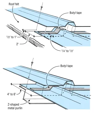

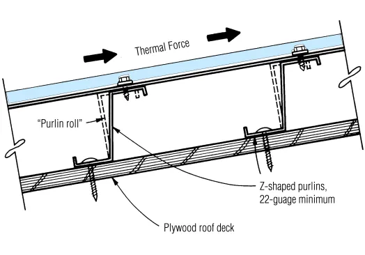

Metal roof panels installed over Z-shaped purlins will “roll” with thermal expansion of the panels. Wood strapping or hat channel will not absorb thermal expansion as well.

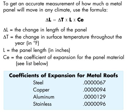

Thermal Response of Metal
Metal expands and contracts with changes in temperature, which can be quite extreme on a roof. For example, in winter it’s not unusual for a roof panel to go from 180°F on a sunny day to below 0° at night. Under these –conditions, a 20-ft.-long steel panel would expand over 1/4 in. An aluminum panel this size would expand more than 1/2 in. If attached to plywood sheathing, the panel will “crown” between fasteners, and the force can cause screws to shear or the metal to tear around screws.
Evaluate the expected amount of change (see figure, Roofing-Calculating the Thermal Response of Metal, below). If the change in the length of the panel exceeds .15 in., consider these strategies:
  • Reduce panel length;
  • Install panels over Z-channel to absorb movement (see figure, Thermal Response Over Z-Channel, above).

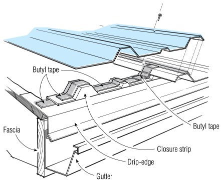

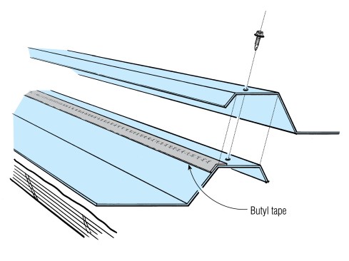

  • Use butyl tape (1/2-in.-wide works well for panel seams). Tape sealants, which have a high solids content (about 97%), don’t shrink as much as gun-grade sealants. Most tapes for metal panels are butyl polymers, which will last 30 years or more if protected from exposure to ultraviolet light. Gun-grade sealants are usually about 70% solids, which means that when the 30% solvent evaporates, the sealant shrinks.
  • Do not use silicone. Many silicone sealants contain acids, which can damage metallic coatings. Also, silicone has poor adhesive strength on metal. If butyl tape is not available, use a urethane instead.

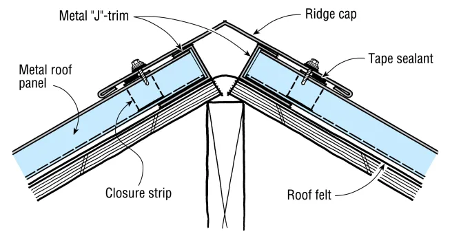

  • Always seal between panels so the sealant is hidden from the damages of ultraviolet light. Sealants smeared on the exterior of the panel will surely fail.
  • At eaves, in valleys, and on the upslope side of chimneys and skylights, use rubber closure strips to seal the void created by the profile of the panel ribs. Most panel suppliers offer these closure strips in both male and female (inside and outside) configurations. Make sure a metal panel or flashing extends over the rubber closure to protect it from sunlight.

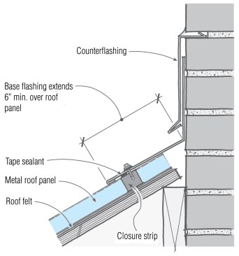

Wall Flashing For Metal Roofs
When flashing against walls — as well as skylights, chimneys, and roof hatches — use a two-piece flashing with closure strips (rubber blocks that mirror the panel profile) or preformed curb flashings (below).
Use a two-piece metal flashing to accommodate the differential movement between walls (or chimneys, skylights, and roof hatches) and metal roof panels. Fasten the base flashing to the roof panel, but not to the counterflashing.
  • Connect the base flashing to the roof panel with washered screws.
  • Apply tape sealant between the roof panel and the flashing, and be sure the screw pierces the sealant or is placed on the dry side of the tape, not on the weather side.
  • Seal the joint between the base flashing and the roof panel with tape sealant.
  • On the upslope side of a chimney or skylight, use a cricket, or diverter, to direct the flow of water around the penetration. This cricket should be inserted beneath the upslope panel, sealed with butyl tape, and the voids at the cut edges of the roof panel sealed with rubber closure strips.

  • Apply the tape to the top shoulder of the panel rib, making sure that the majority of the sealant winds up on the weather side of any fasteners (below).
  • Do not peel away the release paper until you’re ready to install the overlapping panel. Align the panel exactly before it contacts the sealant. Once a panel touches the tape, even a small adjustment is difficult.
  • Screw panel sides together, piercing through the sealant on the “dry” side with 3/4-in.-long 1/4×14 hex head galvanized screws with a #1 drill point.
To seal the lap between adjacent panels, apply butyl tape to the weather side of the rib shoulder.
Sealing Endlaps
  • Make sure the upslope panel always overlaps the downslope panel (below).
  • Apply sealant on the weather side of the endlap fasteners.
  • Place screws that secure the panel to the deck (or purlins) above the endlap sealant.
Use butyl tape to seal panel endlaps, making sure the screws that fasten the panel to the deck (at top) or to purlins and sleepers (at bottom) are placed above the sealant, as shown.
Sealing Eaves
  • Drip flashing should be nailed down just enough to hold it in place prior to installing the roof panels.
  • Screws to hold down roof panels should pierce through the panel, drip flashing, and deck.
  • If gutters are used, take extra care to seal with rubber closures and butyl tape to prevent snow, rain, and ice from entering the panel voids (below).
When gutters are used, seal the eaves as if they will be submerged in water. Without gutters, roof panels should overhang the drip-edge at least 4 in.
Sealing Rakes
Prefabricated commercial rake flashings are available, but these are usually too large and “boxy” for use on a residence. Instead, ask the panel supplier to furnish flat sheet stock with a matching finish to be bent into a simple L-flashing, as shown in the figure below.
  • Attach L-flashing to the roof at a high rib with sealant tape. This might mean extending the horizontal leg a few extra inches.
  • Fasten the L-flashing to the fascia using a metal cleat that matches the angle of the drip leg. (Alternatively, fasten through the face of the flashing with a washered screw.)
Fabricate rake flashing from flat sheet stock provided by the roof panel manufacturer. Extend the horizontal leg of the flashing so it attaches with butyl tape and screws to the roof at a high rib.
Hip and Ridge Caps
Most panel suppliers offer standard ridge components for use with their panels.
  • Use a sealant tape to seal the joint between roof panel and ridge cap.
  • When using long panels that are subject to substantial thermal movement, make sure the ridge cap and the panels are fastened separately to the deck.
  • For hips, metal roof manufacturers typically provide metal J-trim, which is topped by a metal ridge cap (below).
  • On complex roofs where snowmelt and ice damming patterns are difficult to predict, make the hip assembly watertight with plug closures and tape sealant.
To seal hip ridges, use metal J-trim set square to the panel’s length. On simple hips in steep roofs, this assembly can be installed without tape sealant; on complex or low-slope roofs, use with rubber closures and butyl tape.
