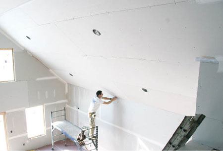

I once had a customer who had a cathedral ceiling in her bedroom, with a large oval window in one of the gable-end walls. Long after the drywall was hung, taped, and painted, she complained that when the sun was setting, she could see a shadow along a butted end seam on the ceiling. (Of course, the seam was invisible any other time of the day or night.) Ever since, I’ve been very careful about where I put butt joints.
These days, many of the homes I hang drywall in are even trickier than that house, with open floor plans, high ceilings, and lots of windows. They also tend to feature special lighting effects — including downlights, spotlighting, and sconces — and glossy paint finishes rather than flat paints and textured surfaces or wallpaper. With all of this light shining across reflective walls and ceilings at low angles, particular attention must be paid to the drywall finish.

Think of installed drywall as a kind of patchwork, with tape and compound used to strengthen the seams and blend all of the gypsum-board sheets together. Sanding the compounded areas smooth creates different textures on the surface of the drywall: very smooth areas that have been coated with compound; uncoated — but sanded — areas on the drywall surface (often the fibers of the paper are slightly raised after sanding); and the remaining, untouched paper-surface areas (the paper surface is not as smooth as the sanded joint compound). In addition there are sometimes slight bumps or recesses at the seams — especially at butt joints — and slight craters or excess compound over the fasteners. Under most circumstances, none of these differences show up under a paint finish, but occasionally they are as glaringly obvious as my client’s drywall seam.
A good drywall contractor can’t always avoid butt joints, but he can plan them so they don’t fall in an obvious location. Likewise, gypsum board can be finished to a uniform texture and porosity; the trick is to know where and when this higher level of finish is needed.

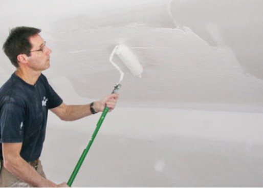

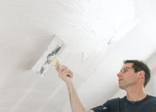

One way to upgrade to a Level 5 finish is to skim-coat a Level 4 finish with watered-down joint compound. The skim coat smooths the texture of the paper and reduces differences in surface porosity, creating a more uniform paint substrate. The compound can be applied either by trowel or with a short-nap paint roller, then immediately removed with a wide knife before it has a chance to dry. I add 20 cents per square foot to the cost of a Level 4 finish for this upgrade.
To add a skim coat, the author mixes up a bucket of watered-down joint compound
He applies it to the drywall with a 1/2-inch nap paint roller

He removes excess compound with a wide knife before it has a chance to dry, then lightly sands the entire surface before priming.
