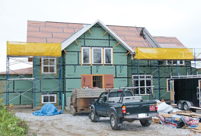

Harnesses may not be needed when there is fully planked staging up to the eaves of a house with guardrails installed as shown. But workers on the cross-gable still need fall protection, because they would be within 6 feet of an unguarded roof edge.
