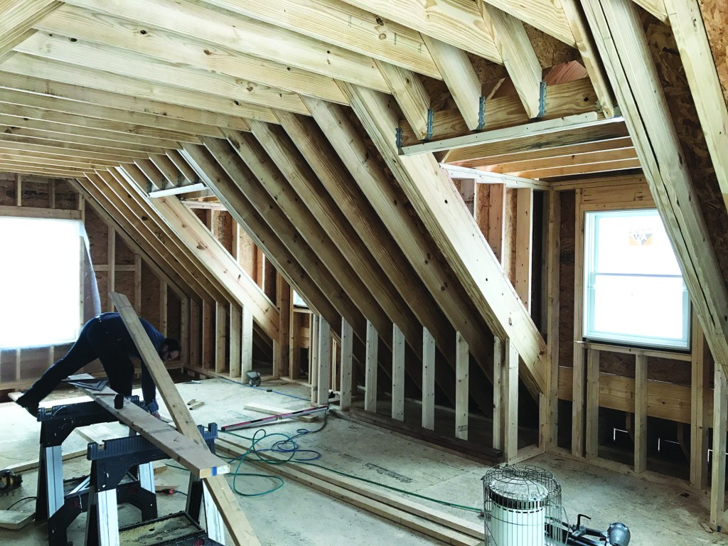

This past winter, we built a large, freestanding, two-bay garage. The footprint of the building is 26 feet by 32 feet, and the entire structure is finished inside, including a second-floor home office. Total finished space is approximately 1,500 square feet. The second-floor office is heated and cooled with a ductless mini-split.
With a straight gabled roof profile constructed using 2×12 dimensional lumber, the second-floor office has large sections of cathedral ceiling, where the finished drywall is directly under the roof rafters. These sections of framing can be tricky to insulate and air-seal (see “A ‘Never Worry Again’ Insulated Ceiling,” Jan/19). In consultation with the architect for the garage, we decided to use 7 inches of closed-cell spray foam to insulate this rafter space.

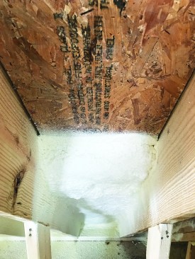

The author decided to ensure the durability of that portion of the roof by building a robust venting system. He stapled 1 1/2-inch furring strips to the top edge of each rafter in every bay.
Tthen stapled OSB to these nailers in order to create a large vent channel.

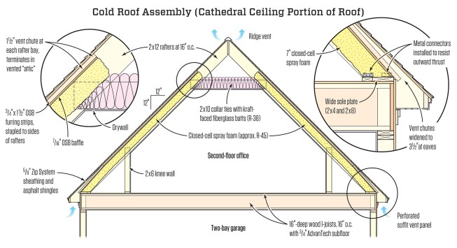

With images of these failures vivid in my mind, I try to avoid hot roofs. Instead, I like to build a fully vented roof assembly that is insulated with closed-cell spray foam. This roof assembly is often referred to as a “cold roof” and is the antithesis of a hot roof. With two strategies employed (the airtight, vapor-impermeable foam, plus the ventilation as a safety valve), you might call this a “belt and suspenders” approach to building. A cold roof assembly can also be created using other types of insulation.
The 1 1/2-inch vent channel terminates in the vented attic of the building.
Spray foam is applied to the underside of the vent channel. If there are imperfections in the spray-foam application, the vent provides backup to clear any moisture.
The primary goal here is to avoid trapping moisture under the roof deck. The second and nearly as important goal is to keep the roof deck as cold as possible during upstate New York winter months. Cold roof sheathing is one of many components in keeping ice dams at bay. To create a cold roof, we provide each rafter bay with a full-width vent chute that leaves a 1 1/2-inch air channel under the roof deck. This provides for ample airflow. It is important when building this assembly to ensure that we have proper soffit intake, as well as ridge venting for exhaust, as specified in the building code. If the spray foam was applied improperly, or there is any future movement of the framing lumber, we still have a fully vented rafter assembly. Any vapor that potentially makes its way through the insulation layer can escape through the vent chute.

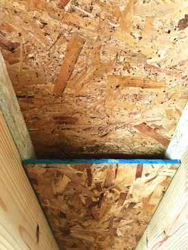

First, we ripped and installed 3/4-by-1 1/2-inch OSB furring strips up against the underside of the roof deck, stapled to the top edge of the rafters with 18-gauge crown staples. We used cutoffs of the OSB subfloor as well as other 3/4-inch commodity OSB materials.
Next, we covered the furring strips with 7/16-inch commodity OSB to create a vent chute. We also fastened the OSB panels with crown staples, about 6 to 8 inches on-center.
Finally, the spray-foam installer applied closed-cell spray foam directly under the OSB chute in 2-inch lifts.

The author builds a ventilated cold roof instead of a hot roof. Air entering the assembly through a soffit vent passes up the rafter bay to exit at the top through a ridge vent, providing drying ability while limiting snow melting to help prevent ice dams.
