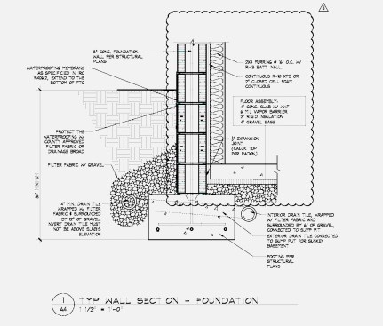

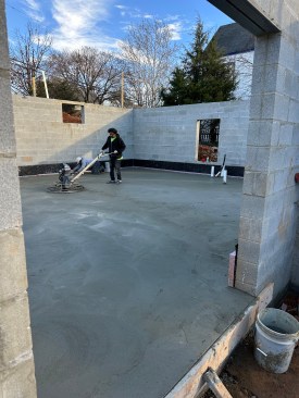

At the Queen of Zero ZERH project, JLC’s 2024 Case Study, we chose to exceed the slab insulation requirements per code and net zero certification. The local weather of this Zone 4 property can vary from frigid cold winters to sticky hot summers. The property slopes from front to back so that the rear foundation is above grade. The basement will also be a high traffic area, as the homeowner intends to use half of the 1,200sf footprint as his music band practice space, which means that in addition to providing human comfort, the space needs to maintain optimal humidity levels for the protection of the owners’ instruments.

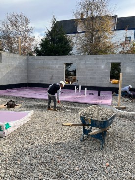

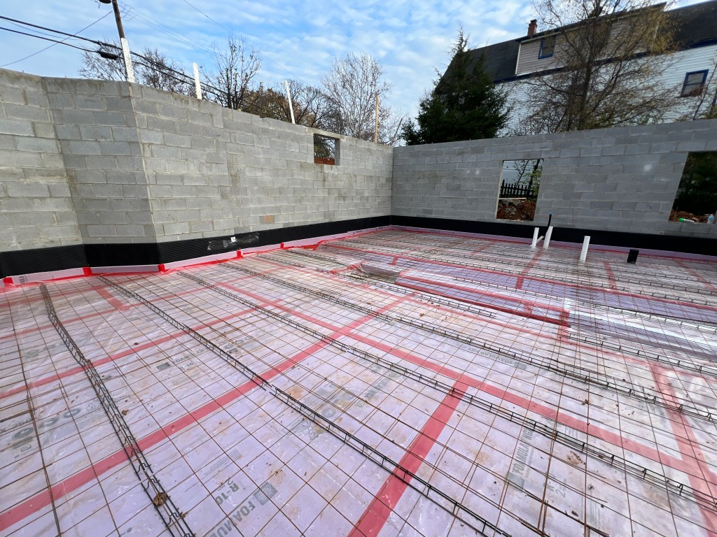

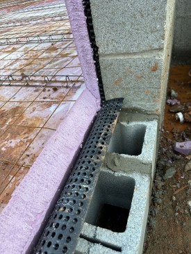

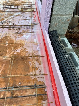

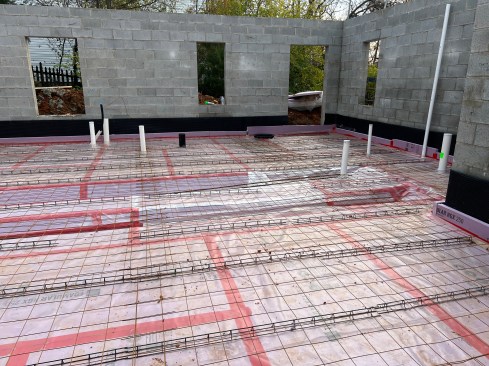

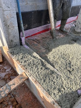

Beneath the entire slab, we installed 2 inches of R-10 Foamular NGX rigid XPS insulation, a certified Greenguard Gold and LEED-compliant product, over 4 inches of a crushed-gravel capillary break. The gravel had to be compacted and smoothed precisely so that the Foamular sheets lay completely flat. We also installed R-10 rigid XPS at slab edges and on the interior of all foundation walls. Seams of the insulation were sealed with vapor-impermeable Stego Tape. The total upgrade cost of our slab insulation was about $5,500 in labor and materials.
For additional protection from moisture and radon gas, we used a 6-mil polyethylene sheeting, lapped 6 to 12 inches, as per the ZERH specifications. The concrete slab was poured 4 inches thick, reinforced with welded-wire fabric (WWF).

Across the literature, experts emphasize the importance of continuous coverage—in particular, where horizontal and vertical insulating materials meet along the periphery. Similar to all aspects of air sealing and insulation in sustainable home-building, the ultimate performance depends upon a flawless installation without gaps or cracks from the ground up. As I walk the site inspecting the foundation, I look for any voids and silently repeat the mantra for high-performance builders: “devil's in the details, devil's in the details, devil's in the details, my friend.”
