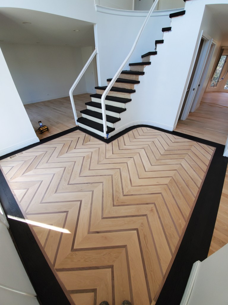

The homeowners planned to turn their entire home into “one huge piece of art,” complete with decorative furniture and elaborate wallpaper, says Matthew Szyszka of Chicago-based FloorMaster US Co. So when they switched gears at the last minute and asked Szyszka to install “something cool” in the 110-square-foot foyer, Szyszka wanted to make sure the wood floor would hold its own among the elaborate decor in store for the home.
“I came back to my garage, scratching my head—I wanted to do something special,” Szyszka says. “I thought, ‘The floor needs to pop out among all those things.’” Szyszka spent half a night sketching out ideas and landed on a white oak and walnut chevron for the space, with a black-stained border of the same woods. He started off his pitch the next day by showing the clients a plain chevron, which they liked; then he said, “Hold on,” and busted out the walnut, which outlines the wider oak chevron, and the homeowners were ecstatic. The rest of the house would feature regular 3 1/4-inch white oak to replace 1,000 square feet of ceramic tile.

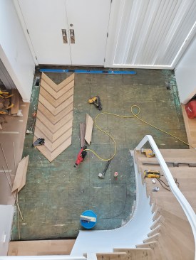

Szyszka’s supplier told him the chevron white oak boards and 1-inch-wide walnut strips would require a two- to four-week wait time. “I was like, ‘No way,’” Szyszka says. Instead, he took some available 5-inch white oak and 2 1/4-inch walnut boards and milled them himself using a miter saw, table saw, and router. “Pretty simple, but a lot of cutting,” he laughs. “Every single piece went through my hands.”
With the tile removed during demo, and the foyer thoroughly measured, and the flooring cut, Szyszka and his crew began installing the field of walnut and white oak with glue and nails. Once the field was installed, they cut in the walnut and white oak border using a track saw for the straight lines and a router for the radius near the staircase.

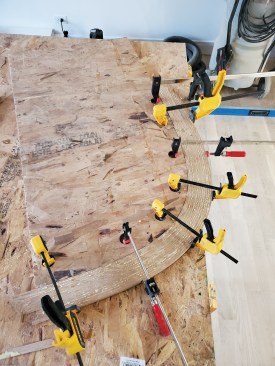

After installing the field flooring, he and his crew glued up the curved section of the walnut border, laminating it around a plywood form.

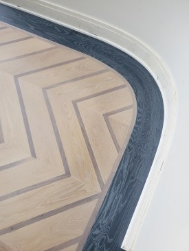

For the radius border, Szyszka cut 1/4-inch boards, glued them together, and clamped them overnight. “I wanted the grain to match because of the ceruse,” he says, referring to the finish technique that highlights the grain of the wood with a lighter color. “It was fun.”

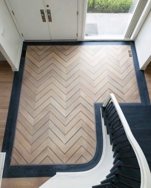

They sanded the floor with 80-, 100-, and 120-grit, then treated the border and stair treads with a black pre-color. They wrapped up the floor and stairs with a coat of hardwax oil. “The cool thing is that the grain color in the floor, border, and stairs all match,” Szyszka says. “It gives that a nice transition, nice flow.” Szyszka and his team also upgraded all the baseboards in the home and installed the staircase’s spindles.
To install the border, they then cut out the flooring using a track saw on the straight sections (above), while a router was used to cut out the flooring for the curved section near the staircase (right).
When the foyer was completed, Szyszka walked away knowing he’d created a floor worthy of a home focused on art.
