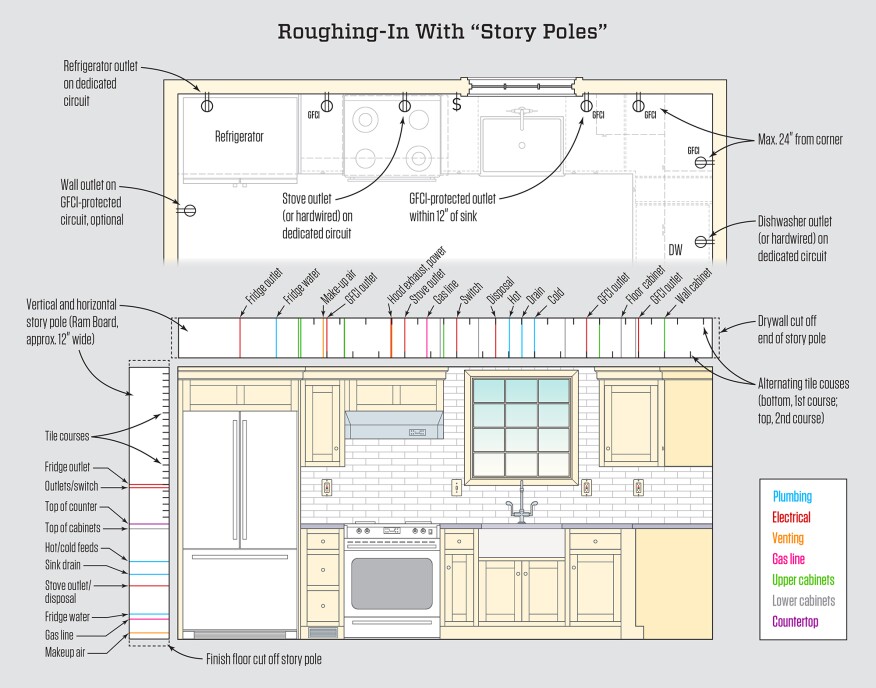

On top of building codes requiring things like outlets, each stationary appliance in the kitchen has mechanical needs of its own. And those needs must be met within the confines of the cabinet layout. Large-scale commercial and institutional projects will have mechanical-electrical-plumbing (MEP) drawings done by an engineer that lay out all the mechanicals and how they interact and share space. While that doesn’t typically happen on residential jobs, the information is no less important.

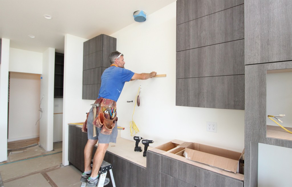

My go-to method for communicating this on a residential jobsite is to use a 12-inch-wide rip of cardboard floor-protection material cut to the length of each kitchen wall as a story pole on which I mark the layout for each cabinet box, appliances and their associated mechanicals, and tile (if necessary). This horizontal story pole is stapled level across the wall above the highest mechanical, and each trade plumbs their layout down from the story pole. Each wall also gets a vertical story pole cut from a rip of plywood to show the layouts from the floor up—top of base cabinet, top of counter, range hood, bottom of upper cabinet, undercabinet light wiring, and the like. I color-code the different items using markers or colored pencil. The cardboard story poles can be taken down, rolled up, and stored as they become living documents that guide the work from rough framing through to install. The horizontal story pole is created pre-drywall, so each end has the thickness of the drywall marked on it. Once the drywall is installed, this section is cut off the story pole. Finish floor is dealt with the same way on the vertical plywood story pole.
The story poles can have as much information as the lead carpenter and the mechanical trades deem necessary. I use this method for bathroom layout, as well, and have had plumbers comment that seeing the tile layout marked out is helpful in fine-tuning placement of showerheads and mixing valves. Wall-mounted faucets, outlets, and lights can be given the same center-of-tile or center-of-grout-joint layout on the kitchen story pole (see Roughing-In With “Story Poles,” below). Executing layout in this detail early on, though a time-consuming task, can save the lead carpenter time throughout the job when the mechanical trades buy in to the method and understand that they can rely on the story pole in the same way they rely on MEP drawings.

Residential kitchen design plans typically consist of only plan and elevation views like these; they seldom have a separate mechanical-electrical-plumbing (MEP) plan, though kitchens often have a convergence of MEP components that must be precisely integrated with cabinets, appliances, tile, and trim. The author uses color-coded story poles, cut from heavy floor protection paper, that can be taken down, rolled up, and stored as they become living documents that guide the work from rough framing through appliance install. The author takes the time to develop these story poles so he is able to keep track of fine-grained detail like the tile layout at the framing and electrical rough-in stages.
Click to enlarge

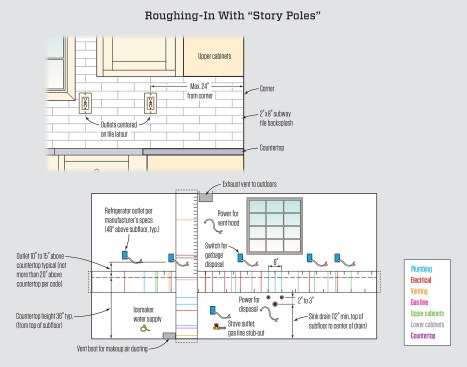

The illustration above shows the color-coded “story poles” are stapled to the wall to provide a laser-level reference for all the on-center spacing measurements of the MEP components.

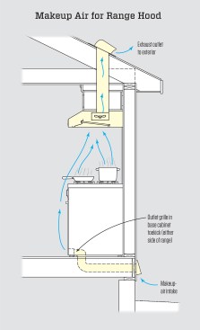

Makeup air is required for any range hood that exhausts more than 400 cfm. On some jobs, we’ve felt lucky to have makeup air supplied to the kitchen or an adjacent space via an ERV that lets in tempered air. The HVAC contractor takes the exhaust hood into consideration when sizing the ERV, but otherwise, the kitchen plan is not impacted. On many jobs, however, the energy-efficiency afforded by an ERV, which tempers the incoming fresh air with heat from the outgoing exhaust, is not always as high on the priority list as the kitchen finishes. We often end up having to bring in unconditioned makeup air, and the placement of this inlet needs careful attention to avoid a stream of cold air blasting the cook when the range hood is turned on.
Click to enlarge
When makeup air is required for a kitchen range, the author prefers to bring fresh air in near the base of the stove. As fresh air is pulled up the exhaust fan, it creates a negative pressure zone on the cooktop that helps pull pollutants into the exhaust stream.
Typically, we locate the register for the makeup air near the floor on the wall behind the range, or in the floor under the range towards the back. This keeps the air stream away from the cook, and as it is pulled upwards by the exhaust fan and passes the cooktop, the airflow picks up air off the cooking surface—an effect called “entrainment”—that helps exhaust pollutants and moisture generated by the stove and cooking activity. The makeup-air inlet should include an electric damper that opens and closes to keep unconditioned air from leaking into the house when the range hood is not in use (see Makeup Air for Range Hood, above). Typically, this damper is wired to the switch that controls power for the range hood.

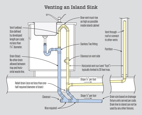

Drain plumbing often takes precedent over supply lines to guarantee adequate pitch and venting. The widespread use of PEX for plumbing supply lines has both made the work of the plumber easier and simplified the work of the lead carpenter or designer tasked with making an increased quantity of mechanicals fit without compromising in-cabinet accessories.
Kitchen drain lines must be low enough to fit a disposal. Most codes will limit the height to 12 inches minimum off the floor. The vents for sinks in islands can be challenging in a very large kitchen. Most codes require that a sink be no farther than 8 feet from a vent, so there may be only a small wall area through which to run the vent stack that intersects within an 8-foot radius from the sink drain. Automatic undercabinet vents or oversized drain lines typically are not allowed by code as vents. Bow vents are often the only option for large kitchens in which a vent stack needs to more than 8 feet away from the sink. I recommend that you work with your plumber early on to find out exactly how much cabinet space the vent will take up. Also, the plumber may need to get prior approval from the inspector. The inspector will be looking for two key features with a bow vent—a tie-in to the vent stack in the wall that is higher than the sink overflow height (usually 36 inches on a standard-height island) and a relief drain on the vent running through the floor. If a blocked sink drain ever fills the bow vent with water, the relief drain will drain away the water so the vent stays operational.
Click to enlarge
In most code jurisdictions, the only venting option for an island sink is often referred to as a bow vent. The length of the vent “foot” (horizontal section in the floor) is typically limited to 20 feet.
Electrical. Selecting appliances early in the process eliminates assumptions made by all the trades. In terms of the project budget, assuming that the electrical service of a house built in the 18th century has been updated so that it can handle modern appliances can lead to an unwelcome change order at a point when most budgets have been maxed out. Partnering with an electrician early in the design phase is helpful not only for evaluating panel capacity but also with reviewing requirements of the building code.
[Editor’s note: Since publication of this article, electrical outlets are no longer required in kitchen islands or peninsulas under the 2023 National Electric Code (NEC). When they are installed in an island, they can no longer be below the surface of the countertop or work surface.  For more on this rule change, see Rule Change for Kitchen Island Outlets.]
Section E3901.2 through E3901.5 of the IRC can be used as a guide by a lead carpenter for laying out other mechanicals and even wall tile. E3901.4.5 states “outlets shall be locate not more than 20 inches above the countertop,” giving a lead carpenter room to coordinate the tile selection with the outlet location. This finish detail, and the client who demanded visual perfection, was the genesis for the story-pole method I described above. E3901.4.1 “Wall Countertop Space” states: “A receptacle outlet shall be installed at each wall countertop and work surface that is 12 inches or wider. Receptacle outlets shall be installed so that no point along the wall line is more than 24 inches, measured horizontally, from a receptacle outlet in the space” (see again Roughing in With a “Story Pole,” above).
There are exceptions to this, outlined further on in the code, that include drawings in the explanation. Receptacle requirements for kitchen islands have changed to accommodate the ever-increasing size of island work surfaces. The code now calls for one outlet for the first 9 square feet, or fraction thereof, with an additional outlet required for each additional 18 square feet, or fraction thereof. At first glance, this may not sound like much, but many large islands and peninsulas will now require three outlets to satisfy code (see Island Receptacles, below).
Click to enlarge
The number of outlets on an island counter depends on the countertop area served. If a vertical surface exists above the countertop, the outlets must be placed there, and are not then allowed on the cabinet.
