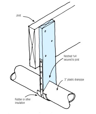

Support materials. Wire or metal plumber’s tape is not recommended for pipe support, and may be restricted by code for plastic drain lines.
When hanging pipe, best practice calls for using a solid material, such as notched 1-by or approved pipe hangers from a plumbing supply house (Figure I). Solid hangers resist upward thrust and vibration, thereby providing more secure support, while also helping to quiet drain lines. Wrap the pipe with insulation at each pipe support to further dampen vibration.
A flexible support, such as wire, should not be used to support plastic drain lines. Instead, use a notched 1-by wrapped with rubber or other insulation, as shown here.

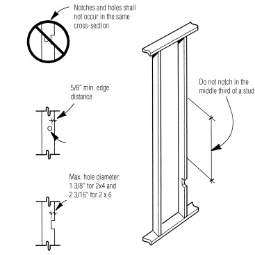

Notching and Boring Studs and Joists
For notching and boring framing to accommodate plumbing lines, it’s critical that plumbers follow the guidelines shown for lumber joists (Figure J), engineered wood I-joists (Figure K), regular studs (Figure L), and engineered studs for tall walls (Figure M).
When using plastic piping (PVC or ABS), install nail guards where lines run near the surface of studs or joists.
Figure J: Notching and Boring Lumber Joists
Joist Size Max. Hole Max. Notch Depth Max. End Notch
2×4 None None None
2×6 1 1/2 7/8 1 3/8
2×8 2 3/8 1 1/4 1 7/8
2×10 3 1 1/2 2 3/8
2×12 3 3/4 1 7/8 2 7/8
For all calculations using the value D (depth of joist), use the actual, not nominal, dimensions.

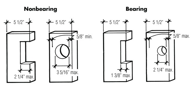

Notches in loadbearing walls under 10 ft. tall should not exceed 25% of stud depth. Bored holes should not exceed 40% of a loadbearing stud’s depth and should be at least 5/8 in. from the edge.
Dimensions shown here may not apply to all engineered materials. Consult specific manufacturer’s specs for notching and boring guidelines.

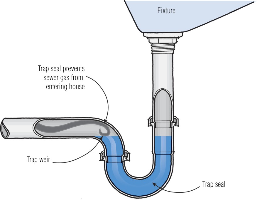

Traps
A trap — the bend in the drain below every plumbing fixture — creates a water seal that blocks sewer gases from escaping into the house (Figure N). A vent prevents the trap water from siphoning away. Vents maintain equal air pressure on both sides of the trap seal. This keeps negative pressure from building up so that a slug of water running down the drain doesn’t pull the trap water out with it (Figure O).
Standard P-trap: All drain traps should have a short horizontal leg before turning down or merging with a drain stack. S-traps are not allowed. With adequate venting, the leg prevents the slug of water from siphoning off.

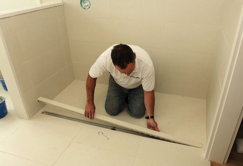

Tub and Shower Traps
Most fixtures should be made accessible. The common exceptions are bathtub and shower traps, which may be concealed. However, these fixture traps must be made of approved materials and may not be equipped with a cleanout. (Cleanouts must always be accessible; see Cleanouts).
While best practice calls for keeping the trap as close as possible to the fixture, most code inspectors will allow a maximum of 30 in. horizontally from sink outlet to trap inlet to get around framing obstacles (Figure P). However, be sure to check with your local official. Also, there are offset tub drain-overflow assemblies with side or rear outlets that may help overcome framing obstacles.

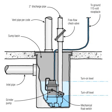

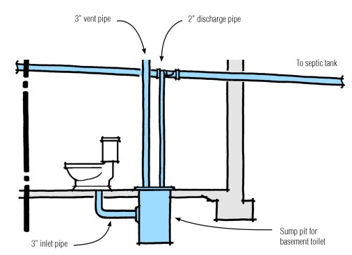

Ejector Pumps
A basement toilet that has a discharge outlet below the house main drain will require a sewage ejector pump specifically designed for lifting effluents to the drain line (Figure T). A typical installation consists of a drum-shaped plastic or metal reservoir, or sump, which receives discharge from a toilet, tub/shower, and lavatory. Inside the sump basin, which holds about 30 gallons of effluent, is a specially designed pump triggered by a float mechanism. The unit churns the waste and periodically pumps it to the main drainpipe as needed. This churning is loud, so avoid positioning the ejector pump near a bedroom or study.
The sump basin receives wastewater from bathroom fixtures. A grinder pump liquifies the sewage and pumps it up to the main drain line that exits the house. A check valve prevents gravity backflow into the basin.
Drainage and vent. The sump pit will require two pipes at the top: a high-pressure discharge pipe, usually 2 in. in diameter, and a dry vent pipe, usually 2 to 3 in. in diameter (Figure U). To connect the vent, try to find a dry vent in the house plumbing and tap into that, or run a new vent to the roof.
Sealing. After the ejector pump is installed, seal all openings around the sump pit with hydraulic sealant or caulking to prevent any radon or groundwater from entering the basement. If radon is an issue, be extra careful to properly seal these and other penetrations through the basement floor. (For more, see Radon Abatement.)
An option worth considering is an alarm system, which monitors the basin level. An integral float furnished with the pump provides automatic on/off action in response to usage. If the pump does not cycle, an audible alarm sounds to warn against usage until the system is checked.
Basement bathrooms may require an ejector pump to lift effluent to the main drain. The ejector pump does not have to be installed in a sump pit below the floor. Kits are available that allow an above-floor installation.
