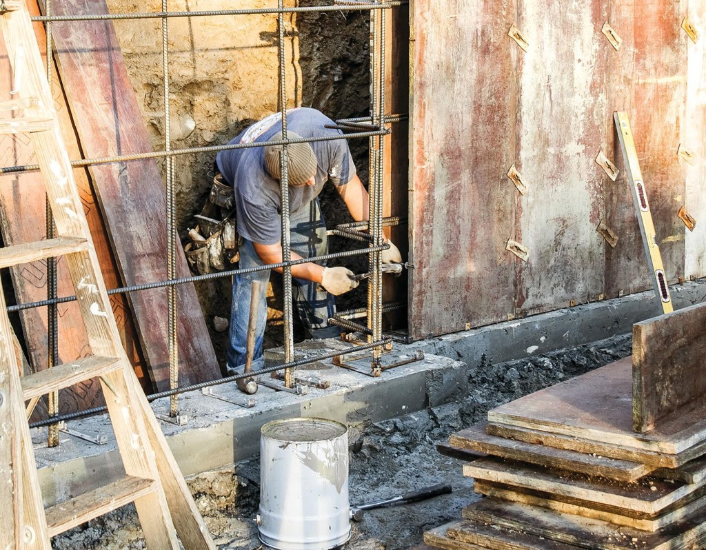

Reinforcing Concrete Walls
Follow general guidelines for reinforcing foundations (see Rebar).
For appropriate sizing and spacing of rebar in concrete foundations, follow the minimum code requirements shown in Figures in Sizing and Spacing in Walls.
Rebar should always be placed near the tension side of the concrete (see Placing Foundation Rebar). On a full-height foundation wall, which is held in place by floor framing at the top and by the footing at the bottom, the tension side is toward the inside (Figure: Rebar for Poured Foundation Walls in Placing Foundation Rebar)
Horizontal rebar is most effective along the top and bottom of the foundation elevation.
