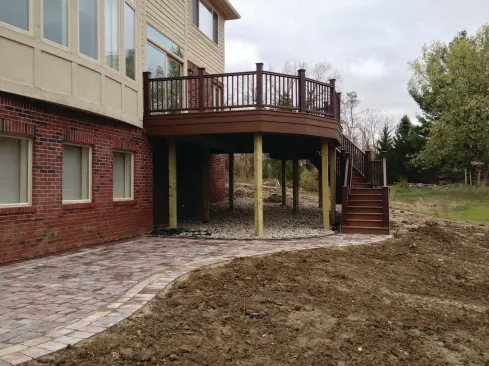

When I meet with homeowners to discuss their deck projects, a topic that comes up over and over again is the appearance of the posts that will support the deck. One concern is that the posts will look unfinished compared with the finishes on the rest of the deck. In addition, many clients complain that decks often look like they’re supported on stilts, particularly when the framing is more than a few feet above grade, such as when the deck is built over a walk-out basement. And I agree with them: Even though 6×6 support posts are structurally adequate for most decks, they can look skinny and out of proportion on a tall deck.

The most common and least expensive approach is to clad 6×6 support posts the same way we typically clad porch posts—using 1×6 stock on two sides of the posts and 1×8 stock on the most-visible faces. We orient the cladding this way so that the joints on the corners will be less apparent. Cedar or other stock that comes in 1×6 and 1×8 widths doesn’t normally need to be ripped. But the faces of nominal 6×6 posts can measure anywhere from 5 1/2 inches to 5 3/4 inches, so in some cases we need to use 1×8 stock for all four sides and rip it to fit, slowing down the installation considerably.
Usually we wrap the posts with the same material that’s used for the decking. Many of our decks are cedar, which is more affordable than synthetic decking in our area and can be stained to match the house trim. The cladding can be stained after it’s installed, but it’s better to pre-stain it so that all the sides have a finish on them.

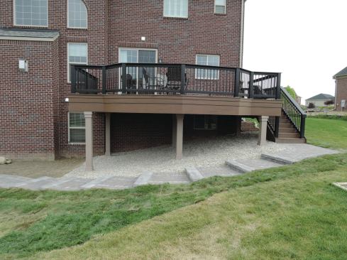

Most synthetic-decking manufacturers offer matching 1×8 riser fascia and 1×12 rim fascia, so we simply rip the 1x12s in half to make two 1x6s for two sides of a 6×6 post (TimberTech fascia measures a full 12 inches wide, while Azek and Trex fascias measure 11 1/4 inches). We oversize the 1×6 rips by at least 1/16 inch to make sure they cover plus-sized posts. The 1×8 riser fascia works perfectly for the other two sides because it has factory edges that cover the ripped sides of the 1x6s.
To create an even more substantial look, we sometimes clad posts with full 1×12 rim fascia on all four sides. For proper nailing, it’s necessary to add blocking to each side of the 6×6 support post, usually on 16-inch centers to meet manufacturer requirements.
Fasteners. The fastening details we use depend on the material that we’re working with. With cedar, for example, we nail the cladding together and to the posts with 2- or 2 1/2-inch galvanized finish nails 16 inches on-center, reinforcing the corners with PL construction adhesive. If we’re using capped composite stock, we predrill and countersink the holes and fasten the cladding with Starborn Headcote screws in matching colors. With PVC, we tack the stock in place with brads, then go back and fasten everything together with either FastenMaster Cortex screws (for white trim) or Headcote screws (to match colored trim).
Top and bottom detail. In most cases, we start our cladding a few inches above grade and run it up to the bottom of the beam, since both the bottom and top of the post will be trimmed out with tiered trim to match our stacked fascia detail. We build out the tiers with a 1×8 base followed by a second 1×4 cap. Depending on the decking material, we typically will use one 1x12x12 rim fascia and three 1x8x12 riser fascias per post. Depending on the height of the deck, we sometimes can use cut-offs for the tiered top and bottom post trim, resulting in one less 1×8 per post.

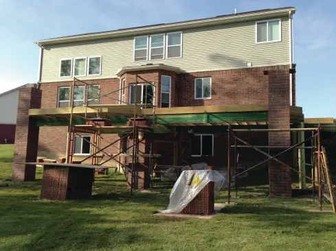

Brick and stone veneer are other cladding options we offer. These columns require a larger pier footing and a good masonry subcontractor to build them, so they’re considerably more expensive than other choices. Still, I like mixing synthetic decking products with brick or stone columns, and apparently so do our clients: This is our most requested deck support detail.
The most efficiently built masonry column sizes are 20 inches by 20 inches or 24 inches by 24 inches, so the footing must be designed to fully support the brickwork. We simply oversize the footings, digging the large holes with an auger mounted on a Toro Dingo mini skidsteer. While some masons lay up their brick around steel supports, ours prefers standard 6×6 PT posts, which he says are easier to fasten his brick ties to.
The cost of a masonry column varies a lot, depending on height and the brick or stone being used. A ballpark figure that I use with my clients is $1,200 to $1,500 for a 10-foot column with a 20-by-20-inch footprint, which includes the oversized pier foundation.
