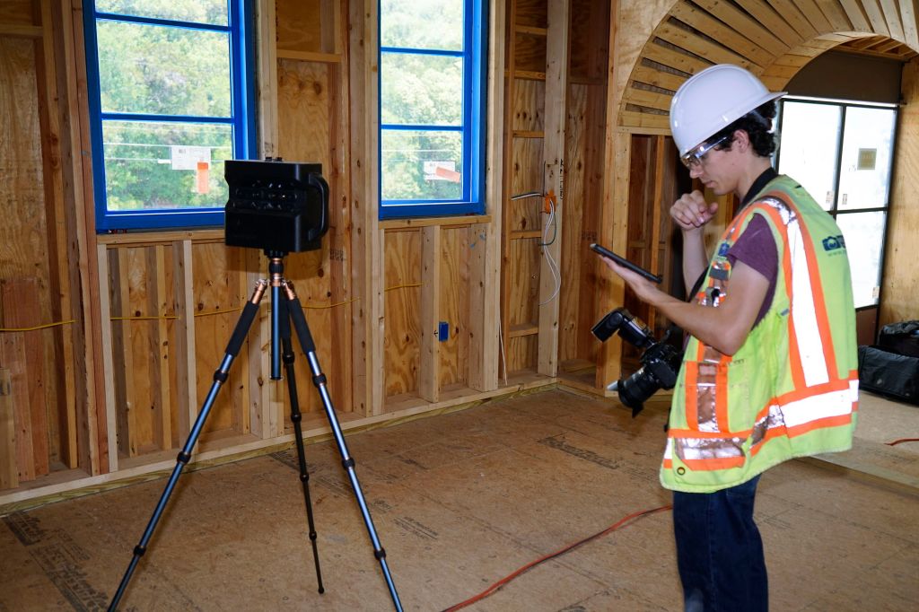

A Multivista technician uses a Matterport scanner and an iPad to create an accurate, photo-realistic virtual model of a Risinger Homes building under construction in 2018. At the same time, the tech is taking hi-resolution still photos of some locations, which can be keyed to the virtual model of the building.

This photo shows a technician for Multivista, a construction documentation firm, creating a three-dimensional photo record of a house under construction by Risinger Homes in Austin, Texas. JLC went to the job for another reason, but when we saw the Multivista crew at work, we got curious. So we sat down with John Whitton, a Multivista contractor in the Austin market, for some explanations. (Whitton can be reached at [email protected] or 512/963-7455).

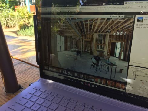

Multivista contractor John Whitten logs onto a project model over wi-fi at a coffee shop in Austin, Texas. The interface gives password-protected access to project documentation anyplace where there's an Internet connection.
That inspiration grew into Multivista, a franchise operation with dozens of franchisees around the United States and in Europe. With two co-managers and seven photographers on staff, Whitton's franchise now handles the market in Austin and San Antonio. "We offer a product and a service," said Whitton. "Our product is our online platform where you can access the photos, you can add your own photos, you can share the photos, you can email them, you can send links to people with any number of photos attached to that link, so they can only see those photos."
