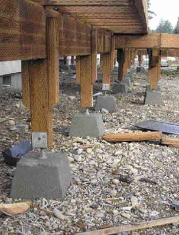

When I asked Jack Hanson of Woodpile Products in Boise, Idaho, what his biggest consideration with footings was, he replied, “To put them under the beam.” Humor aside, compared with those of us in the Northeast, Hanson has it pretty easy with footings. Because it’s so dry in Boise, the frostline is only 12 inches deep despite the cold winters.
For low-level decks, Hanson uses precast concrete piers he buys locally. To level them easily, Hanson fills the bottom of the footing hole with 2 to 3 inches of pea gravel.
One big advantage of the piers that Hanson uses is the integral Simpson EPB44T post base (Figure 1), which can be adjusted in height over a range of 2 1/2 inches. On very low decks, it’s possible to skip the posts entirely by resting the beam directly in the saddles of these post bases.
Figure 1. Footings incorporating a Simpson EPB44T post base can be adjusted up to 21/2 inches in height by turning the nut below the post base.
