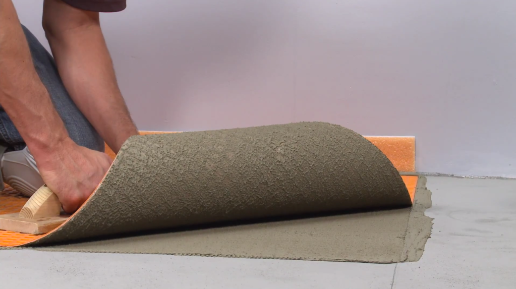

3. How do I achieve proper thin-set coverage?
Full thin-set mortar coverage is essential for ensuring a secure bond and support for the tile.
There are three steps to this:
Step 1: Ensure correct mortar consistency When installing DITRA, ensure the thin-set mortar is mixed to a fairly fluid consistency, but still able to hold a notch. If the mortar is too thick, it may not transfer to the bonding fleece under the DITRA as required.
Step 2: Mortar application Apply thin-set to the area where the DITRA is to be installed, using the correct trowel size: ¼” x 3/16” (6mm x 5mm) v-notch OR A DITRA trowel: 11/64” x 11/64” (4.5mm x 4.5mm) square-notch.
Apply a thin layer of mortar with the flat side of the trowel, to produce solid contact with the substrate. Then comb additional mortar using the notched side of the trowel. When combing mortar, hold the trowel at a 45-degree angle. If pulled at a lower angle, this can mean less mortar in place, resulting in poor coverage. Combing the mortar in one direction also helps, making it easier to collapse the mortar ridges when embedding the DITRA.
Step 3: Embedding the DITRA First, apply the DITRA fleece-side down and solidly embed using a float or a DITRA roller. Make sure to observe the open time of the thin-set. If the mortar skims over, remove and reapply before installing the membrane.
Next, lift up a corner to check coverage. You should see full contact between the fleece-webbing and the thin-set mortar. Re-embed the DITRA.
If full coverage has not been achieved, remove, verify proper mortar application and reapply the DITRA membrane. More information here.
