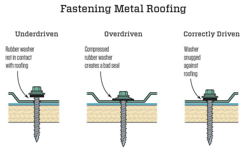

Today the fasteners of choice for corrugated roofing are gasketed hex-head screws with a metal and rubber washer below the head. As the screws are driven, the washer presses against the metal roofing to form a waterproof seal. If the screws are driven correctly, fastening through either the valleys or the ridges of the roofing is considered acceptable in this country. Valid arguments can be made for both preferences. If the fasteners on your roof were all properly driven, it is unlikely that they are the source of your leaks, regardless of whether they were driven through valleys or ridges.
No matter what fastener location your installer prefers, there are several factors to consider when fastening metal roofing to a building. Be sure to choose the right fastener—the right length as well as the right material—for your particular application. Roofing manufacturers often recommend certain fasteners and fastening schedules for their products according to the structural material of the roof. Each fastener must be driven straight into the metal roofing perpendicular to the plane of the roof to ensure that the washer seals evenly around the fastener hole. Also, fasteners should be driven using a properly adjusted torque-sensitive tool to avoid overdriving (see illustration). Applying too much torque when fastening through the ridges could crush or distort the profile of the roofing, and applying too much torque in the valleys could distort the washer to the point where it no would longer create an effective seal.
