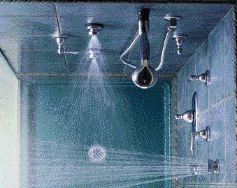

The rise of the multiheaded custom shower, or “vertical spa,” proves once again that two heads are better than one — and, further, that six heads are unbelievably great. Odds are good that you’ll be discussing this kind of shower as an upgrade with a client sooner or later. When you do, keep in mind that you can’t simply modify an existing shower by adding more heads; custom showers require fundamental plumbing changes. When it comes to equipping a multihead shower, there are just a few too many choices to keep things simple.
Start With Water Pressure
They’re called spray heads for a reason: Feeble, drooling shower nozzles are not the objective here. So adequate water pressure is a basic requirement — manufacturers recommend 45-psi minimum pressure, with 50 psi preferred for optimal performance.
Before you commit to upgrading or remodeling an existing shower, have your plumber gauge the dynamic (running) water pressure. Or you can perform a simple flow evaluation by timing how long it takes to fill, say, a couple of 5-gallon buckets from the existing shower (remove any flow restrictors first). This will give you a fairly accurate flow rate in gpm.
Note that a point-of-entry water softener can inhibit hot water flow — if hard water treatment is essential, so is a high-volume unit to ensure sufficient shower pressure. If the water pressure’s too low, corrective measures, such as a booster pump, may be necessary. Also, a private well or cistern may simply not have the capacity to keep up with the water flow demands of a multihead shower system. Make sure your plumber looks at the entire system before designing and quoting a multihead remodel.

It’s estimated that a custom shower with four flow-restricted outlets can use 6.25 gallons per minute in hot water alone. Consider, too, that a custom shower or preconfigured module can easily include a main head, or two main heads; four, six, or more body sprays; and a hand-held spray. Thus, most valve makers recommend a minimum 100-gallon water heater for a custom shower application.
Supply lines. Given adequate system pressure, 1/2-inch lines can effectively serve a “high-flow” 3/4-inch valve, although 3/4-inch supply lines are the preferred standard. The overarching design factor is the number of outlets per mixing valve. Mixing valves have stated flow capacities, and shower heads, as we know, are rated at 2.5 gpm. If you’ve already determined the existing gpm delivery, just do the math. This will tell you whether a supply line upgrade is in order.
If the number of outlets exceeds the capacity of a single thermostatic valve, it’s necessary to add another, according to the total outlet flow requirement. Each valve should be home run from the main to avoid possible fluctuations in flow and temperature. This makes it easy to isolate the lines for occasional valve servicing. Also, when more than one valve is used, it’s a good idea to bump the home-run supply lines up to 1 inch to maintain peak pressure delivery.

In the truly custom multihead shower, the mixing valve controls only water temperature, while separate volume controls regulate the flow at individual outlets (or groups of outlets). That’s why you see so many extra knobs in photos of custom showers. Volume controls should also be 3/4 inch. You can use 1/2-inch controls, but keep in mind that you’re limiting flow to 8 gpm at 45 psi and design accordingly.

Custom showers typically include one or more fixed-position heads, often with an adjustable spray pattern. There are many to choose from. Body sprays are generally fixed in the below-the-shoulder zone and can range from a fine spray to pummeling massage jets. Volume controls play a vital role in varying body spray output and function.

It’s best to assume that a single 2-inch drain is designed to handle only a single outlet, so be prepared to upgrade the existing drain line. Depending on the number of spray outlets and their combined flow, one 3-inch or two 2-inch drains is recommended to keep pace with the higher water output.
