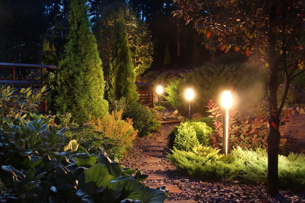

Lighting suppliers like North Dakota–based Border States offer guidelines on dark-sky compliant fixtures. These are essentially full cutoff fixtures, meaning they emit light only below a horizontal plane, thus minimizing light trespass and glare. The IDA maintains a Fixture Seal of Approval program certifying fixtures according to these guidelines including the minimization of cool-temperature light (which is particularly undesirable as it is most closely associated with the mid-day sun). Examples of IDA-approved lighting include Dark Sky Luminaires from Hillsboro, Ore.–based Ligman Lighting. The company’s Arizona Light Column exemplifies its “Turtle-Friendly Amber LED” approach, providing warm-spectrum illumination within a confined radius so as not to confuse sea turtle hatchlings attempting to navigate by moonlight.
Existing outdoor light fixtures can also be modified to limit light trespass by using light shields. For example, Ferguson offers the Nightsaver Collection of shields that deliver full cutoff illumination. Parshield manufactures a clip-on visor for floodlight and spotlight PAR-38 bulbs installed outdoors. According to the company, residential lighting, the product’s primary application, is responsible for up to 45% of light pollution. Light shields can ensure that illumination is delivered to the desired areas, minimizing light trespass and glare.
