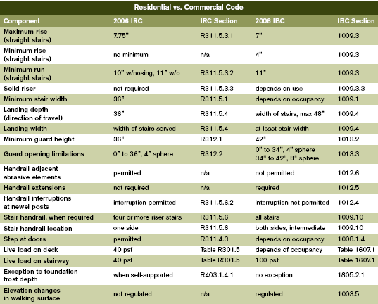

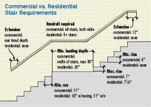

One aspect of deck construction that varies considerably is the geometrical limitations of stairs and stairways. When considering stairway requirements, keep in mind that a single change in elevation is considered a stair and requires a top and bottom landing; a stairway consists of all stairs and landings required to traverse from one floor level to another.
The general rule for commercial-use stair runs is a minimum 11-inch run, measured from tread nosing to tread nosing (see illustration). Width of a commercial stairway is based on total occupancy and whether the stairs are part of the accessible means of egress. Residentially, a simple 36-inch minimum width is required.
Many of the differences between residential and commercial codes surround stair geometry.
Landing depth is measured in the direction of travel, generally perpendicular to the last tread. In commercial applications the depth must be at least equal to the stairway width, but need not be greater than 48 inches.
Guards in commercial settings are required to be 42 inches high. The “4-inch-sphere rule” for the maximum size of an opening applies only up to the height of 34 inches. For the top 8 inches of the guard, between 34 and 42 inches above the deck, the maximum size of an opening is larger — it can’t allow passage of an 8-inch sphere.
If the stairway handrail is mounted on or adjacent to a brick or stucco exterior or any other “abrasive surface” it may be considered a violation of the IBC.
The IBC requires handrail extensions at the top and bottom of stairs when the handrail doesn’t connect to the handrail of a lower or upper set of stairs. The top extension must extend horizontally for a minimum of 12 inches beyond the top rise and the bottom extension must extend sloped beyond the last tread for a horizontal distance equal to the tread depth.
In addition to the requirement for handrails on both sides of commercial stairways, there are times when an intermediate or center handrail may be required. Based on the minimum required width of a commercial stairway, as dictated by occupant load, no portion of that width can be more than 30 inches from a handrail. This means that if the minimum width for a stairway is 61 inches, an intermediate handrail is required.
Live loads that must be resisted by structural elements can significantly affect the size of material selected for the project. For the deck, the minimum live load at commercial establishments depends on the type of occupancy the deck serves. In most commercial jobs, including restaurants, stairway minimum live loads are 100 pounds per square foot, more than 100 percent greater than the minimum load of 40 psf for residential decks.
For the foundation or piers supporting the deck, there is a convenient exception to depth below frost in the IRC: In residential applications, if the deck is not supported by the dwelling, such as with a ledger, then the foundation is not required to extend below the frost depth; this exception does not exist in the IBC.
Though changes in elevation on residential decks are not generally restricted, there can be many factors that restrict changes of elevation on commercial decks. While multi-level decks are attractive to homeowners, in public settings they may create safety hazards and limit occupant mobility.
