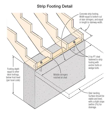

There are several ways to meet this requirement, and if you live in an area that has a frost-free climate or that has the type of well-drained soil that doesn’t expand when frost occurs, a 4- to 6-inch-thick concrete slab landing might be the simplest option (if approved by your local inspector). Otherwise, my favorite approach is to pour a concrete strip footing that is at least the width of the bottom cut of the stair stringers (about 10 inches), the same length as the width of the stairway, and the same depth as the other deck footings (below frost level) (see Strip Footing Detail, below). While this might sound like a lot of concrete, it’s not a lot more than if you were going to dig three or four 10-inch-square or 12-inch-diameter footing holes (per DCA6) next to one another, and it eliminates the problem of dirt from the closely spaced holes caving in on the others. (For more on floating vs. fixed footings, read “Deck Stairs on Frost Footings” at deckmagazine.com.)
Instead of using individual concrete piers to support each stair stringer, the author prefers to dig and pour a monolithic strip footing, which is sized to extend below frost depth and fully support the stringers’ seat cuts. The stair stringers are locked to the footing by a PT cleat anchored to the concrete.

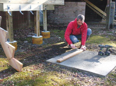

To provide an anchor point for connecting the stringers to a footing or an integrated footing and landing, I secure a 2x4 (or larger) PT cleat to the concrete, either with cast-in-place HDG J bolts installed during the pour or with expansion anchors that can be installed after the concrete is cured. The 2-by has to align with the front end of the stringers, so it helps to cut the stringers before casting the footings and landing so that you know exactly where to dig. In that case, I install 1/2-inch-diameter generic HDG J-type anchor bolts when I pour the footing. If for some reason I’m not certain of the stringer layout, the cleat can be fastened to the concrete with expansion anchors (either ITW Red Heads or Simpson Strong-Tie anchors are typically stocked at the yards near me) after the concrete has cured.

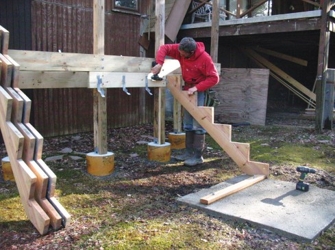

After laying out and cutting the stringers but before installing them, I stack them up and bore a 9/16-inch-diameter hole 2 inches down from the top of the tread cut and 2 inches in from the riser cut. Later, I’ll run a 1/2-inch-diameter threaded rod through the holes; drilling the holes before installing the stringers ensures accurate hole alignment.
I cut 1 1/2-inch-by-3 1/2-inch notches at the bottom of the center stringers so that they will fit around the 2-by cleat, and toe-screw them down with framing screws. The two end stringers don’t need to be notched—they are simply screwed to the ends of the cleat with structural screws.

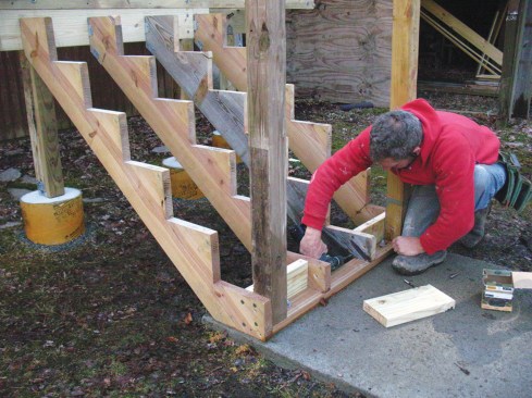

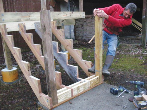

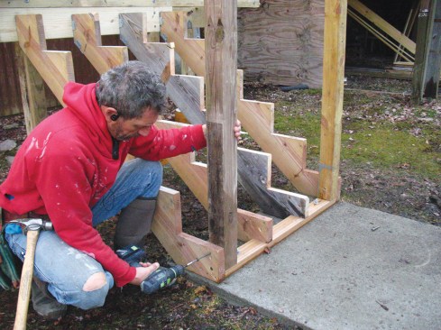

Once the stringers have been fastened to the footing cleat, the 4x4 PT guard posts can be mounted to the outer stringers. On the job shown here, I mounted the posts inside the stringers, but with this system, it is possible to mount them on the outside of the stringers. To hold the posts in place while I install blocking and the threaded rod, I fasten them to the stringers with a couple of 4 1/2-inch-long structural screws. I plumb them in line with the stringers; in the final step, I adjust the camber of the posts.
The author screws the guard posts to the stringers.

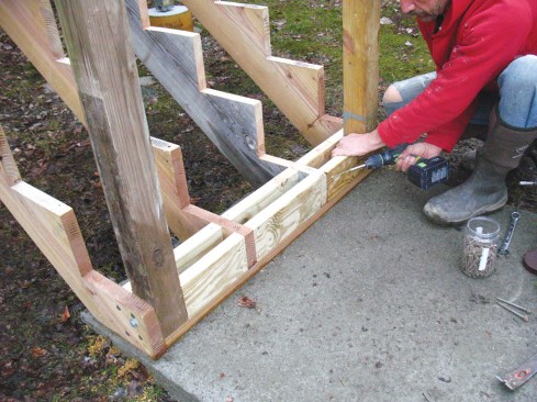

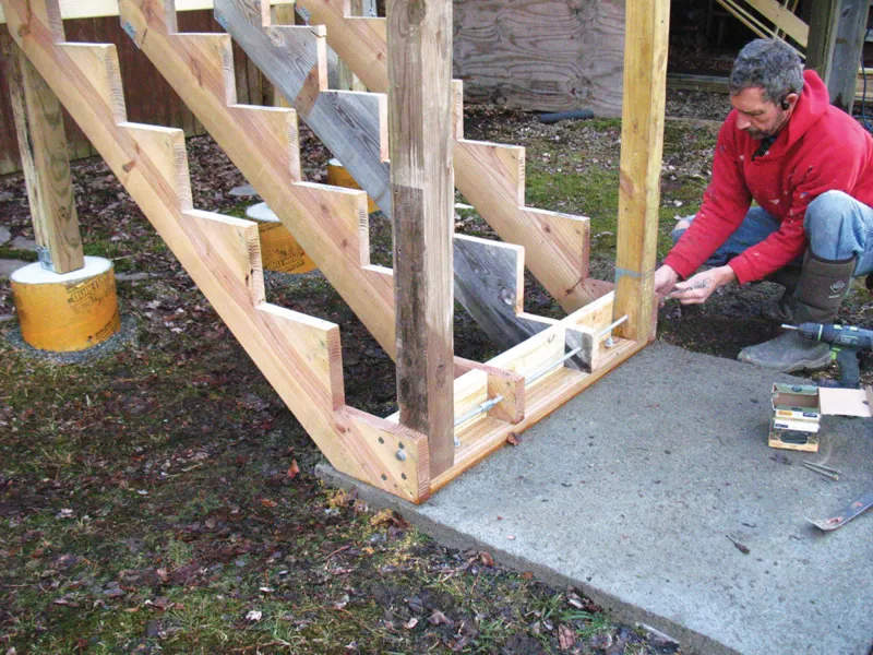

Next, I install a row of blocks ripped to the height of the stringer from footing to tread cut. The blocks are positioned behind the guard posts in a straight line and fastened through each stringer with 5-inch structural screws about 11/2 inches up from the bottom of the stringer and down from the tread cut. I also drive additional 4-inch screws through the back of the blocks into the 2-by cleat.
After the posts are in place, the author installs a row of blocking that fits tightly between the stringers.
Using straight 4x4 PT stock for the stair posts and cutting the posts and PT blocking to length on a sliding compound miter saw ensures that all of the components are square. So even before my final adjustments, the posts are close to plumb.

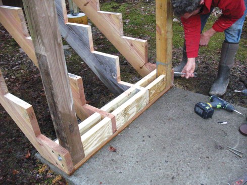

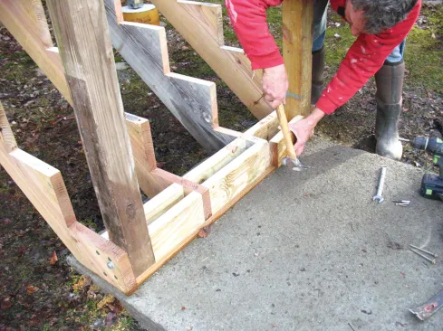

Using the prebored holes in the outside stringers as a guide, I drill a 9/16-inch-diameter hole through the 4x4 posts, then run a 1/2-inch-diameter HDG threaded rod through the stringers and blocks. When long rods aren’t stocked locally, shorter lengths can be joined together as needed with 1/2-inch HDG threaded couplers. With nuts and washers installed at each end, I snug the rod up, but I don’t tighten it down yet.
A 1/2-inch-diameter galvanized threaded rod that fits through prebored holes in the posts and stringers ties the assembly together.
Next, I install a second row of blocking aligned with the front of the risers and on top of the cleat, fastening the blocks with structural screws or framing screws. (When the posts are positioned outside the end stringers, the first blocks run from stringer to stringer, rather than from post to stringer, as on this job.) Another variation I’ve tried is to cut 1 1/2 inches off the riser face of the intermediate stringers so that a single block can be installed from one end to the other.
A second row of blocking, aligned with the front of the stringers, reinforces the assembly.
The blocking is screwed to the stringers.
Finally, I tighten down the end nuts and trim off the excess rod, coating the cuts with a rust-prohibiting coating. Tightening the nuts can cause the posts to camber inward. Final adjustments can be made by loosening the nuts, inserting shims between the outer stringers and the blocks (or between the blocks and posts), and retightening.
Although it’s not shown in the photos, I also bore 1/2-inch-diameter holes through each block along the front, just above the cleat, so that any water that collects between blocks can weep out.
As the author tightens the rod nuts, he adds shims as necessary so that the posts are plumb.
After assembly, the posts and stringers are locked to the concrete strip footing.
