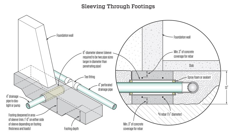

Sleeving Through Footings
A protective sleeve that is two sizes larger than the pipe is required for any pipe that passes through a concrete foundation wall or footing. Depending on the size of the sleeve and the size of the footing, the footing may need to be deepened as shown to provide the required minimum 3 inches of concrete coverage for the rebar above and below the sleeve. The gap between the pipe and the sleeve should be sealed with spray foam or sealant.

Q: We plan to install underslab piping on an upcoming project for drainage. Rather than installing a sump pit inside the basement, we’re hoping to install sleeves in the footing so that the underslab piping can drain to daylight, since the building site is sloped. Does a sleeve cast into a footing weaken the footing?
A: Darren Tracy, P.E., owner of West Branch Engineering in Saratoga Springs, N.Y., responds: Generally, it is not a good idea to sleeve through a footing when it can be avoided. If you must do it, the sleeve is required to be two pipe sizes larger in diameter than the penetrating pipe, per P2603.4 of the 2021 International Residential Code. Presumably, this is to allow for movement in the pipe or the foundation and compensate for imperfect field installations to ensure that the foundation never comes in contact with the pipe and damages it. In this case, for typical 4-inch-diameter drainage pipe, the sleeve would need to be 6 inches in diameter.
That’s a problem with footings formed with 2x10s. Any rebar in concrete that is permanently in contact with the ground requires 3 inches of concrete coverage, per ACI 318-19 table 20.5.1.3.1. The reason for this coverage is that even though the high pH of the concrete provides some protection against corrosion, it needs to be an adequate thickness. Above grade, only 1 1/2 inches to 2 inches of concrete cover is required, depending on the size of the rebar. Assuming 1/2-inch-diameter #4 rebar is used both above and below the sleeve adds another inch that must be accounted for in determining clearances.
Click here to enlarge the illustration above
Without consideration of the specific loads, but based upon the requirements noted, the minimum thickness of the footing would need to be 13 inches: 3 inches of concrete coverage for the rebar underneath the sleeve; the 6-inch-diameter pipe sleeve; 3 inches of concrete coverage for the rebar on top of the sleeve; and another inch for the two lengths of 1/2-inch-diameter #4 rebar. That is a tight dimension with exact placement of the sleeve and rebar. To achieve the added depth, the footing could be deepened in the area of the sleeve, typically a minimum of one foot on either side of the sleeve, depending on footing thickness and loads. As with any penetration through a foundation wall, the gap between the pipe and the sleeve should be filled at both ends with spray foam or sealant to keep stones from working their way into the end annular space between the pipe and the sleeve.
When a pipe penetration in the foundation system is required, it’s better to sleeve the foundation wall instead of the footing, though that solution won’t work in this example because the drainage flow is relying upon gravity and a pitch. Another option is to install a sleeve under the footing. The same two-pipe size increase would apply, and the sleeve would need to be made with a robust material, such as schedule 80 PVC or ductile iron.
