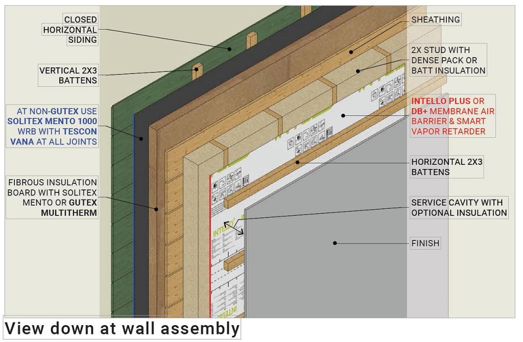

This third book in the series aims at a more mainstream niche: walls framed using ordinary 2x lumber. The assemblies aren’t simple — far from it, in fact: the example wall sections involve built-up layers of interior and exterior continuous insulation and strapping, along with exterior drainage plane and interior vapor control membranes (below). Intersections where walls meet floors or roofs get complicated, not surprisingly. Flashing can be a puzzle. And the foundation, floor, and roof assemblies that round out the package are also pretty tricky to figure out.
