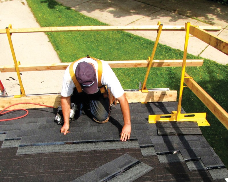

Q. Are there OSHA-specific guidelines for installing and using roof jacks? Is any additional fall protection required when working off properly installed roof jacks?
A. Andrew Wormer, JLC’s executive editor, responds: When roof jacks are properly fastened to the roof according to the manufacturer’s instructions, they add both an element of safety and a useful work platform on sloped roofs. But Peter Barletta, a compliance assistance specialist working out of OSHA’s Boston South Office in Braintree, Mass., says that most of the simple and inexpensive adjustable roof brackets you are probably familiar with aren’t equipped with integral guardrails, and unless they are (as shown in the photo at right), they aren’t a substitute for an OSHA-approved fall protection system. Barletta says that this would typically consist of a full body harness connected to a shock-absorbing or retractable lanyard hooked to a manufactured roof anchor capable of supporting a 5,000-pound load per attached employee. Alternatively, a personal fall protection system with a safety factor of two could be designed, installed, and used under the supervision of a qualified person. Fall protection is always required on roofs where the distance between the eaves and the ground or a lower surface is 6 feet or greater, regardless of the presence of roof jacks.
Fitted with guardrail holders, these roof brackets act as slide-guards and toe boards while providing fall protection.
Acro Building Systems Fitted with guardrail holders, these roof brackets act as slide-guards and toe boards while providing fall protection.
