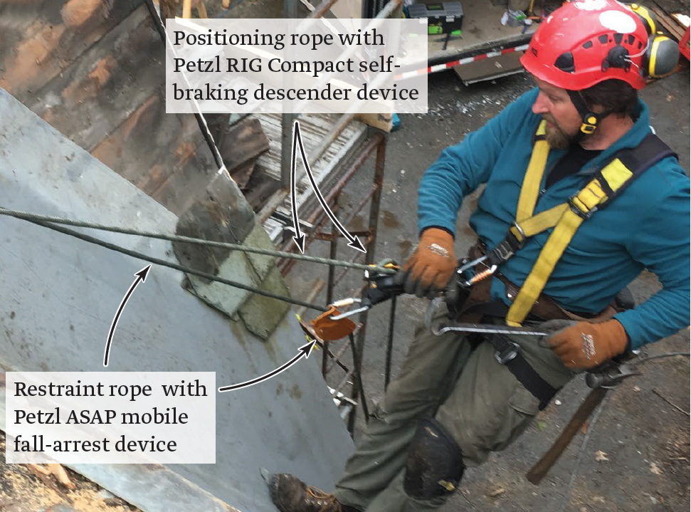

Two-rope positioning. With this system, the restraint rope is the primary fall-arrest protection, shown here attached to the worker with a Petzl ASAP mobile fall-arrest device. A second rope attaches to the worker with a Petzl RIG device. With this device, the worker can lock the rope so he can lean against it, leaving both hands free to work. Separate attachment points for the two ropes allow the worker to triangulate his working position without having to work against one rope or the other.

The two-rope positioning system that I referred to in the article is a hybrid system in which one rope is the restraint rope while the other is the positioning rope (1). These ropes are attached to the roof framing above the worker position by means of separate OSHA-approved connectors. These connectors are attached to separate framing members, usually a few feet apart.

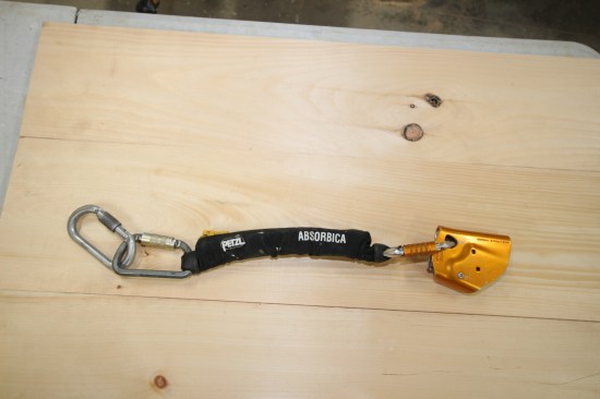

The Petzl ASAP device (gold device at the end) moves up and down the rope as the position of the worker changes.

The restraint rope is the principal fall-arrest or restraint system. We attach the rope to Petzl’s ASAP mechanism, which moves up and down as the worker changes position. But because the ASAP mechanism allows the rope to move relatively freely, the worker can’t lean against it to work hands-free.
If a fall occurs, it locks in position instantly. The RIG device at the bottom allows the worker to lock himself in position and lean against the rope for working with both hands free.

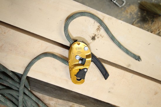

That’s where the positioning rope comes into play. It is attached to a Petzl RIG device that allows the worker to descend and to lock the rope at desired working height. With the rope locked, the worker can lean against it with both hands free for working.
