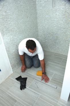

Linear drains have been manufactured for many years, mostly for commercial and industrial applications. In recent years, however, linear drains have been finding their way into our homes, providing a sleek alternative to the ubiquitous circular center drain for shower drainage. In addition to their stylish look, one of the more practical applications for linear drains is for accessible, curbless showers. The single sloping plane required for a shower floor with a linear drain makes for easier navigation and a more stable surface for a wheelchair user than the conical shape required for traditional center-drains.
But usefulness aside, most linear drains are being used in projects by designers and architects as a design element that offers a clean, elegant look for both curbed and curbless showers. The flat plane of the shower floor allows the installation of large-format tile, which expands design possibilities even further. Also, linear drains can be made practically invisible through the use of a tile-top strainer in place of a conventional metal grate or strainer. In this configuration, drain water seems to vanish as it exits through the open grout joints surrounding the drain.

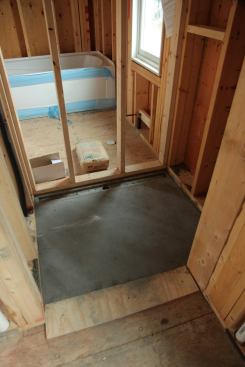

Because the floor for a linear drain requires a single sloping plane instead of the curved shape needed for a center drain, linear drains can make fabrication of a shower faster and easier. In curbed showers, the linear drain can be located against the curb or along any of the shower walls. For curbless showers, the simplest configuration locates the linear drain at the transition from the bathroom to the shower, allowing the drainage slope to be built directly on top of the subflooring. But with appropriate construction, a linear drain in a curbless shower can also be positioned against the wall opposite the bathroom floor. With proper methods and accessories, two or more linear drains can be joined to create a long continuous drain or an L-shaped one along two walls that meet in a corner. For best results, all linear drains should extend the full length of a shower wall; for longer lengths, some linear drains are available with two or more drainage holes to increase their drainage capacity.

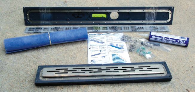

FreeStyle Linear Drain

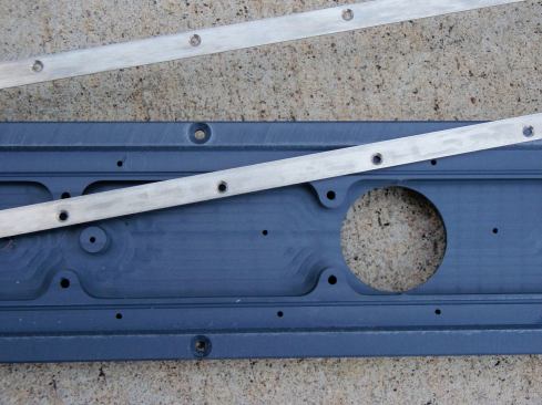

The Noble Co.’s FreeStyle linear drain kit includes the drain body, membrane flashing, a cartridge of sealant that’s compatible with the flashing, a drain grate, and hardware. Drains come in lengths from 24 inches to 60 inches; custom lengths are available in quantities of 50 or more. There are four stainless grate designs that can be ordered with the kit, along with a tile-top strainer that allows ceramic or stone tile to replace the standard stainless steel grate. The drain body (or trough that collects the waste water) connects directly to ABS or PVC waste lines and can be joined to two or more additional drains. Versions are available with center or off-center drain outlets.
The FreeStyle drain is designed to be used with its companion surface-applied sheet membrane (NobleSeal TS); however, with an adapter kit, the drain can also be used on mortar-bed installations. The FreeStyle drain can be installed directly on top of a code-compliant plywood subflooring or concrete slab, or it can be recessed into a concrete slab, which would entail blocking the drain up (for a pour) or chiseling out the concrete in an existing slab. The drain can also be installed flush with a plywood floor in a slot cut into the subflooring, but this scenario would require supplemental framing to tie the floor together and fully support the drain.
The FreeStyle drain’s clamping ring secures the drain to the membrane flashing (included in the installation kit), which is then joined to the main membrane with the kit’s sealant. The clamping ring can also secure the drain directly to a continuous membrane that covers the entire floor of the shower.
Both the printed and online instructions for the FreeStyle Linear Drain are clear and to the point. Particularly helpful for a first-time user is an online installation sequence animation that gives an easy-to-understand overview of the drain, membrane, and tile installation process for the FreeStyle drain system.

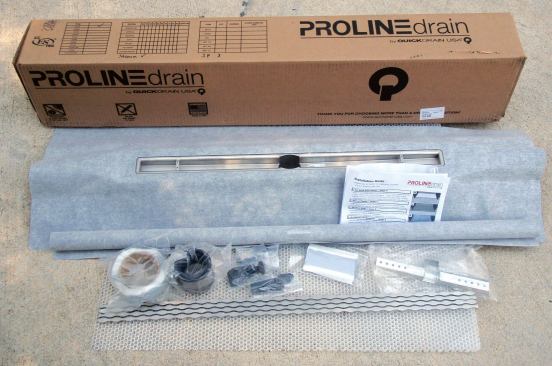

PROLINE Drain

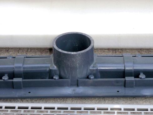

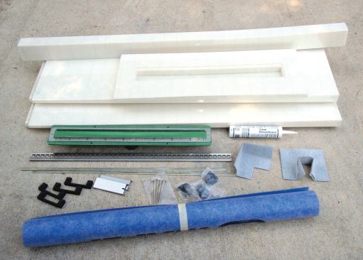

The ProLine linear drain system by QuickDrain USA consists of a variety of drain bodies, connectors, strainers, and other components that let you use the system with both wood subflooring and concrete slabs. ProLine offers standard length options from 18 inches to 68 inches, with custom lengths available up to 100 inches. Nine strainer styles, including a tile-top option, are available.
Connection to the waste line is through a hubless connector; for increased capacity, ProLine offers drain bodies with two or three drain outlets. Connectors are also available for multiple-drain installations. The drain outlet for the ProLine Drain is available centered or off-center. ProLine has an extensive array of other auxiliary components, including flat panel supports, sloping panels, and pre-formed curb sections.

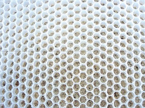

The hardware included in the kit can be used to install the ProLine linear drain on any floor surface, thin-bed, or thick mortar bed. The company’s flat panels and sloping panels are made out of an innovative honeycomb material and bond to the plywood or concrete subflooring (and to each other) with thinset mortar, which also fills the individual honeycomb cells for increased compressive strength.
A section of membrane flashing (that comes from the factory already bonded to the flange of the drain body) is then joined to the main membrane with the system’s adhesive tape. Inside and outside corners as well as curb covers complement the system’s sheet membrane system.
The company’s website contains instructions and drawings for a wide range of drain positioning: for either curbless or curbed showers; for drains mounted in the front, rear, or side of the shower; and for installations over plywood subflooring or concrete. The list of instructions and illustrations is rather lengthy and a bit daunting for the installer to get through, but the ProLine system appears to have all the bases covered.

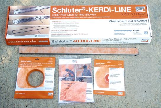

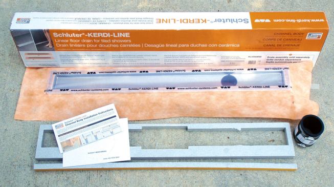

Manufactured by Schluter, the Kerdi-Line system’s drain body (called the channel body) and grate assembly are sold separately. The Kerdi-Line system is designed to work with Schluter’s Kerdi or Ditra sheet membranes, waterproofed backerboard, and shower trays, as well as with the company’s line of tile-finishing profiles. Depending on the style you choose, Kerdi-Line drains are available in lengths from 20 inches to 72 inches with either centered or off-center drain outlets that connect to the waste line by a hubless connector. The company offers three grate options—a perforated stainless-steel strainer, a solid stainless steel cover, and a tile-top strainer. To complement its system, Schluter also makes expanded-foam curb sections, sloped waterproof panels, and membrane-covered backerboard.
Product brochures and online brochures provide descriptions of the Kerdi-Line products along with some illustrations. These brochures are detailed, but for the best version of Schluter’s installation instructions, visit the Kerdi-Line website and watch the videos there.

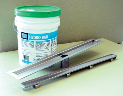

Hydro Ban Linear Drain

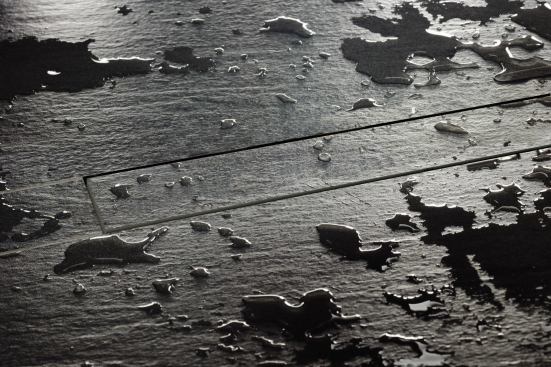

Manufactured by Laticrete International, the Hydro Ban linear drain system is available in six lengths, from 24 inches up to 60 inches. The company offers three stainless steel grate options—brushed bronze, polished bronze, and oil-rubbed bronze—in addition to a tile-top strainer option. The Hydro Ban drain body is available with a standard vertical drain outlet or with a horizontal drain outlet that exits the drain body at 90 degrees. Two or more drain bodies can be connected for applications longer than 60 inches. Connection to the waste line is by hubless connector. The drain body connects to the membrane section using Hydro Ban Waterproofing/Anti-Fracture Fabric that bridges between the setting bed and drain body. The fabric then embeds in Hydro Ban liquid membrane. The Hydro Ban drain can be installed over plywood subflooring or concrete slabs, for showers with or without a curb.
The Hydro Ban Linear Drain system is rather simple in that it comprises a drain body and a strainer. Each grate strainer has four adjustable feet for positioning it to sit 1/16 inch below the surface of the finished tile for optimal drainage. The drain body is simply positioned in the mortar bed, which is required to provide a slope of 1/4 inch per foot to the drain. Once the properly sloped mortar bed has been installed and allowed to dry, and backerboard has been attached to the shower walls, Hydro Ban liquid membrane is applied to the walls, floor, and drain body flange (and to the mortar bed curb, if one is incorporated in the design) to make the installation waterproof.
The online installation instructions for Laticrete’s Hydro Ban Linear Drain system are concise and easy to understand. With my experience installing tile, applying liquid-applied membrane systems, and reading blueprints, I got the gist of how to install the Laticrete system from the four drawings found in the five-page brochure. These four drawings condense the complete details onto just two pages.
