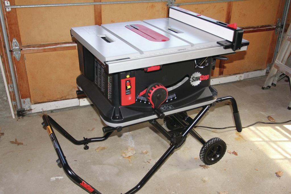

Though the JSS-MCA jobsite table saw from SawStop is compact, the table can be extended to a full 25 1/2-inch rip capacity.

There's plenty of on-board storage for the fence, push stick (included), wrenches, and more.

The saw has great on-board storage for the fence, push stick (included), wrenches, and other accessories (see photo, left). The table extends for a full 25 1/2-inch rip capacity, and the blade and removable guard raise and lower easily with a single turn of the wheel. Tilting the blade is just as quick, and there’s a micro-adjust for dialing the angle in precisely. In use, it’s not as quiet as a cabinet saw, but the 1 1/2-hp motor and standard blade cut cleanly through 2-by framing and some sturdy 5/4 yellow birch I had lying around. The fence worked smoothly and locked in place securely, and the scale and indicator were accurate (though I couldn’t figure out if the indicator was adjustable).
