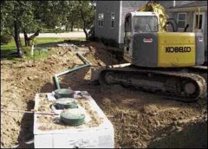

CONVENTIONAL SEPTIC SYSTEMS
A standard septic tank (top) and leach field (bottom) rely on lots of land and lots of aerated soil to adequately purify a home’s wastewater. Neither land nor such soil is available in many coastal communities, which is driving more municipalities to alternative systems.
