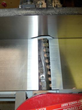

Flattening and surfacing boards takes some specialized equipment. We use an 8-inch-wide jointer as well as a pair of thickness planers to surface our stock. All of our machines are equipped with Byrd Shelix spiral cutter heads that have indexed carbide cutters.
While they’re more expensive than traditional cutter heads, we’ve found them to be a worthwhile investment for our operation. These professional-grade cutting heads all but eliminate chip-out and tear-out (on even the hardest woods), while reducing the number of time-consuming blade changes. And the machines run quieter with these heads.

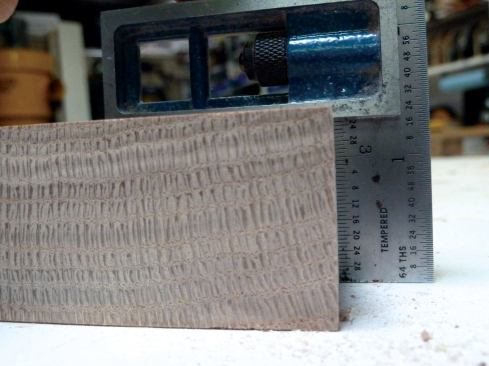

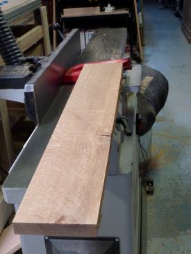

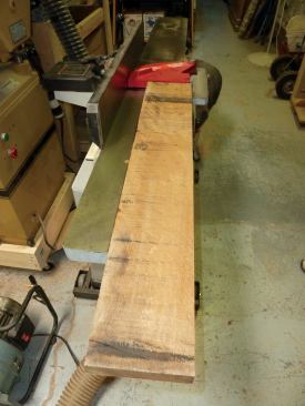

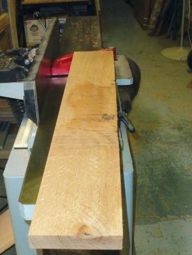

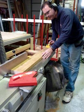

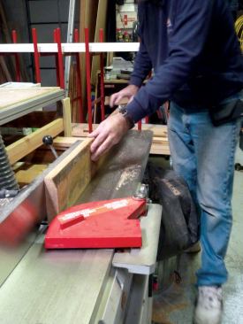

We begin by flattening one face of the material, to get it ready for thicknessing. We feed the boards face down across the blade of the jointer, letting the edge of the board ride against the jointer fence. We take care to “read” the direction of the grain as the boards pass over the jointer knives. Because the top of the cutter head on the jointer rotates toward the operator, the direction of the grain along the edge of the board should angle down and away from the operator to prevent chipping or tearing out.
We make several passes on the jointer, taking off a small amount of wood at a time. With each pass, the rough areas become smaller until all roughness is eliminated and the face is completely flat. As a last step on the jointer, we smooth the ripped edge of the board, which establishes a straight edge that’s 90 degrees to the face we just flattened and that can be run against the table saw’s rip fence. At this point we can finally see the color and figure on the face as well as on the edge of the board.

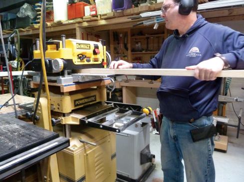

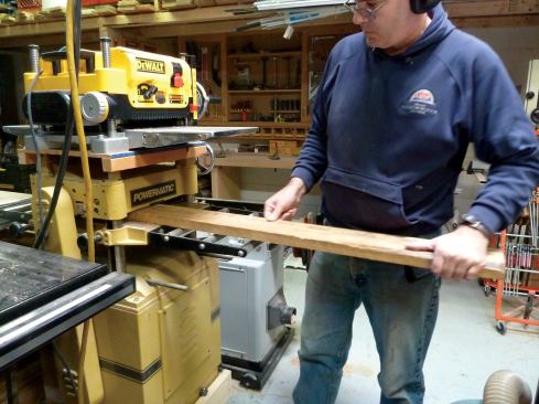

From the jointer, we run the boards through the first of two thickness planers that smooth and flatten the other face of the board. We make the initial passes on a large, powerful stationary Powermatic planer that hogs material off quickly and easily.

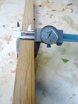

We feed each board into the planer with the flattened face placed face down on the planer bed. We make several passes to remove material from the remaining rough face until that side is smooth and parallel to the first side. Next we run the board through a DeWalt planer, which is less powerful but makes a finer cut. We alternate passes on each face until we achieve the desired thickness.
We mark the best face of each board with chalk so that side is used where it is most visible. Then we either cut the material into components for the project or sticker it in the racks for future use.
