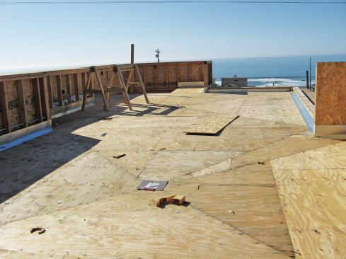

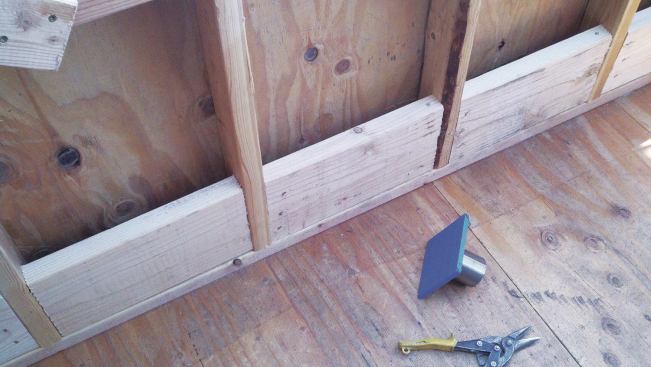

Blocking. Because the framing will be sheathed rather than covered with decking, blocking needs to be installed to support all plywood edges. This includes not only where panels meet in the field, but also at the deck-to-wall edges. Blocking can be 2x4s or 2x6s turned on their sides to provide plenty of room for the panel to be nailed or screwed to.
Blocking is also required in the wall stud bays around the deck’s perimeter to provide solid backing for L-flashing. Some builders nail off the flashing into the studs every 16 inches on-center, but adding blocking is a best practice that allows the flashing to be nailed as needed to eliminate deflection of the metal-flashing termination points. When there is a sheathed shear wall to provide a nail base, additional blocking is unnecessary.
Slope. To provide the required 1/4-inch-per-foot slope for drainage, joists can be ripped prior to installation, or tapered rip strips can be glued and nailed onto the tops of flat joists. I prefer to see rip strips, because that means that the strength of the joists hasn’t been compromised. On the other hand, sawn tapered joists may be necessary to preserve height differences between interior and exterior floor levels, in which case I again recommend installing the joists 10 inches or 12 inches, rather than 16 inches, on-center.

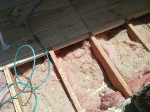

As far as I know, OSB is not approved by any manufacturer as a suitable substrate for deck waterproofing systems. To meet Class A and one-hour fire-resistant-construction requirements, APA-rated plywood must be used. The coating to be applied will dictate the specific type of plywood. For example, vinyl and urethane coverings require smooth sanded panels devoid of defects, while Exterior Grade Exposure 1 panels can be used for the cementitious coatings that are popular in California, where I live.
The minimum substrate thickness allowed by most manufacturers is 5/8 inch, but I find that to be insufficient. I weigh 200 pounds, and I can feel 5/8-inch plywood deflect when I stand between joists installed 16 inches on-center.
Since there’s less deflection with thicker plywood, I prefer to use 1 1/8-inch-thick plywood sheathing, but I’ll settle for a minimum of 3/4-inch plywood if necessary. In my area, 3/4-inch-thick Exterior Grade Exposure 1 panels cost about $29, while 1 1/8-inch panels cost about $44. Plugged and sanded panels for vinyl and urethane coatings cost a bit more.

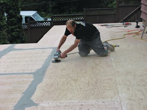

How the plywood is installed is important. Panels must be gapped 1/8 inch so they can expand and contract without damaging the coating. They should always be glued down with a full bead of construction adhesive on every joist prior to being fastened to the framing with screws or ring-shank nails. Fasteners should be spaced as recommended by the APA, typically every 3 to 4 inches apart at the edges and 6 to 8 inches apart in the field (for more on plywood installation, handling, and storage, see apawood.org).

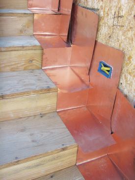

Stair treads. When we walk up and down stairs, our body weight is concentrated on one leg at a time. Since treads are subject to these concentrated loads, I provide blocking between the stringers before installing the plywood, to prevent deflection. Another way to provide more support to the treads and reduce deflection is to install additional stringers.

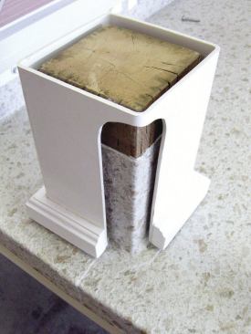

Most water intrusion damage I see occurs around rail posts. Anything that penetrates a deck coating is a leak waiting to happen, so it’s best to mount rail posts to the outside edge of a deck through the fascia or siding and support them inside the framing.
If that’s not possible, then the goal is to prevent leaks. Some builders simply kerf-cut their 4×4 posts to accommodate let-in flashing, but wood posts will check and split as they weather and almost inevitably leak. So whenever wood posts penetrate any deck we’re working on, we flash them with metal L-flashing that can be waterproofed with the deck coating. Later, the posts can be wrapped in weather-resistant Tyvek or 60-minute building paper, then boxed in with wood or plastic post sleeves.
Unfortunately, there’s no practical way to lap materials up a deck-mounted metal rail post. All posts move a bit, and lapped coatings aren’t flexible enough to allow that movement without cracking, which eventually will lead to leakage. So when customers want a deck-mounted metal railing, the only option is to set the metal post bases on top of the coating after it’s been installed. First, though, I have the customers sign our waiver acknowledging that we offer no guarantee against leaking.
We fill the drilled lag bolt holes for the railing posts with a polyurethane sealant such as Sikaflex 1A (usa.sika.com). Prior to setting each post, I also squirt a fat bead of the same sealant around the bolt holes, so that the post bases are bedded in sealant when the rails are installed. After tightening the lag bolts, I wipe off the sealant that squeezes out of the bolt holes and from under the post bases. I use the same procedure for wall connections.
It’s critical to inspect the metal rail annually, tightening fasteners as necessary and caulking and painting as needed. With good maintenance and a bit of luck, there won’t be any leaks.

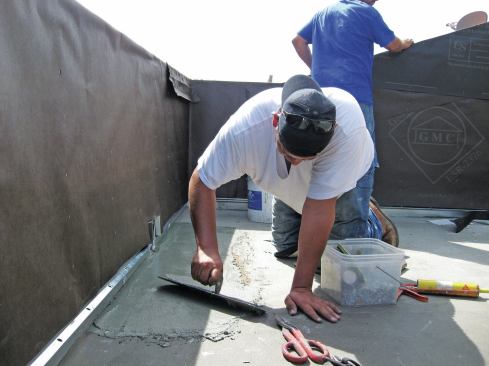

At this point, the deck is almost ready for its waterproof coating. Since most coatings extend up the vertical legs of the flashing, the flashing and waterproofing needs to be applied before walls are wrapped with a water-resistive barrier (WRB), and doors and siding are installed. In retrofit construction, we specify the removal of some doors and siding prior to coating installation.

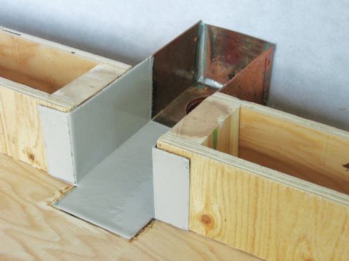

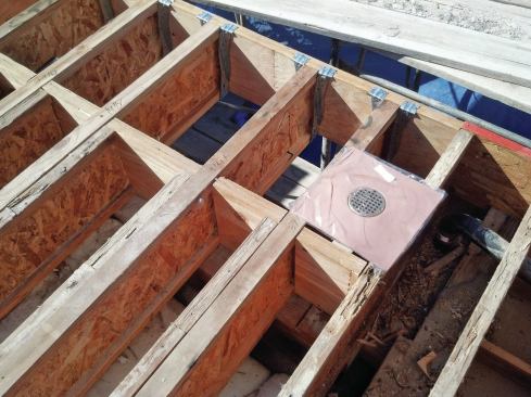

Drains. Where drains are required, we install Thunderbird Products deck drains (thunderbirdproducts.com), which are top-quality and specifically designed for walking decks. They’re available with bonderized steel (galvanized steel that has been phosphate-cleaned to remove oils and improve coating adhesion), copper, or stainless steel flanges, so they can be used with a number of different systems and in a variety of environments. Some jurisdictions require secondary overflows when a deck is enclosed by walls.

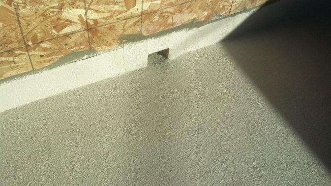

Scuppers. If the deck has a parapet wall, scuppers can be used to drain the deck. When we set them in a wall, we also include an exterior-side counterflashing sleeve that slides over the tube to prevent water from running back into the wall. Like drains, scuppers must be properly sized and located, as well as isolated from dissimilar metals (stainless steel nails can be safely used with copper, but not with galvanized steel).
Crickets should always be installed between scuppers to help water drain to the openings rather than pool along the wall. Crickets can be framed, but are more often formed with polymer concrete from the roof-coating manufacturer. In some cases, crickets can be formed while the waterproof coating is applied.
Flashing. Our drains and scuppers come from a specialty sheet-metal shop, which also supplies our copper or galvanized steel flashing. They all have to be compatible with the specific waterproof covering that we’re installing.
Most of the time, we install 26-gauge bonderized steel L-flashing with a 4-inch horizontal leg and a 6-inch vertical leg. We lap pieces 3 to 4 inches, embedding the joints in polyurethane sealant. When we’re working with copper, we use 16-ounce (minimum) material and usually solder the joints.
Door pans are a must, since door leaks are often misdiagnosed as “deck leaks.” We require metal pans that have a lip on the back edge of the horizontal leg to prevent water intrusion under the threshold.

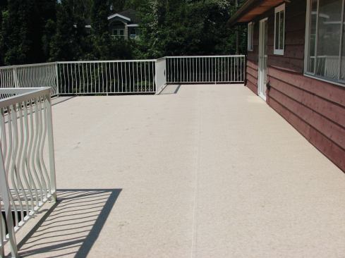

Waterproofing
Some deck waterproofing systems are sold over the counter to the general public, but most are available only from factory-trained applicators. My philosophy is simple: You can hire a contractor who is well-versed in deck waterproofing, or you can assume all the risk of choosing a system, figuring out the details, and installing it yourself.

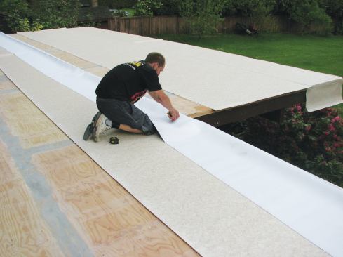

Vinyl coverings. Many deck builders are already familiar with vinyl coverings such as Duradek (see “Waterproofing a Rooftop Deck,” JLC, September 2008, jlconline.com). These systems have specific edge-finishing and flashing details and require that voids and seams in the plywood be treated with a patching compound.

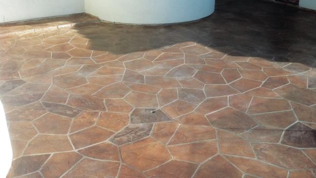

Cementitious coatings. Our preferred waterproofing system is Desert Crete, a multilayer cementitious coating applied over metal lath. [You can read more about a Desert Crete installation in “Dry Deck Over Living Space,” JLC, March 2010, jlconline.com.] Over the past 12 years, we’ve successfully installed hundreds of thousands of square feet of it. One of the advantages of this coating is that it can be finished with a spray-on texture or with various stamped concrete patterns, which can then be stained to mimic stone or tile.
The cement-based Desert Crete system is nearly impervious to UV light and requires little maintenance. I instruct my clients to inspect their decks every six months or so for possible problems and repaint as needed every three to five years, though some decks that I’ve installed have never been repainted.
