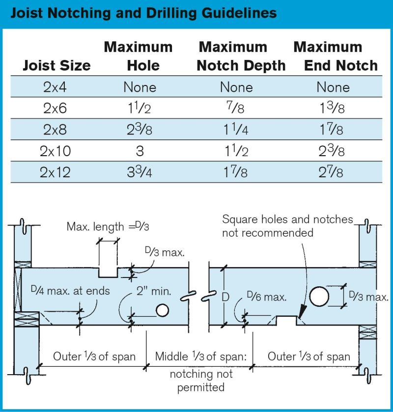

When you’re building a deck, it’s sometimes necessary to drill holes or cut notches in the framing for routing electrical cables or for installing gas piping. Because holes and notches can significantly weaken wood structural members, the IRC provides guidelines for making these onsite modifications, at least for sawn joists (see R502.8, 2012 IRC).

Notching. Notching involves the removal of material at the top and bottom of the joist, where compression and tension forces are working to resist bending (that is, deflection). Since bending forces increase toward the center of a beam and are greatest in the middle third of a span, the IRC prohibits any notches there (see “Joist Notching and Drilling Guidelines,” above). If you’re considering laterally bracing the plane of a deck (a common wall-framing practice in the past, when they were sheathed with boards rather than structural panels, and still provided for in the IRC), this means you can’t let the bracing into the joists in the middle third of their span.
A joist can be notched at bearing locations at either the top or bottom without reducing its structural capability, as long as the notch doesn’t exceed one-fourth the depth of the joist. This means that a 2×10 can be notched at bearing to the height of a 2×8, yet still get span credit for being a 2×10. This allowance provides useful design flexibility; for example, when two different-sized joists bear at the same elevation and still must be flush on the top.
Notches can also be located anywhere along the top and bottom edges of the joist, as long as the notches are in the outer thirds of the span. These notches can’t be deeper than one-sixth the depth of the joist, nor longer than one-third the depth of the joist. In a 2×8 joist, for example, notches can be 1 1/4 inches deep, which should allow for recessed gas piping. Unlike electrical cable, gas pipe is rigid, and design restraints may preclude sliding the pipe through a series of drilled holes from outside the deck. Notches allow the pipe to be raised vertically into place.
When cutting notches in the bottom of a joist, try to make angled rather than vertical cuts, which will reduce the likelihood of splitting. Also, remember that with some pressure-treated material it may be a requirement of the AWPA standard M4, a required referenced standard of the IRC, for the exposed material in the cut to be field-treated. When not required, it’s still good practice (see Decay Resistance and the Code, May 2014, PDB).
Drilling. There are two limitations to drilling holes in joists. To avoid reducing a joist’s bending resistance, no holes can be closer than 2 inches from the top or bottom edges of the joist. In addition, the diameter of a hole is limited to one-third the depth of the material. In a 2×8, for example, the maximum hole diameter is 2 3/8 inches (actual rather than nominal dimensions should be used to make these calculations).
Note that while rule #2 allows a 1 1/2-inch hole in a 2×6, this hole wouldn’t meet the 2-inch edge-clearance requirement of rule #1. Of course, in most deck applications, holes larger than what would be required for electrical wiring or gas piping are not common, so the maximum diameter usually isn’t a problem. The edge distance, however, often is. For example, when joists are 12 inches on-center, ill-equipped carpenters who don’t have a drill that will fit between the joists will end up drilling holes closer to the bottom edge than allowed. The IRC provides no alternative fix for holes less than 2 inches from the edge of a joist, and while an engineer might be able to come up with a solution, it will probably cost far more than a new right-angle drill would.
In the event that a single joist needs to be notched or drilled in more than one spot along its length, the distance between the holes or notches should be greater than twice the diameter of the largest opening. In the less-common event that engineered lumber approved for outdoor use is installed, refer to the manufacturer for drilling and notching limitations. Generally, I-joists’ top and bottom chords cannot be notched to any degree, while holes in the center webs can be nearly chord to chord, certainly much larger than one-third the depth of the joist.
