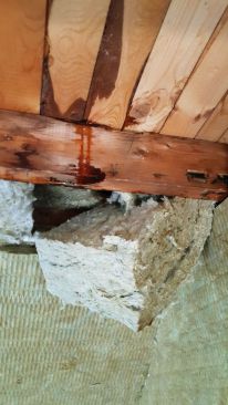

So we went ahead with upgrading the walls in the home office space. The plan was to reinsulate the walls with Roxul cavity insulation and some additional rigid Roxul on the inside face of the wall, apply Intello smart vapor retarder, install Passive House–rated windows, and re-drywall the walls. But when we opened up the walls and a section of ceiling during the job, we found another moisture problem: There was frost on the underside of the roof sheathing.
When we returned the next day, expecting the frost to be gone, we found instead a steady seeping of water between the joints in the matched-board roof sheathing. At first glance, the roof appeared to have a leak.

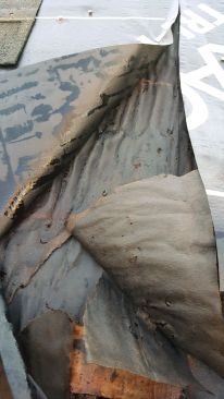

The roof shingles were good-quality IKO shingles, installed only two years previously. As we inspected the roof from the outside, we found an unusual bulge in the shingles. We removed some roofing at that location to see what we could learn. But to our surprise, the nearly new Grace Tri-Flex synthetic underlayment under the shingles was bone-dry.

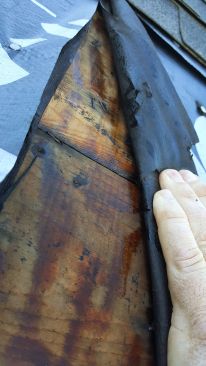

When we sliced open and peeled back the synthetic underlayment, we found a different situation. The asphalt felt paper under the Tri-Flex, left in place during the most recent reroof, was wet. And when we slit the asphalt felt and pulled it back, we found roof boards that were soaking wet.
Evidently, the source of the dripping water was not a roof leak, but condensation of interior moisture under the vapor-impermeable Tri-Flex underlayment.

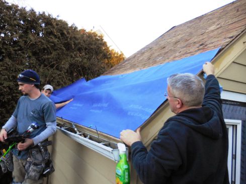

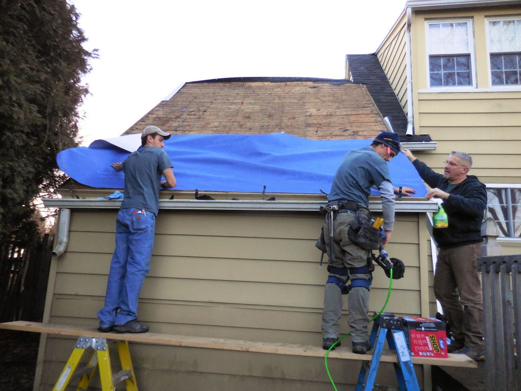

After stripping away the almost-new existing roof shingles, we applied Siga Majvest membrane to the roof. With a perm rating of 68, this fabric would allow good drying.
The author and his crew spread Majvest weather barrier membrane over the original board sheathing of the roof. With a U.S. perm rating of 68, Majvest is vapor open, but it resists driving rain.

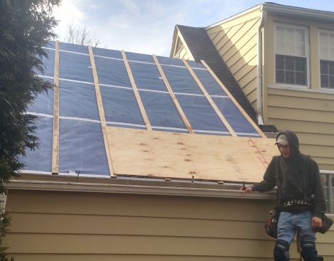

Over the membrane, we attached 3/4-inch strapping, run vertically, to create an air space for convective drying. This 3/4-inch air space is about the least we like to use—a full inch or even 1 1/2 inches would be better. But a 3/4-inch space is enough to do the job, and using anything larger in this case would have introduced problems for trim and roof intersections. Even at 3/4 inch, we had to install a new fascia of Boral mineral-based trim to hide the raised roof plane.
Over the strapping, we applied another layer of sheathing, using plywood rather than OSB because of plywood’s better resistance to moisture attack. We installed insect screens at the bottom of the roof and a regular ridge vent at the top.

The crew installs plywood roof sheathing over 3/4-inch wood strapping as a nailbase for asphalt shingles. This creates an air space that will allow moisture diffusing out of the cathedral roof to escape the assembly through convection.
Jonah Vannamee
