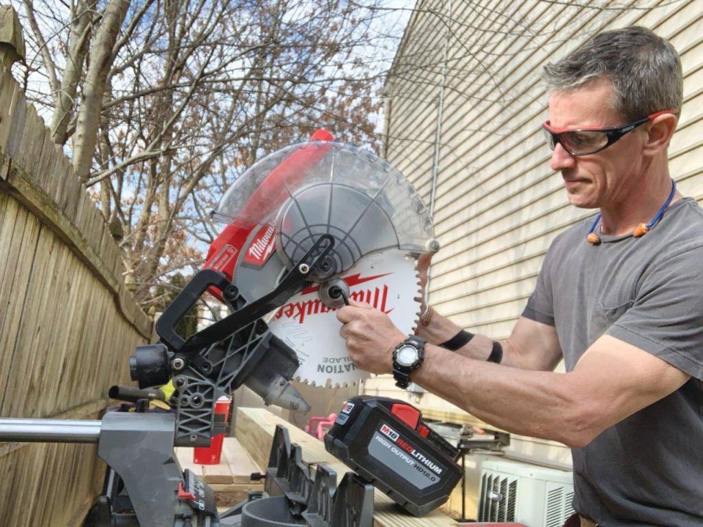

My work runs the gamut from trim, decks, and light framing to maintenance and service work, and a miter saw is usually at the center of my operations. My measure of a “good” saw is one that can stand tall all over the place, whether I’m setting up a cutting station for trimming out a room or lugging the saw into a backyard for a quick service call setup. Milwaukee’s new M18 Fuel dual bevel 12-inch sliding compound miter saw fits that definition, and then some.
I’ve been using this big saw for a couple of months on all kinds of jobs, giving me an opportunity to become familiar with the saw’s bevel adjustments, blade guard and LED blade light, and battery exchange. I looked at dust collection; I checked the saw’s accuracy; I changed blades, not only to see how well the saw cuts with different blades, but to see how easy—or hard—the blade-change operation is.

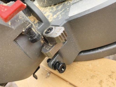

After pulling the saw out of the box (I tested the kit version, or 2739-21HD, which includes a battery, charger, bag, and blade) and cutting away the packaging (no assembly required), I found that it wasn’t just accurate; it was sublimely accurate. And while I didn’t cut crown on the flat, the bevel detent tabs are dead-on and easily deployed. I’ve had saws that required launching an investigation to tune them up—and even then they were finicky. Milwaukee’s screws and tabs are easy to see and operate, and intuitive to tune up, if needed.

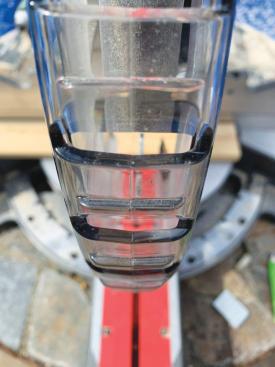

Precise cuts are easy, thanks to the visibility offered by the louvered blade guard.
The 22.5-degree and 33.9-degree bevel detents can be fine-tuned for accuracy.
The adjustments are excellent. Detents are solid and positive; handles don’t stick; and overriding a detent is a snap. The pointers are big, keenly visible, and sharp. They point; they don’t suggest.

I’ve been in the 10-inch-miter-saw universe a few years, all the while ruing the day I let my previous 12-inch saw go. The Milwaukee’s 12-inch size alone was refreshing enough simply cutting 5 1/2-inch ogee base nested. But the fact that the blade housing is notched to cut up to 6 3/4-inch vertical stock (7 1/2-inch nested crown) is gold-standard good. Mickey, the legendary trainer in the movie “Rocky,” says (yells) something about something that “weakens legs.” Tipping a 10-inch SCMS and cutting basic trim flat “slows cutting” just as dramatically, in my opinion.
Whether cutting southern yellow pine PT decking, 2-by framing, or finger-jointed and primed trim, the blade delivered little to no tear-out and glass-smooth end grain. The saw started smoothly and ran with a pleasant hum. After the cut, the electric brake eased the blade to a safe, smooth stop, a nice feature in a big saw like this.

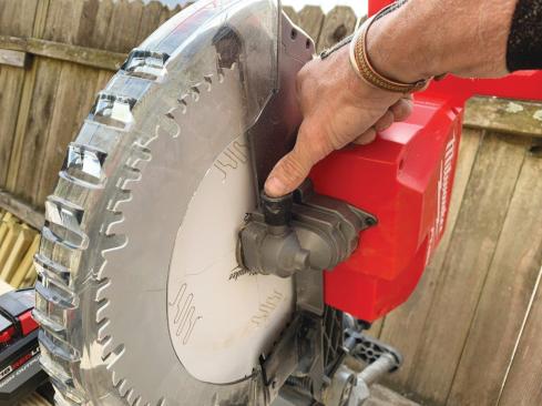

Blade change. The guard rolls up high on the blade housing, exposing the arbor for easy blade changes. The saw has an easily-accessible push-in spindle lock and a hex wrench for tightening and loosening the blade bolt.
The blade guard rolls up and out of the way for access to the arbor during blade changes. There’s a push-button spindle lock on the right-hand side of the blade.

Guard and blade light. The guard is clear plastic and—thank you—louvered. It took a little practice to locate the louvers, but they’re there and they’re great for sighting the blade precisely at the cut line. Additionally, the Shadow Cut Line LED light is both terrific and accurate, though I used the saw for a week before figuring out there’s also a switch to turn it on without engaging the blade.
