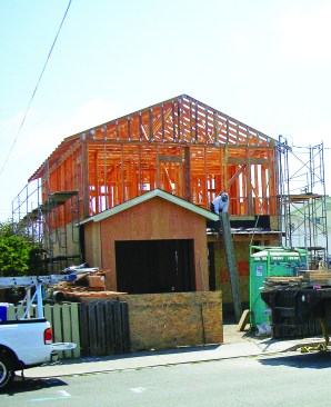

The crane lightened the burden, but still the author had to rig the bundles of lumber on the ground and climb the scaffold to guide them into place.

Are you having trouble capturing all the General Requirements in your estimates? Here’s a way to sharpen your awareness of them. When you notice someone else’s job, pull over and scan the site. See how many GRs you can spot. Meanwhile, try scanning the site shown above for General Requirement items. I see five, listed below.They are: Portable Toilet. Scaffolding. Recycling. Temporary Power. Gate. And there are arguably two or three more that are at least implied.
