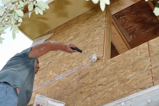

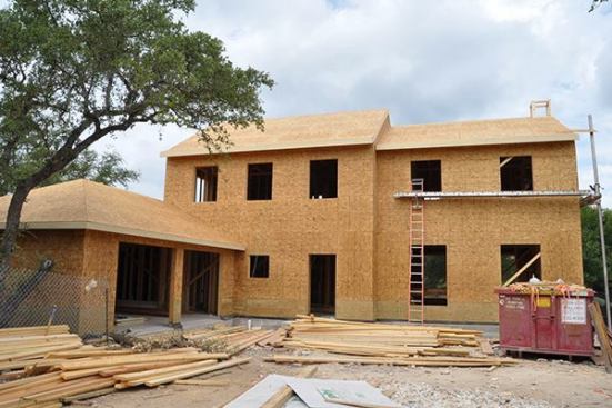

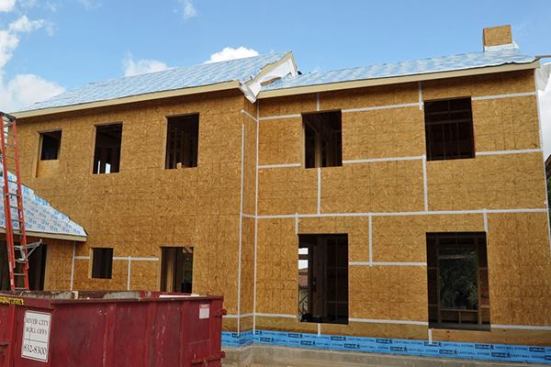

So, in my quest to build ever tighter houses I’ve decided that my goal is for every house I build to get as close to 1ACH50 as possible. Not every house I build will get to this standard as I’m sometimes limited by the Architecture on the weather-stripping of exterior doors. I’ve found that sliding glass doors, custom doors, “store front”, and other Architecturally cool doors can really kill my blower door tests.

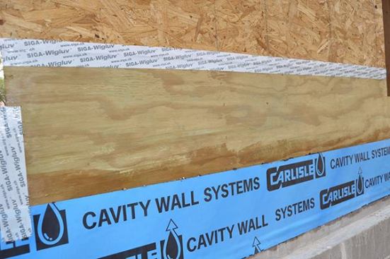

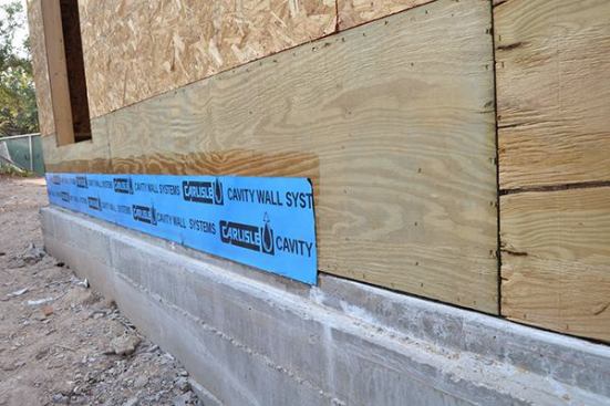

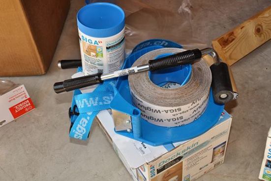

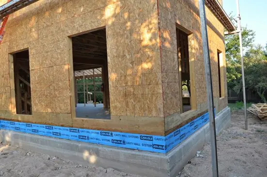

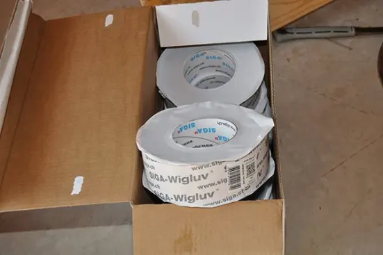

If you’ve followed my blog, I’ve used a ton of different methods to air seal inside a house. Spray foam, Owens Corning Energy Complete, Caulking, etc. Using these methods I’ve been able to get most houses below 2.5ACH50. But, to reach that goal of 1ACH50 I’ve decided to take a page from the PassiveHouse playbook and tape my exterior sheathing seams. In reading Martin Holiday’s “Tape Test” article from March 2013 Fine Homebuilding, I thought that Siga Wigluv was the clear winner as the best tape for OSB sheathing seams. Martin’s article says that it’s best to use a primer and I fully agree. I bought my Siga tape online from SmallPlanetWorkshop.com along with the Siga accessories. I also recommend using a J-Roller to roll out the tape and ensure good adhesion. View the slideshow for some photos of the install process.
I made two videos of the Siga Tape. This first video is my impressions and a good destructive test.
This next video is the more complete version showing the install process.

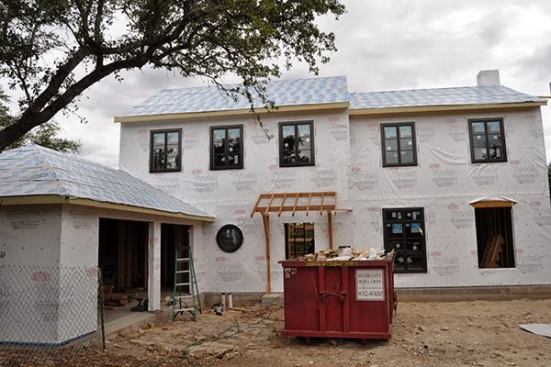

Unfortunately, I’ve been waiting on the rear and front doors for this house so I’ve not been able to perform the blower door test! I’m expecting this house to get very close to my goal of 1ACH50! I’ll post and update to this blog post once I get the results. Overall, I’m really happy with this Siga Tape and I think this method is superior from an Best Practice standpoint on that list of Control Layers.
