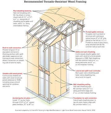

Two illustrations below show two approaches to upgrading the load path. Both will work in hurricane and tornado zones, but the “Recommended Tornado-Resistant Wood Framing” directly below) is less expensive to build and probably better suited to homes in tornado country, where the chances of a home being hit by a tornado are lower than the chances of a home in a coastal zone being hit by a hurricane.
Click to enlarge
New-construction framing. The framing recommendations shown here reflect hundreds of inspections of tornado-damaged homes by APA engineers. The engineers concluded that many homes in regions at risk of tornadoes could be saved at a reasonable cost if built with these upgrades to framing component and assembly connections.

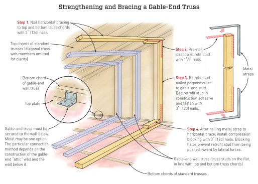

Rafters and trusses that are typically fastened in place with a few 10d or 16d toenails are easily torn apart in a high wind. Also, gable-end trusses that are toenailed into the top plates often blow out when the attic gets pressurized by high winds, leading to catastrophic failure. The framing retrofits shown here offer effective ways to strengthen these critical structural connections.

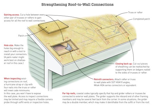

Click to enlarge
Retrofit framing. To strengthen the gable ends of existing homes in hurricane zones, each stud of a gable-end truss gets this basic retrofit assembly: Horizontal braces (each about 6 feet long) are first attached to the top and bottom chords of the roof, and then a retrofit stud is installed perpendicular to the gable-end truss. The L-straps must be preinstalled at the end of each retrofit stud before the stud is secured to the horizontal braces.
Click to enlarge
Retrofit framing. To minimize demolition of the roof edge, rectangular holes are cut into every other rafter or truss bay, and gusset angles are installed on each side of the hole. The cut-out can be saved and used to patch in the opening by securing it to scabs nailed to the side of the trusses.
